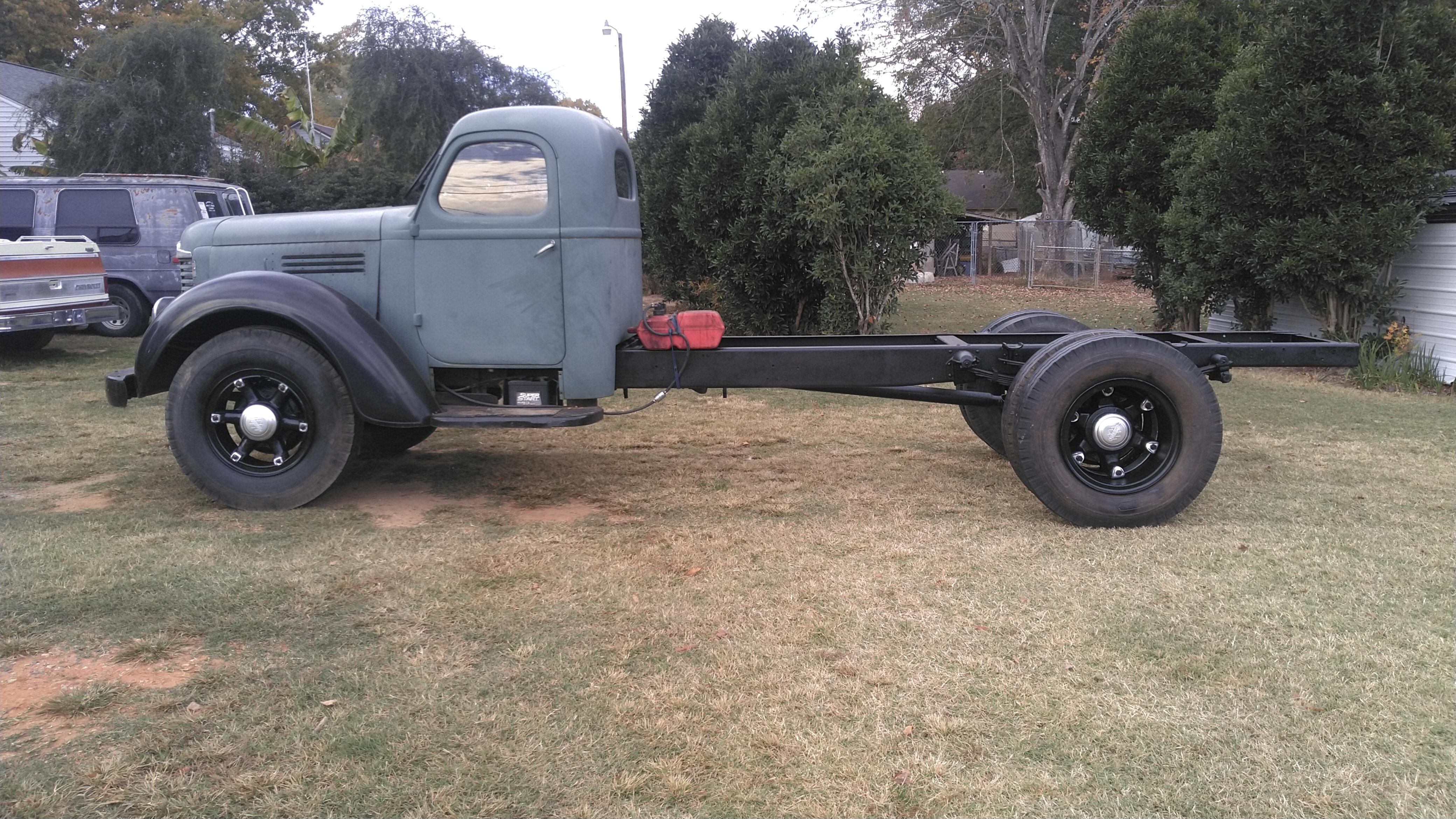

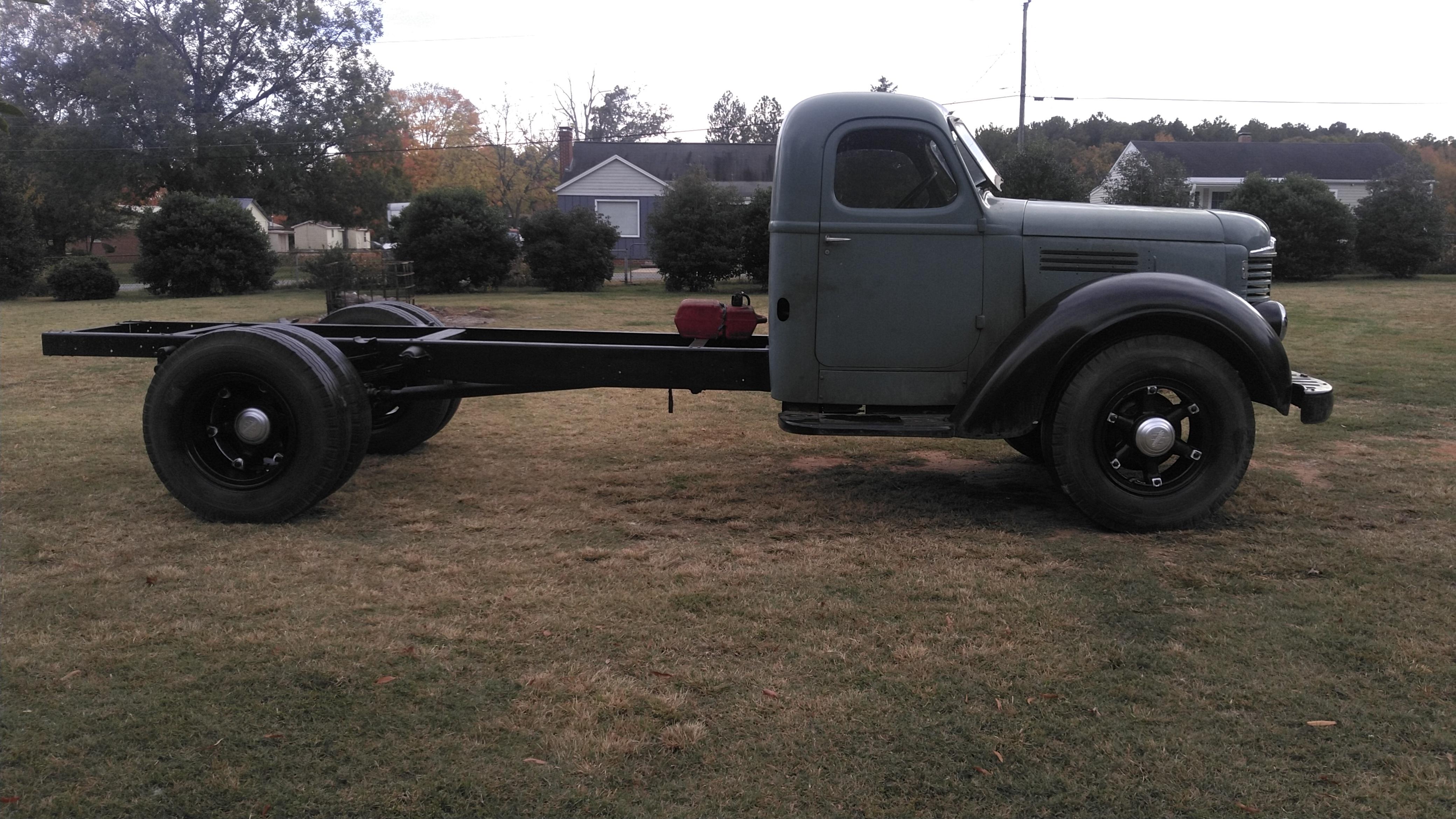

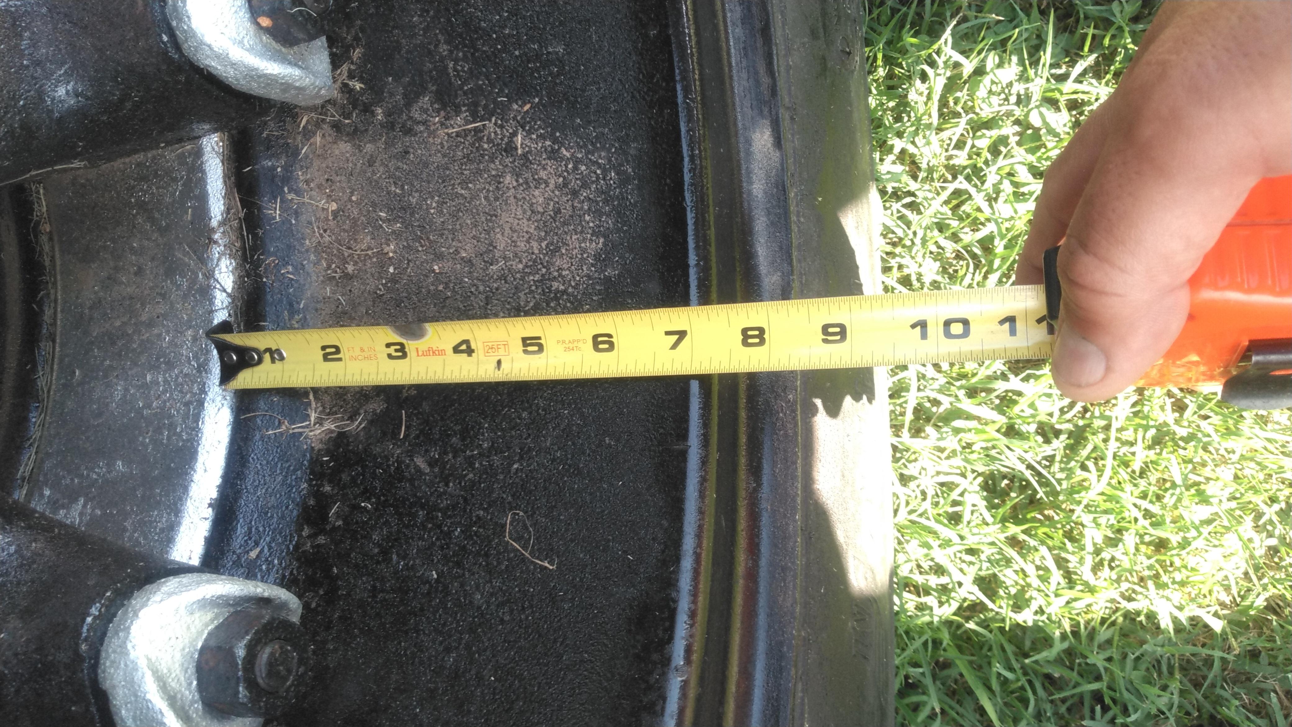

what is the rim width? I am wondering how well they would fit on the narrow (er) rim. 9.00's normally go on a 6.5 or 7" rim.  As I said my rims are stamped with the max tire size
 My truck with disk wheels has 6.5" 6 bolt wheels, the spoke are only 6", which is why they are stamped with the 8.25 tire size.
I dont remember right now..  If I get a chance later or tomorrow, i will look..  I just painted them, so not sure if I can read them.  I can go ahead and run a tape measure across..   Give me a minute,, Im gonna look now instead..
  • Haha 1
They look wider than mine, do you have any clearance problems? I once tried some wider rims and the inside rear was close to the springs, and the front to the tie rod end.  Nice you have the hubcaps. they often go missing.
The battery box cover: I don't think the trucks ever came with them, I have yet to see a truck with one on it. I had mine made.
OK, the rims seem to be 8'' wide from edge to edge... I have a battery cover for it..  this is a project truck and I have many parts in my shop..   I need a starter for it.  Im going to change it to 12v negative ground..  it runs good.. I also dont have a crank handle to start the engine either..
Those are 6.5 or 7 (it is the inside width between the rim flanges" I can tell exactly.. Wow you got the "optional cover!" every one I see it is missing.
