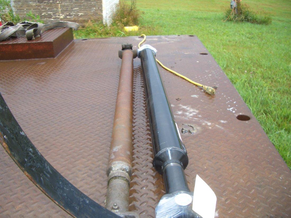

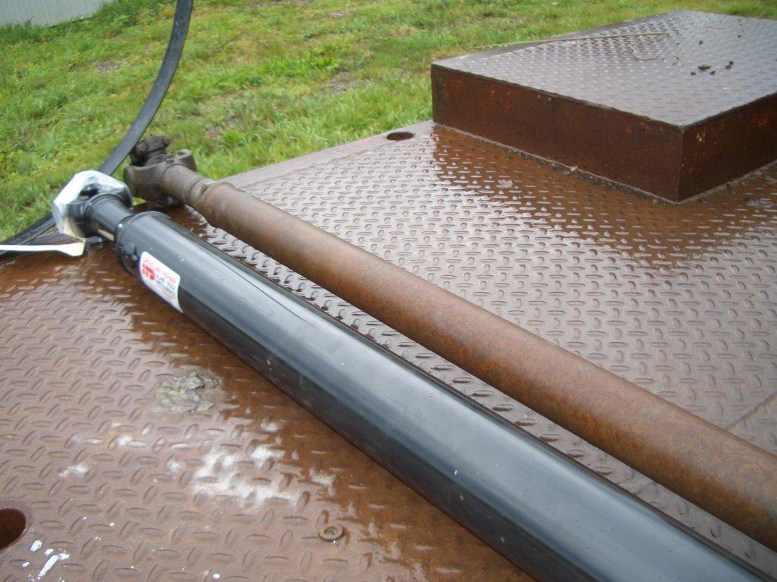

Ran to Omaha, and picked up the shaft. Rain stopped enough for a while for me to put it in. Took it 12 miles and back to put 20 gal of gas in the new tank. I think we have a winner. I can run up to gov speed in O/D and while not silky smooth it isn't trying to tear itself apart. 55-60 is good enough. Speedo doesn't work correctly at present but I was keeping up with traffic, Tach wasn't at gov speed, so likely 55 -58 without problems.
Old and new shaft. Old has the old diff and carrier bearing yokes on the ends, so that is why it looks floppy. New shaft is 3 1/3" old is 2 1/2". The bigger shaft looks none to big on a truck of this size.

So what the theory says on the crytical speed? Is it higher for fatter or heavier shaft? Or did just that "seat of pants" engineering work out well enough?
And what's up the bearing temp? Do you worry on extra stress put on it by larger shaft? Or did you just serviced it and wanted to check?
I guess shafts with cross and bearing type joints set up a standing wave at  one RPM (critical speed). The size of the shaft and the length determine when that happens. To avoid it, you can make the shaft bigger or shorten each section.. Also they found that at exactly 1/2 the critical speed you can also get a vibration so while you can pass through that speed, you don't want to run at that speed for very long.
