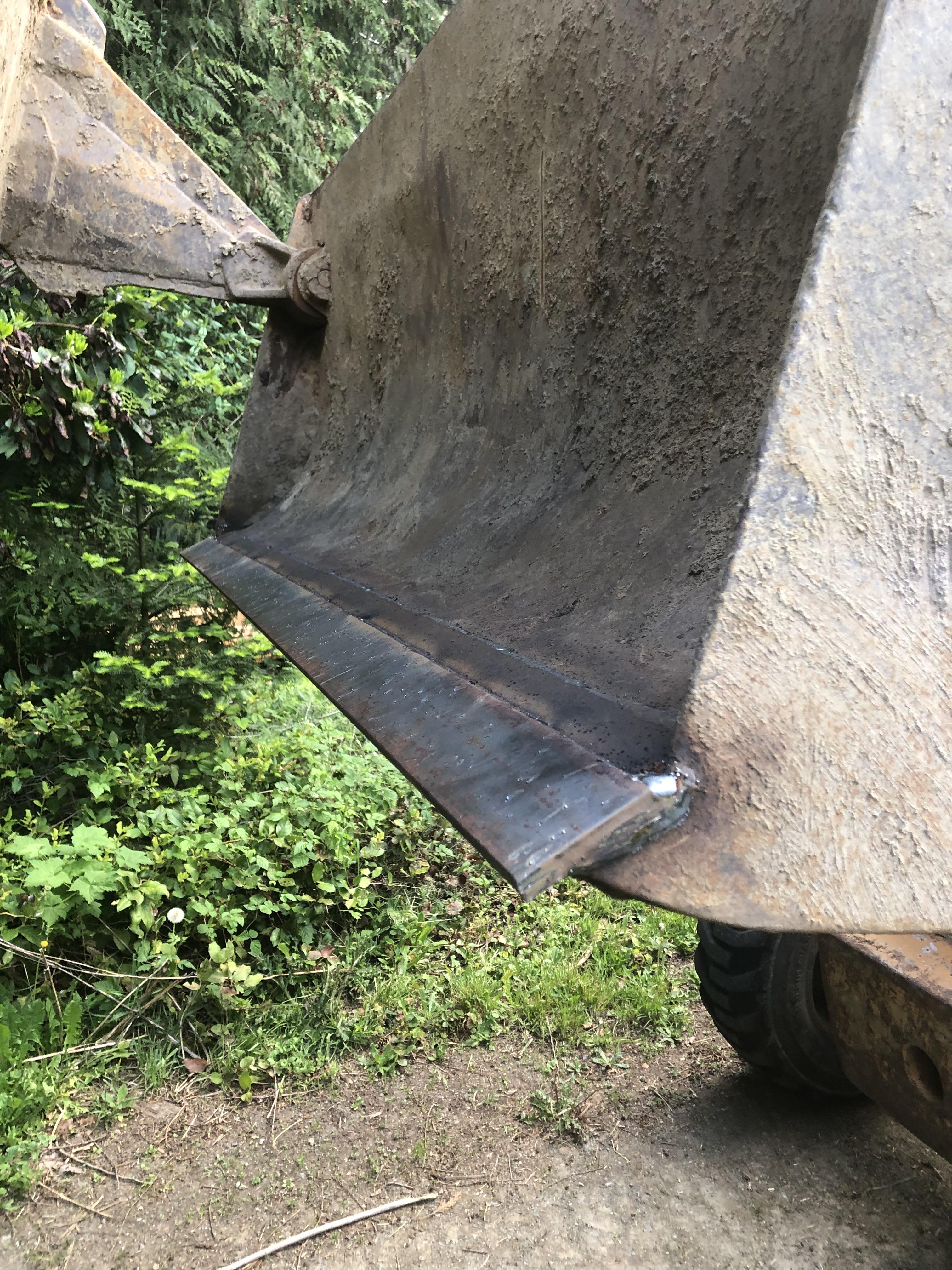

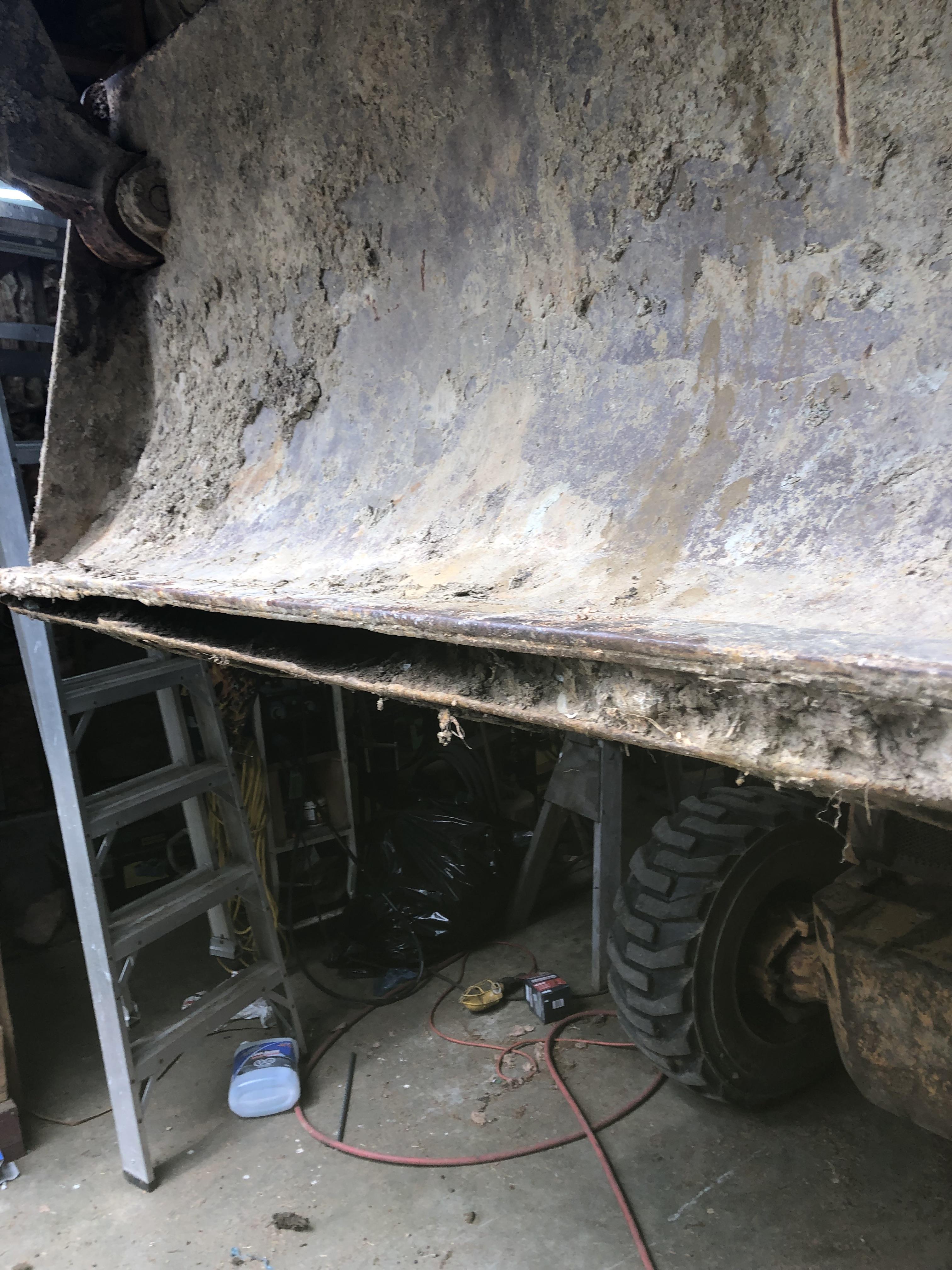

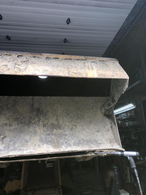

Yup I'm in the process of repairing the main part of the 4/1 cutting edge they left it un repaired for quite awhile so the clay and dirt was packed solid between the frame work and the  work edge! had to air hammer it out and pressure wash inside before I get started on the repair some one did try to bandaid it at one point! might take a couple of days to finish it up got to go get a another spool of wire for the welder And I am not planning on knocking my self out getting it done And I don't know the duty cycle on the miller Haven't had it long enough to know its capability's ! It's raining here today so nice day to be inside! 😁

Thanx Joe ! I passed on this  Machine I And got the Case as pictured! I'm just picking it up to day I decided not to take on the bucket repair as I can no longer work over my shoulders and the welding project would have put me in that situation! So I sublet the job to a small welling shop down the road he did a mighty fine job ! 700 bucks well spent didn't hurt my self one bit!  picking it up this morning before the traffic gets heavy! post pics in awhile! Next is to pull the boom cyl it has a crack that needs repaired at the anchor end that leaks when in use a bit!
Decent fix see how it holds up ! After looking at it I may have been able to work around working over my shoulders how ever its done! Still got some tiddling on the clam on the left side worn quite heavy, I may tackle  that my self at some point!

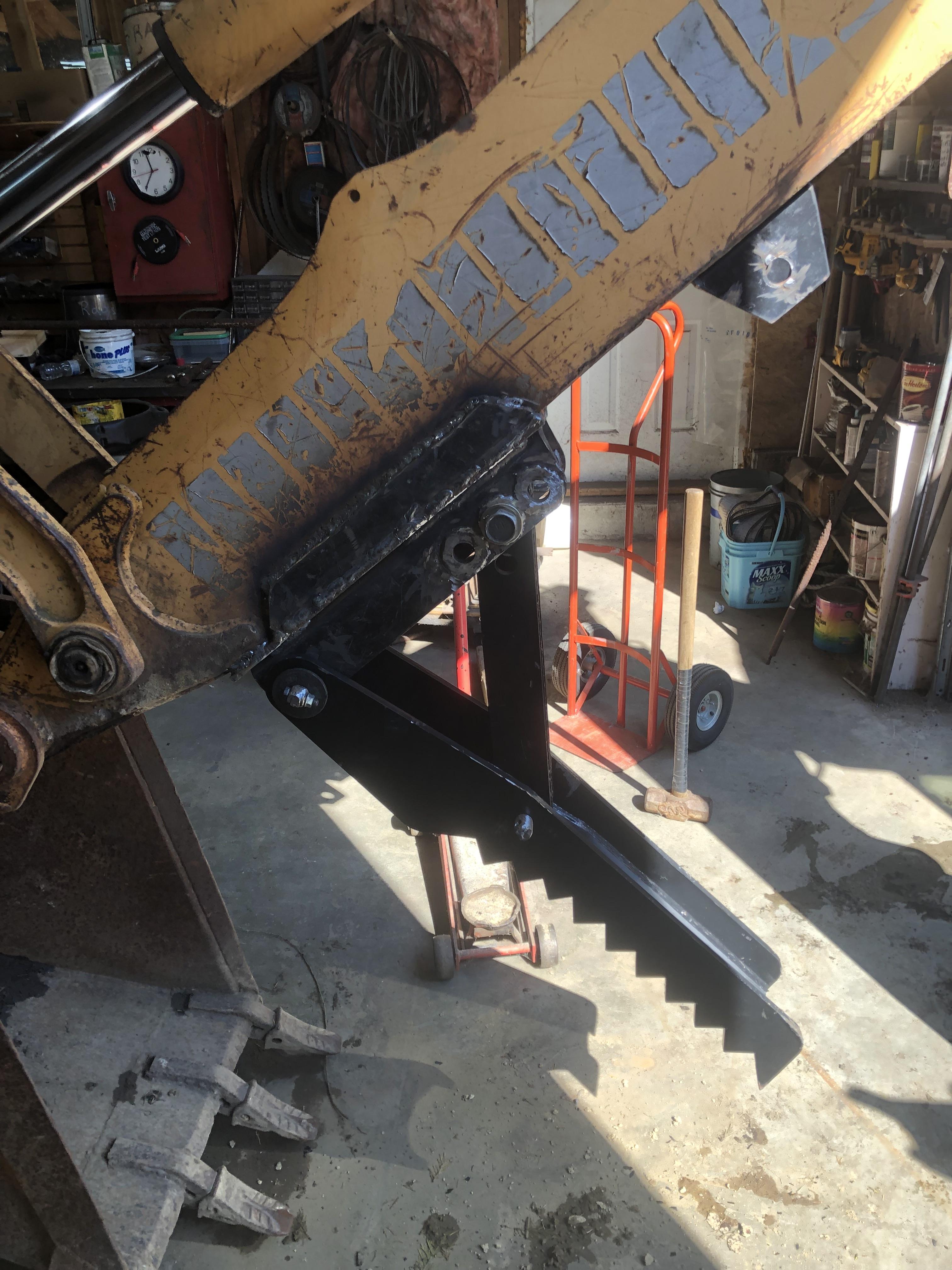

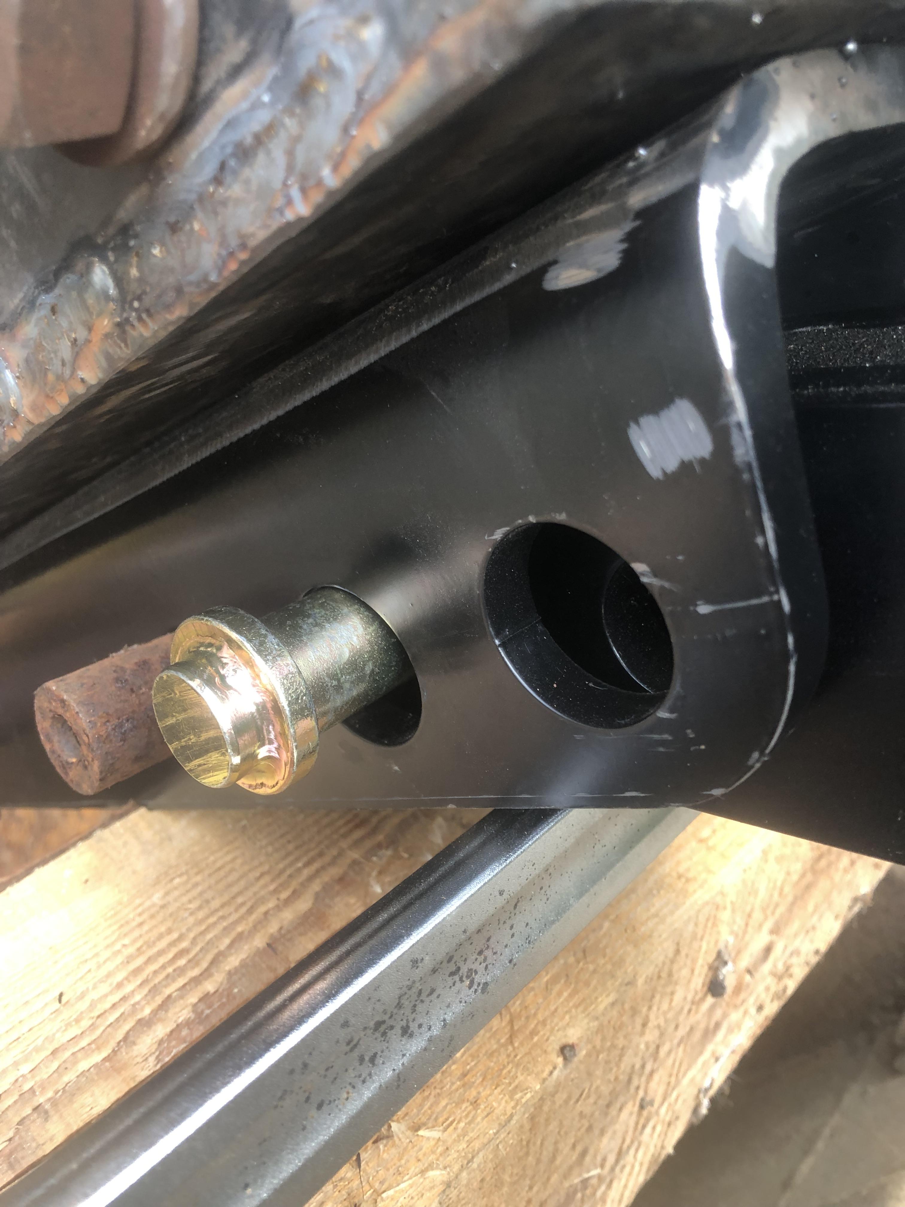

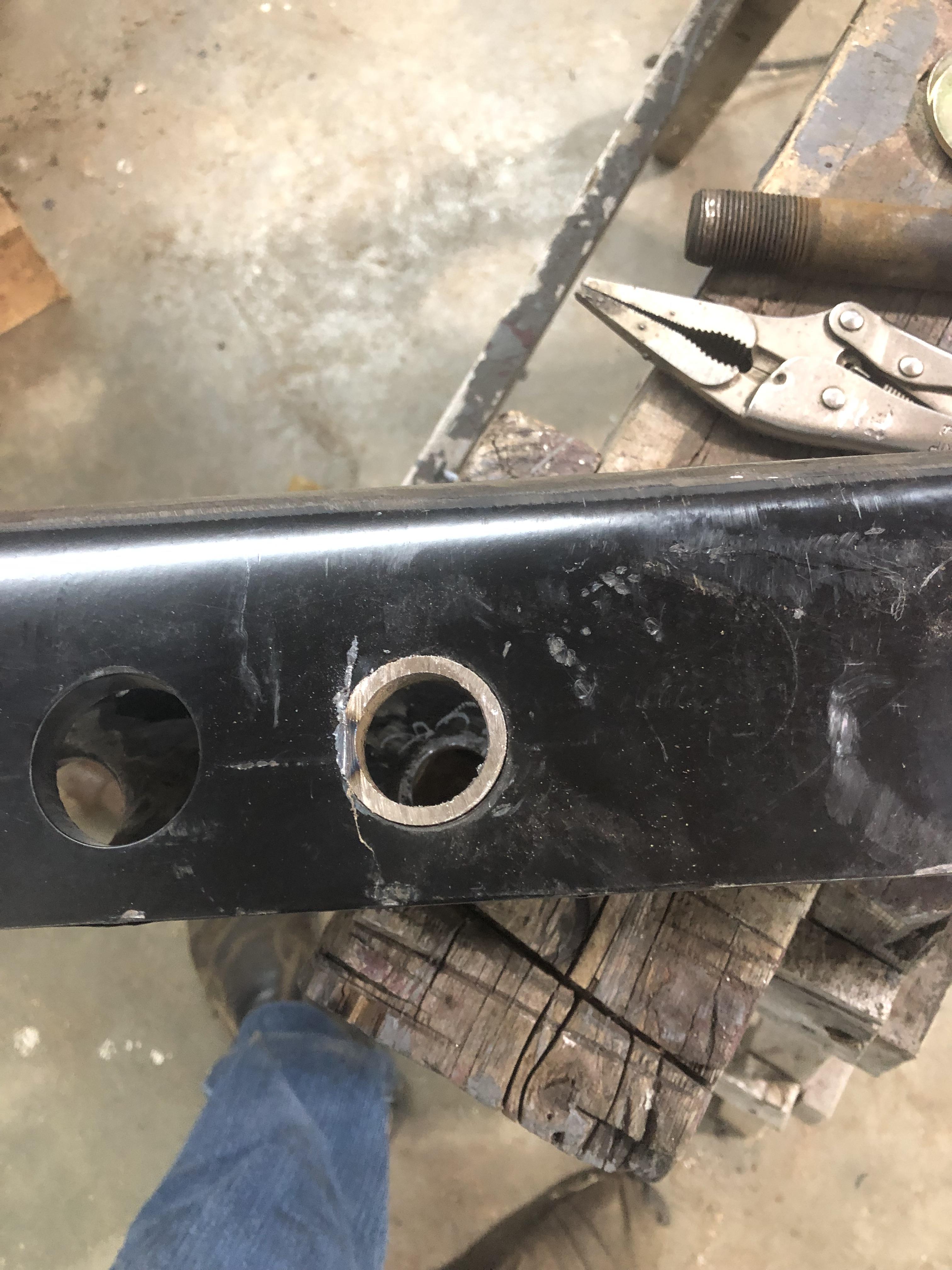

Well finally got around to installing the thumb on the old Case this week ! Should work out ok! Got it off Amazon for 500 ! After a few mods they sent the wrong pins and mount bracket so I had to sleeve the holes down to one inch as the bracket had 11/4 holes ! How ever Its mounted on there and We will see how it works!
