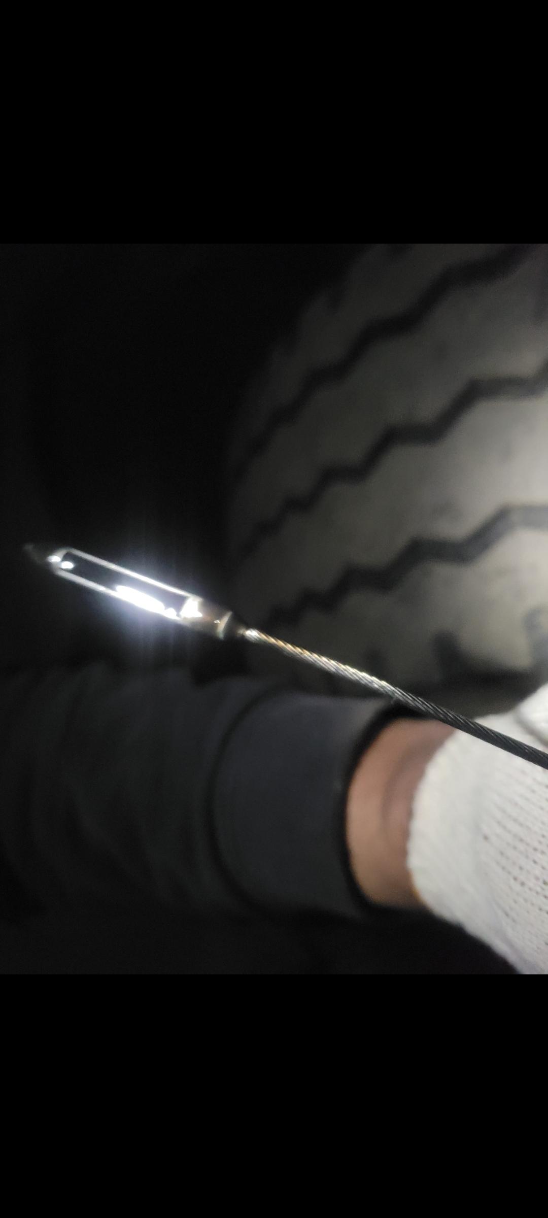

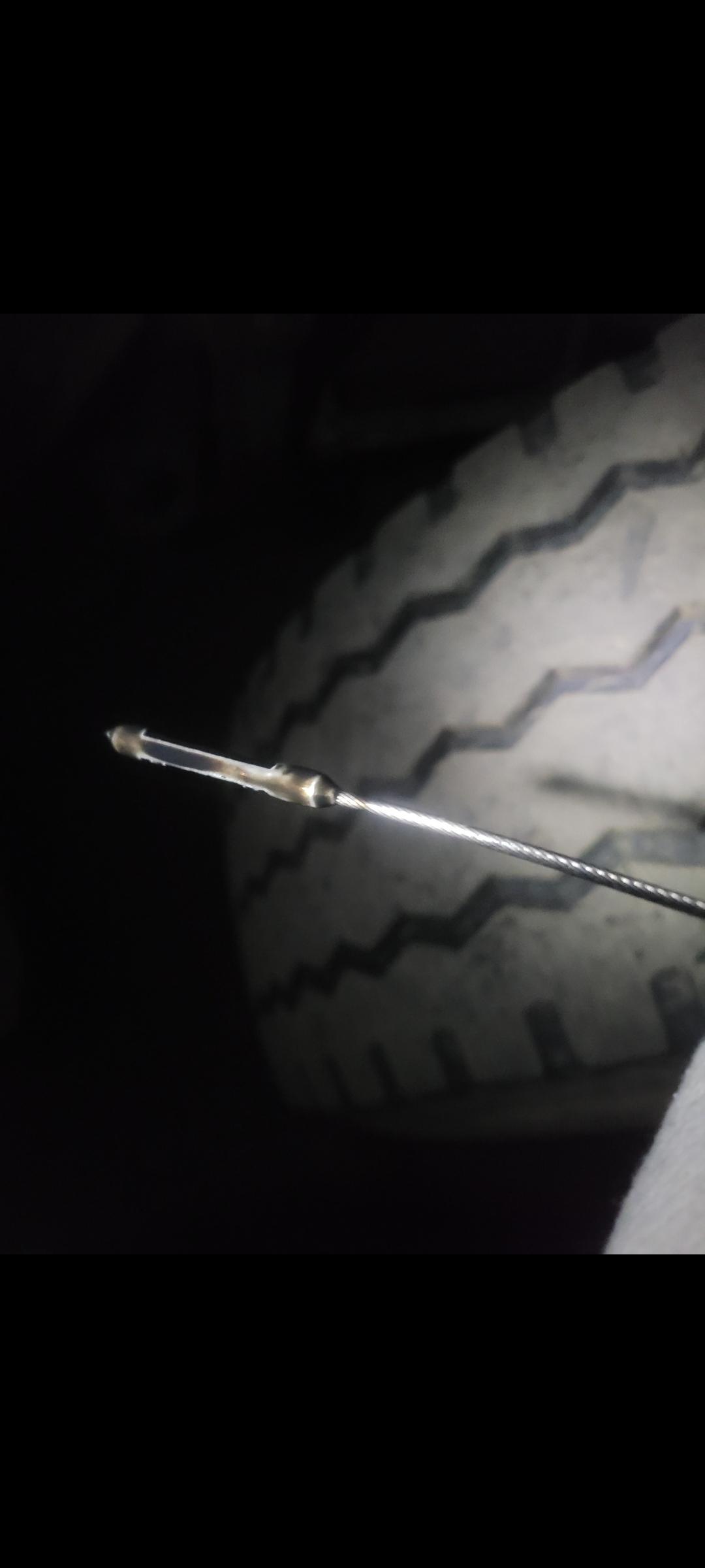

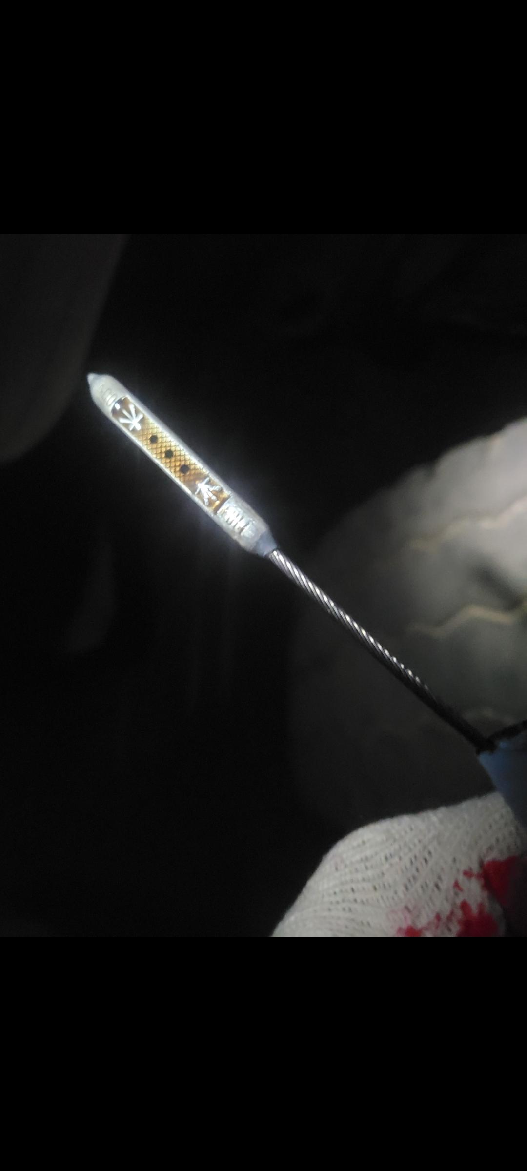

How about this??         You just put new oil in it,, and pressure is good now...  Run the truck and keep your eyes on it...  Then get back to us..  All of us who are mechanics/ owners,  know that this is a challenge..  Just keep in touch, and post all of what you did, and what the truck did..  with respect, Jojo
Agreed run it for awhile keep checking the oil in the morning and if it increases on the dip stick you’ll likely have your answer then you can start doing the testing!
