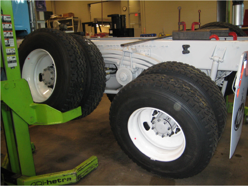

Unfortunately in my opinion  you are correct on all counts there   Onyx ! That V/ M ride   is one of the better ideas The V brand applied to the trucks ! The only weak spot is the axle pedestals  made of rubber with a safety chain inside the bonded rubber breaks free and the block tends to dance around on top! we sold a fare few MR Garbage packers with this stuff it was standing up quite well ! I had several customers that brought some older  Volvo dump trucks in for inspection Every six months and this was a fairly common occurrence ! Volvo ran this set up for a fair few years be for they offered it up on the Mack brand ! You don't want to take advantage of that pictured articulation to much OR  you will soon be replacing the block ends on a regular basis. just an observation!

The weak-link we saw on the original ones was where the top  V torque rod was attached to the top of the Diff carrier. They did some minor updates then a couple years ago finally did a major diff carrier housing re-design and this solved the issue for good.  The only problem I have heard is where the V torque rod attaches to the frame . The bolts ( 2 bolts on each side) have been known to break in extreme loaded off road conditions. Theses are GU/GR tri axles max loaded 80,000 pounds+ on rough job sites. The bolts will break on one side and usually on the front drive. This usually tweaks the V torque rod where you can’t get the new bolts to line up and the V torque rod has to be replaced. We always replaced all the bolts while we were there. This was about 2-3 years ago . I have not heard of any problems since.  I have only heard of one with a broken leaf spring , a young boy at the shop changed it in less than 3 hours. All in all it is a good set up even though I mostly saw the bad side of them. As I said earlier, all my  dump truck buddies have no interest in going back to camelbacks.
That suspension has been around for a while . If I remember correctly it had the most articulation of anything at the time (now TufTrac is close)  They were marketed as "The Gripper" or something like that. That was back when Volvos were really homely.  M Ride with double reduction drive axles, pretty hard to beat in the back of something going through soggy uneven ground.
I ain't no truck driver Have no real world experience I can only offer up the stuff I hear from the customers I have worked with over the years! The few customers that had the V ride set up Liked it! As you can see by the pic it has Good Flex as the four wheelers call it!
