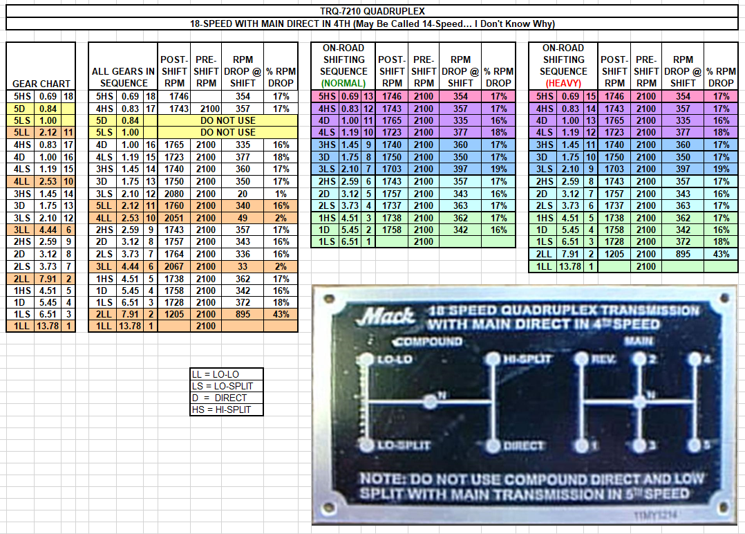

That is a double-overdrive trans.  Shifting is pretty much the same as an 18-speed version.  Even in the 18, 14 speeds were really about all you could use, anyway.  The 20-speed is a single overdrive, and the sequence is different in high gear.  Somewhere, I have the ratios for that box.  I will try to find them.  The Quadruplex is my all-time favorite Mack transmission.
Here is some numerical info on the 14-speed gear ratios.  hey really are not that different from the 18-speed.  It's probably called a 14-speed because, if loaded really heavy, you would usually start in Lo-Lo 1st, then go to Lo-Split 1st, then pick up the "normal" sequence.  On occasion, I tried using the Lo-Lo 2nd, then going to Lo-Split 1st, but the road speed was really too low to make that work well.  So, the 18-speeds we had were really "14-speeds", too.  Ignore the "18" on the shift plate.  I didn't have a good picture of a 14-speed plate!

F, you'd be surprised. Don't forget, something like that topped out in the low 50 MPH range. True they didn't spend a lot of time in HI gear . At the time though ?  for a dump truck or a mixer (or something like that) they were pretty good at walking around in soft earth with a load on them.  (lol)  What were they ??? 170 HP and like 600 lb/ft of torque in a narrow RPM range ??  In 1960 though.....that was something.

5th was OD, so using under or direct in the compound would be slower gears.  Once in 4th Over, 5th was the last gear.
