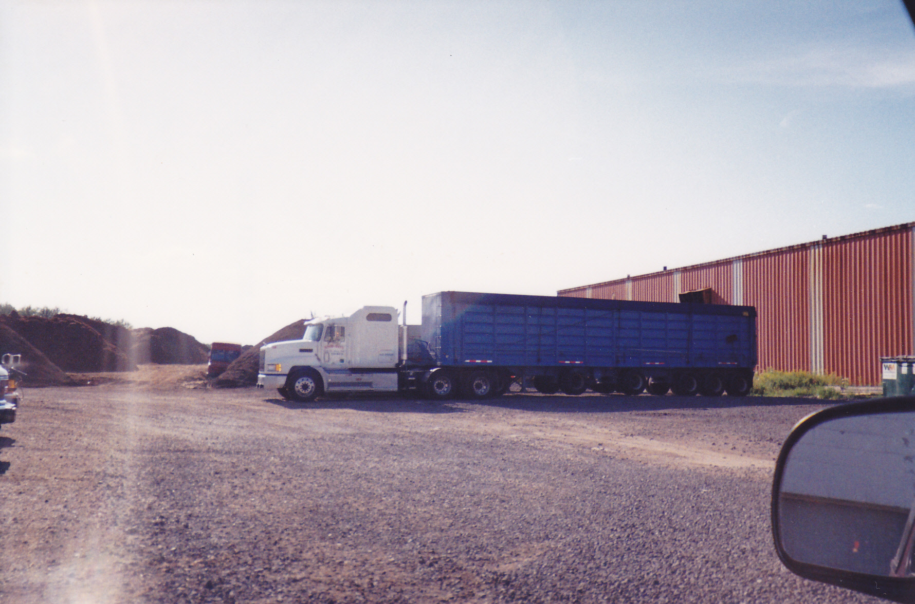

I hauled 140,000 gross every day with my old 2000 CH with an E7 460, 18 speed, and if I remember correctly 4.11 gears. (46,000 pound Eaton's) And we're all hills up here. I also scaled the second heaviest load of hog fuel into our local flakeboard mill at 167,551 pounds gross.
I couldn't pass the 475 Cat's in our fleet but I could just about stay with them. So I would say you shouldn't have a problem.
