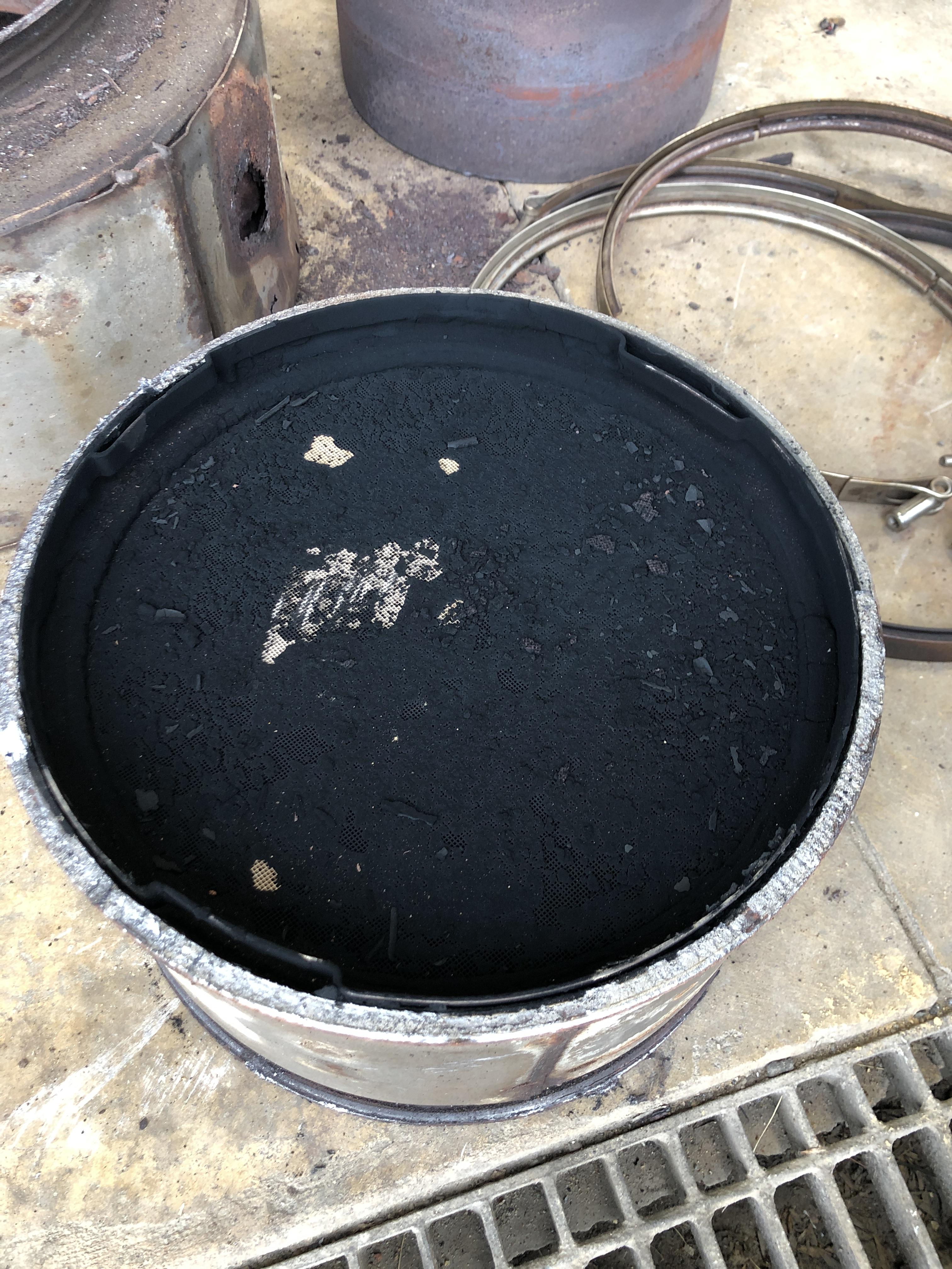

1st pic is DOC now. 2nd and 3rd are the DPF we replaced 1st time. (was new in Dec. of 2021) pic 4&5 are the DPF just put in a last week.(my co-worker blew it out. it did look worse)
