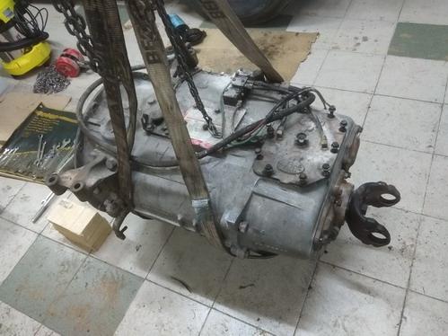

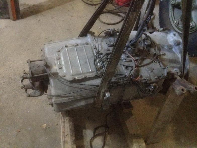

Hope it's not difficult to fugure which one is long and short. The particular pics represent short version T2090 (I have almost similar T2060 in a truck) and the 2nd unit is the spoken T2070 long compound I installed on my R in place of the "short" nine speed. Had to cut the prop shaft and tinker with shifter air lines a bit.

Thank You. This is what I needed.

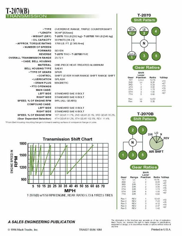

You are probably right. I have only a few Mack tranny manuals but one about T2070 represents long compound only. Also there's a brochure (below) posted on here in the past which also describes T2070 in the long housing only (note the length in the list). And two actual 7-speed trannies I could adopt locally both have long 2nd housing. On the other hand I see no reason a 7-speed can not be done in the short version.
anyone notice the T-2070B doesn't have a fourth gear , I know it does; missprint

10 hours ago, Joey Mack said:
that picture shows a 2070-B... which means multi speed reverse.  so the back box will be longer..  correct me if im wrong... jojo
I have a manual which is entitled as T2070A. Common reverse style but long rear compound. In fact it's half empty compartment if you look through the top cover opening. There's space for the reverse setup but it doesn't take place. Probably the reason is possibility to install PTO. Short compound housing doesn't have the mounting as I mentioned above.
