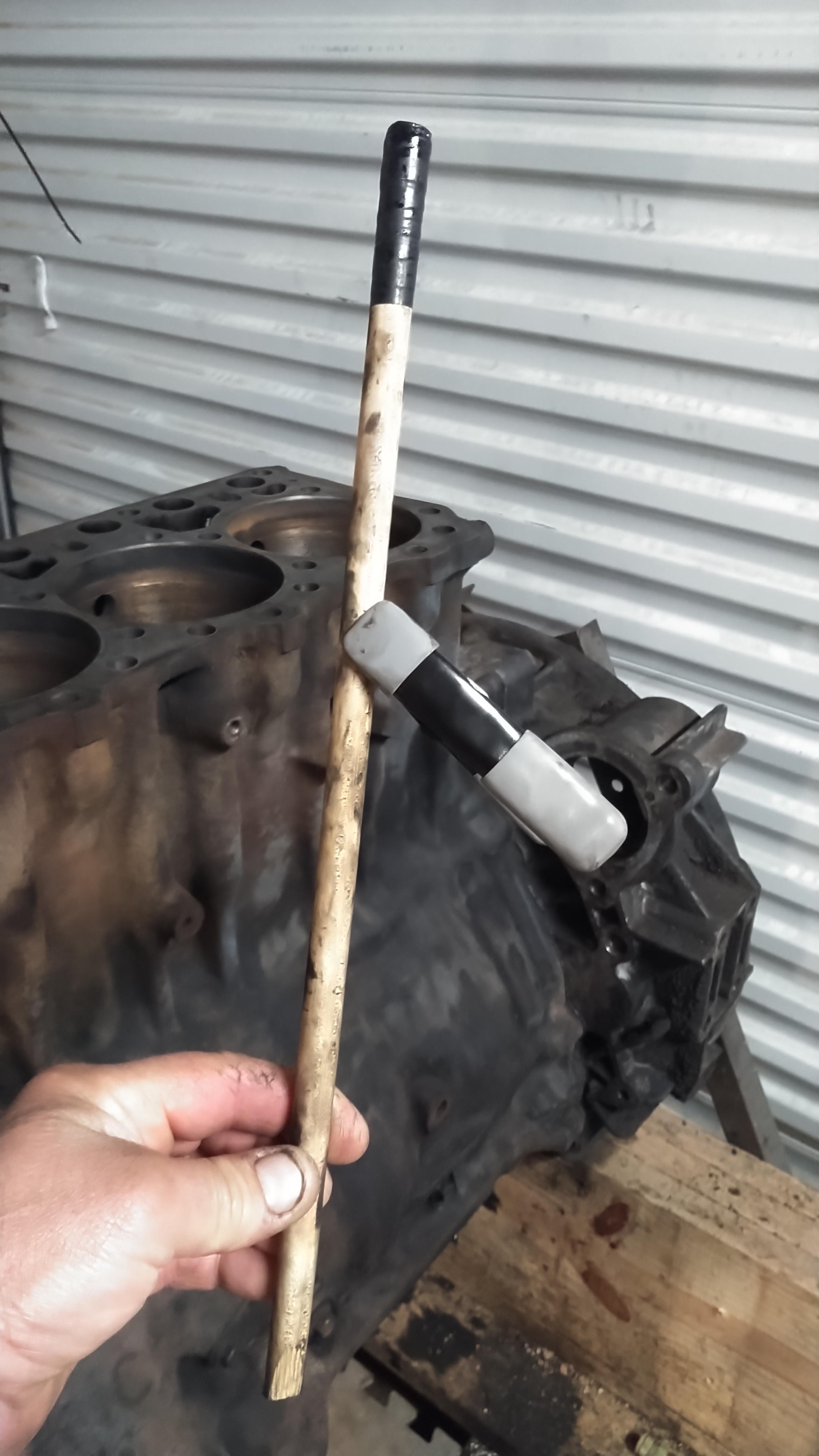

I made some sticks with wooden dowels, and bought earth magnets and scuffed them the epoxied them to cut lenghts of dowels, then for extrac security, i put elec tape over them then around the tape to hold the overlapped tape.  the magnets stayed glued, the tape is insurance that can be replaced with ease... $50.00 for all of it.   $700.00 for lifter sticks on-line.  of course these are not for E-6's, as you can easily hold the lifters through the right side. I miss the side covers... jojo
i like it.    $700.00  darn     prices are un real today. another "secret"  advantage to clothes pins;;;  you can sneak them back to the wifes laundry basket when she's not looking.  what motor oil spots  = i donno  what that is 😁
