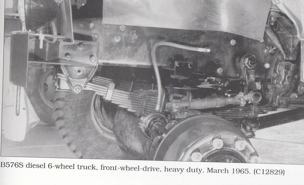

The spring width will be determined by the width of the frame spring mounts and the axle perch.  The front is a slipper so the length can be fudged a little.  Going to take a little extrapolation to do the CL.  This 576 has 9 or 10 leaves but who knows if the specs would be the same for you?
Jim

The axle looks much different than mine. Mine is more military style with gear drive ends instead of universals.  Now I'm wondering if it is a B or an NO axle.

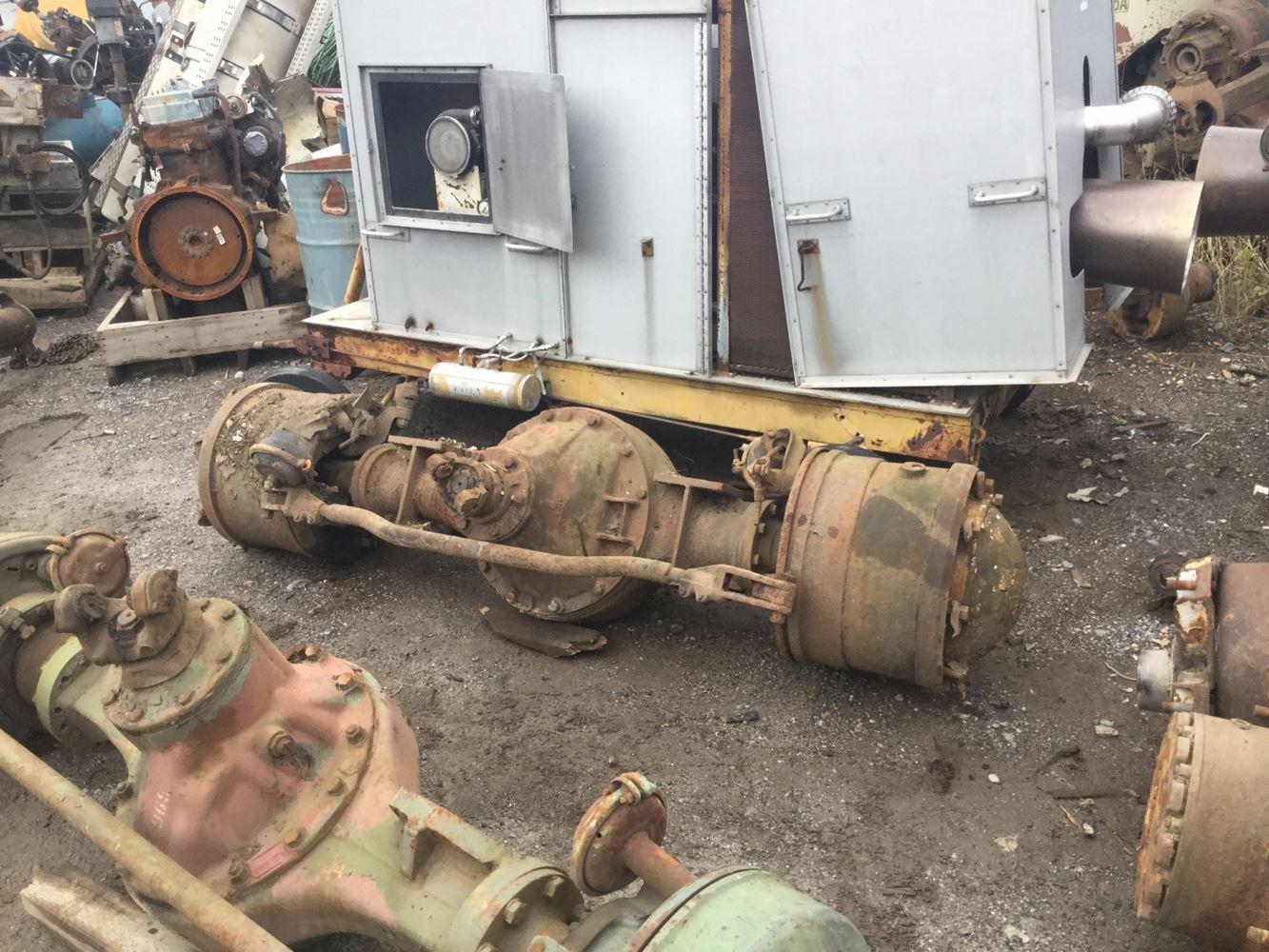

      Mack part number ??    2QH4122P1,  pumpkin casting 5200K401.   6.83 ratio.  THats what I can see with out pulling out on the container.
Edited by 41chevy
Here is a fleabay ad using that 2QH number and then crosses it to Meritor.  If it is accurate, getting Meritor parts may be easier than Mack Vulva if you get into a bind and need something.
https://www.ebay.com/itm/Meritor-Rockwell-Front-Drive-Steer-Axle-Differential-Model-No-FDS1802-SAX3/112777469620

Wonder if it in military spec. although when I bought it I was told it was in a B model logger. Have to see what Meritor/ Rockwell people have to say after I get it on the ground looks to be a tag on the ham.

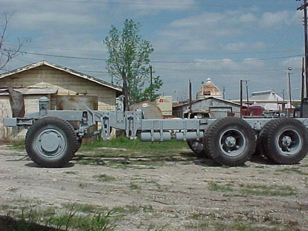

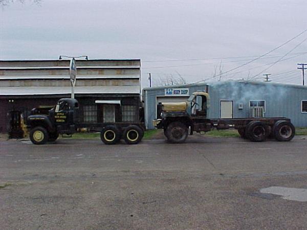

This is how a factory B-model looked with that setup. As I was told the front axle and the transfer case were of the same style as Mack NO had. Maybe excepting the gear ratios.
For some reason I think the frame rails are stepped at the front to clear up the drive axle. NO was made that way. But I'm not sure for the B.
Edited by Vladislav
B model 6x6 has a straight rail for the M.H. or Howe conversions 2inch step for the M/R and Coleman conversions. M123 has a straight top of the rail and a 2 inch step on the lower rail and is 1 1/2 inches narrower, which explains the difference.  Mount to spring for B and R is with spring blocks to set spacing as per Craig Trout from J.O.T..
The Grey chassis has an AxleTech 4000 military set up with gear reduction hubs from a 2 1/2 to 5 ton Military cargo truck. Axle rated at 19,000 lbs. and ratios from 4.35 to 13.74 most common is 6.86
