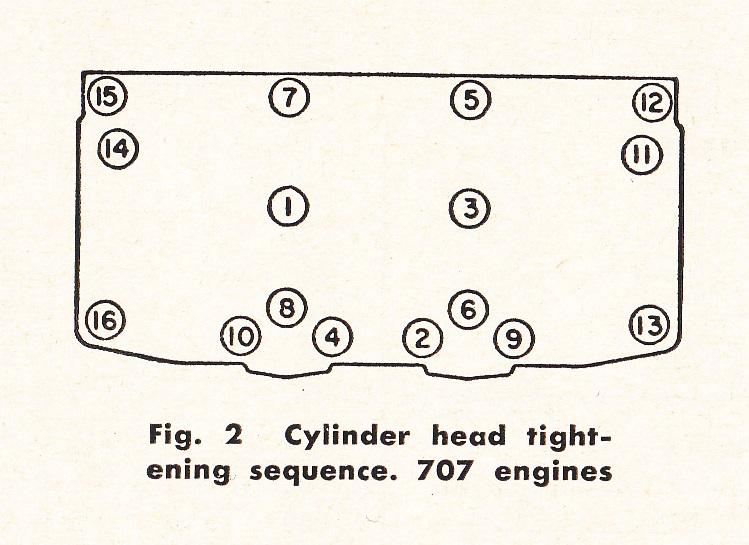

The final head torque for a Mack EN 707 is 150 ft lbs.  I can't seem to find torque value for the first or second pulls.  I would probably go 50 ft lbs on the first round and 100 on the second in sequence.  After a little run time, the head bolts should be rechecked.
Jim
There may be an official pattern.  IDK?  I try to work from the center out on manifolds.  Refer to a torque chart depending on fastener size, type of material and threads per inch (TPI).  I probably under torque due to not wanting to break a cast iron manifold that may be difficult to replace.  As usual, check them again after a few heat cycles.
