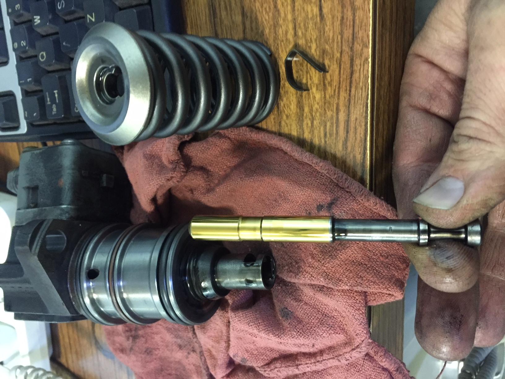

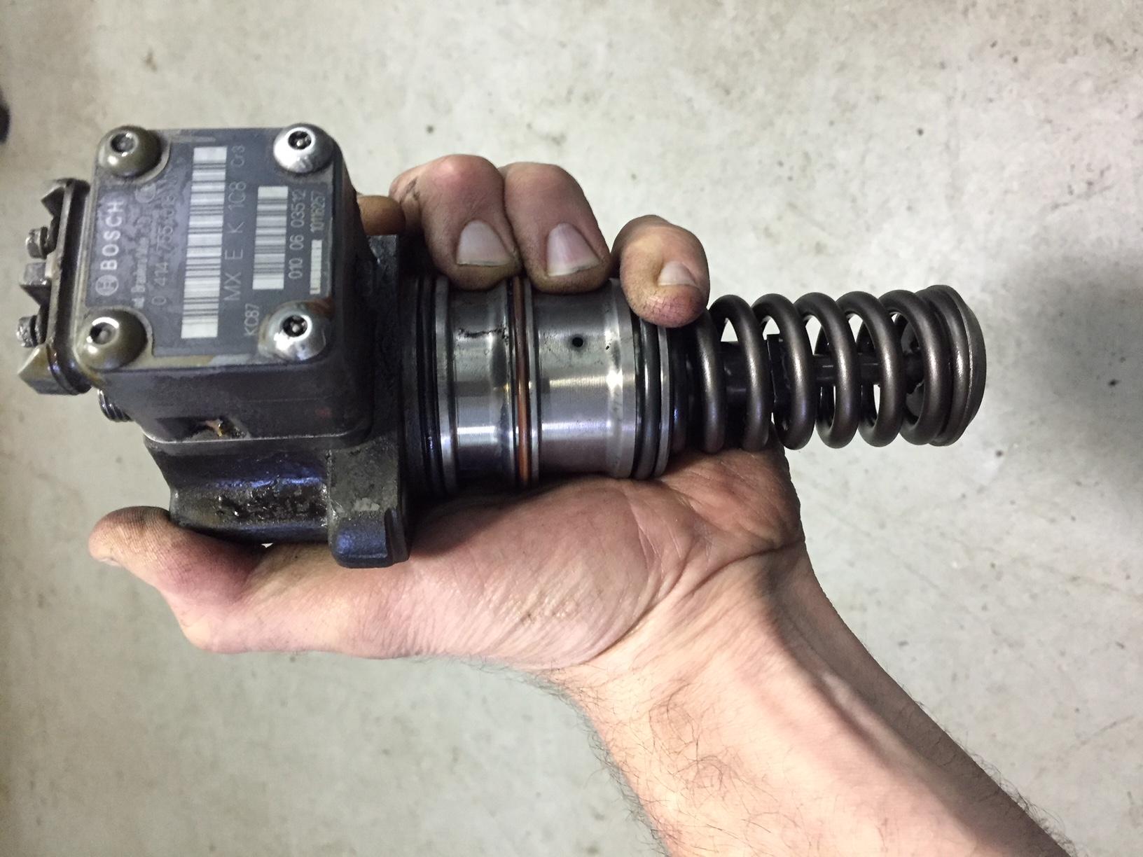

Just happened to lose an EUP in one of the 934D engines yesterday...…..
EUP.thumb.JPG.f6f1c4f9069911a6436076967394a5ec.JPGEUP1.thumb.JPG.491fe2f2a7a70ae055cc5018782df0c1.JPG
The Gold surface is your seal between the fuel column being injected and your crankcase. I don't see it as a 100% efficient seal and would allow a minimal acceptable fuel x-over with age and wear.

Did you go through the service bulletin I made reference to? Mack doesn’t suggest changing EUPs for the issue.

No fix, I've never seen an EUP changed for contaminating the volume of oil via plunger leakage as illustrated. It's not a perfect seal, but sufficient. I think a trace amount could potentially come from a steel-steel seal like the injection plunger uses. 0.05% as you listed...…?……...maybe, but that does not qualify a contaminated engine?
