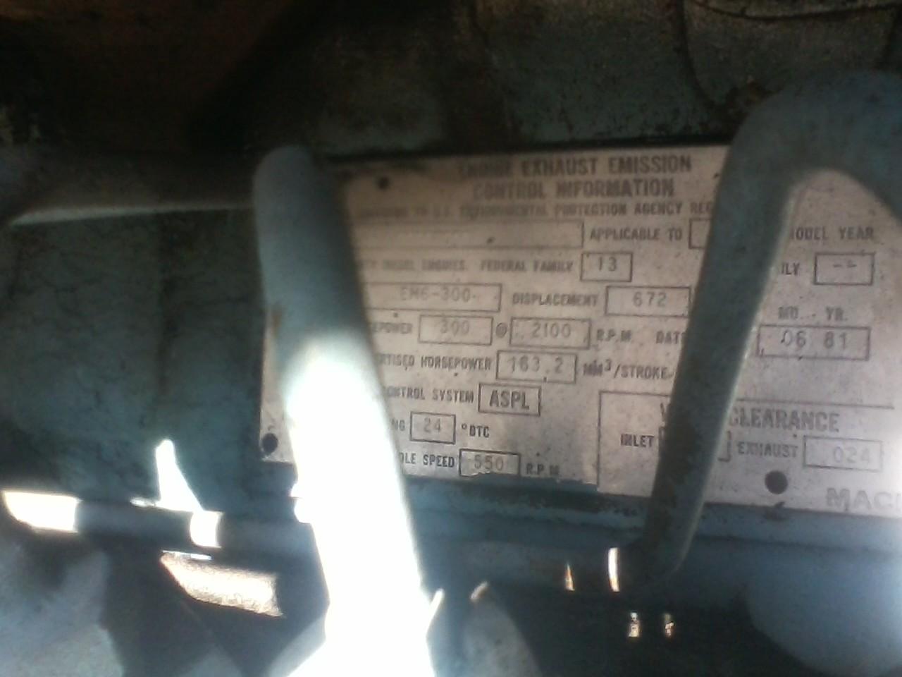

Again, the truck/tractor is very nice and am happy you are as open about learning about it as we are sharing what we know.  Being a former fire truck usually means low miles but high hours for the miles as your shows. Trucks built after 4/1/1980 went to a 17 digit serial number where trucks built prior had a 13 digit serial number such as R685STXXXXXXX, (X's representing numbers). Your truck being a 1981 will be something like  1M2W133Y4BA009700. The "B" character in the serial number represents 1981 as date of manufacture. If you replace the "B" with an "F", it represents a 1985 Mack R685 currently listed on Truckpaper.com. The serial number is a screen grab for showing here and I have no affiliation.
I assume your truck is an R685 series with a Mack 237 engine which probably is an EM6-237 and five speed direct transmission. This would be a TR-107 series transmission. Both are rock solid in performance as are the 34K Mack rears which likely will have 4.17, or 4.42 rear gears. Being a direct transmission, I'd wager the 4.17 which were very common.

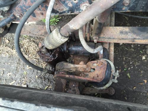

 My other thoughts are I have a 74 Pete that I have had since 1989. Guessing from parts I have replaced over the years it has earlier 80's Mack steer axle with the box mounted to the front axle, with 4:10 Bogies on Reyco spring. What my question is, do the hubs and drums" they are bud wheels"  off the Pete  interchange direct to replace  the Cali wheels on the water truck? Or is it even worth the trouble?  Thanks Coy
Off the cuff I don't think it would be a ready swap but that is without any information. First thing to do is look at the stamped area of both axles. If Mack axles, right under the rt. front spring leaf will be a series of letters and numbers such as FA-5XX and some other numerics. If a Rockwell/Meritor axle, there will be a tag in the center of the axle beam. If both trucks have Mack axles take those numbers to a heavy truck parts supplier and see what bearings the hubs use. If different bearings, no since going any further. If the same bearings, remove a wheel from each truck and start measuring the bearing surfaces for distance(s) from each other, and spindle length(s). If measurements are the same, then yes the hubs will swap. If not, it would be a "no go". for your current swap. There would have to be a lot of R model Mack trucks with Budd style wheels out your way I'd think as the Dayton, (spokes) were not so common out west.
With the steering gear mounted to the axle beam under your Pete, I'd wager the axle is from an RW series of some sort. Early 80's probably. Your truck a 358 series?
Well great! I will look at this in the next few days. The Pete is a 359, it was a manual steering truck so I guess that was a less expensive way to make it power.  And we all Know the SQHD rears probably needed replaced, and the Bogies are tough! Thank you!!!! Coy
