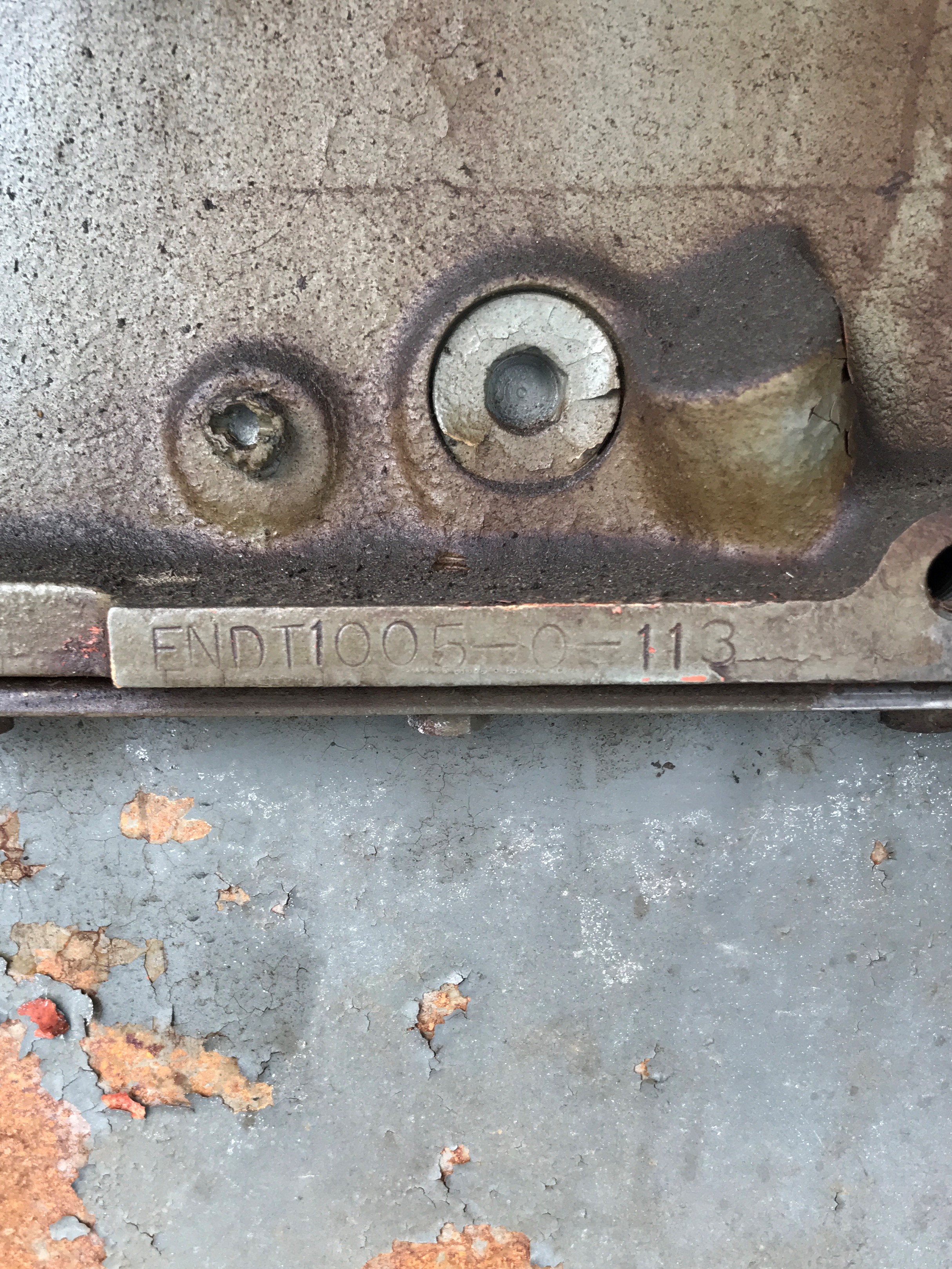

On 12/24/2017 at 11:49 AM, BGarofalo said:
The engine serial number should be on the passenger side of the engine on the oil pan rail. You will see a flat area. I would have to agree with 41Chevy, I think the number built is wrong. The timeline with the engine build dates just doesn't line up. Aside from a few differences they are pretty much identical to an E9.

Can you post a pic of the area on the oil pan rail where yours is stamped? I see a bumped out area near the front corner where my a/c compressor mounts, but I can feel or see any numbers there.
Your in the right place. I had the same problem when I was looking for my numbers. I had to get the sand paper after it. There not stamped real deep and can be hard to read sometime.

Its tight to the frame rail.. damn near need a mirror to get a visual on it.. right?

Sorry for the delay its just been madness at work. Passenger side near the front cover on the oil pan rail. Its a very light stamping so you will probly need to sand the paint down a bit.
