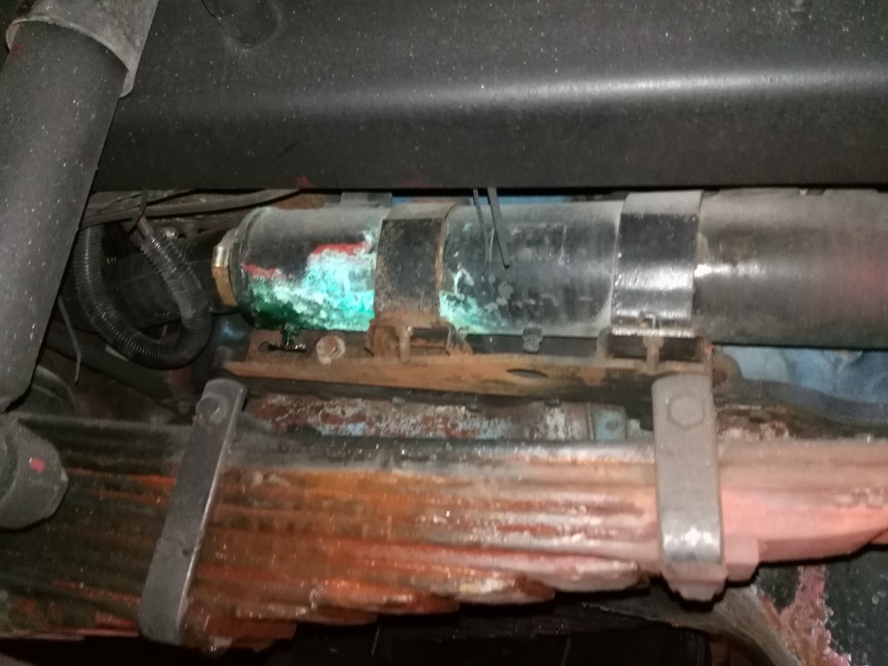

I am taking it out to an old buddy that is a retired diesel mechanic to kind of go through it and do some of the things we've discussed (flush radiator, change oil, "tune-up", check belts, thermostat, etc) as well as start to go through it all with me and figure out all of the switches and controls and bells and whistles on it.  Looking forward to that.  The night I got back into town I stopped at my office for a minute to check some things and left the truck running.  Upon walking back out a saw a small bit of water that seemed to be running out from under the truck.  Because I had been checking everything SO closely, I was sure it wasn't me, and I must have parked on an old puddle.  I bent down and rubbed my finger in it and smelled-coolant.  Again, having not leaked any noticeable amount the whole trip, and from the fact the fluid was cool, I assumed it was old and not from my truck.  I drove on home, about 6 miles, and then got a flashlight to take a better look.  Well, it WAS coming from me.  I am not sure what the part is called, but the lower radiator hose appears to run into it, and it looks like a larger sized "pipe" or "reservoir" or something, that may simply be a solid piece of tube to allow the coolant to proceed back into the engine block?  It is bigger around than the radiator hose, and does have a spigot on the bottom (seems to be lowest point on the cooling system, so possibly this is the place best from which to empty the system for a coolant change/flush?  It is metal of some sort, and shows the green patina of years of holding (and possibly lightly leaking) water.  It was leaking a steady drip, though not even a trickle-maybe one drop every 5-10 seconds.  And I have checked the system since-it seems to be holding fluid fine when sitting still, and thus, is likely a typical little pinhole style leak that only "produces" under pressure.  However, the fact that it has any leak at all, in this position, while still holding fluid, etc, makes me VERY eager to repair it, so that is also something we are going to look at when I get it out to my mechanic's.  I am attaching a pic of this part so that anyone that recognizes it can tell me more about what they may know about it and if there is anything particularly tricky I am getting into in working on it.  Or even what it might be called so I can try to find a replacement?  If it truly is only a reservoir/dispersal tube, I imagine one could be fabbed pretty easily, but if it is something terribly complex and intricate, would be good to know as well.
If you do sell the Mack, you have had an interesting adventure with it!  The picture looks like it could be a water heater for the block.  It has been leaking for a while.  There are no glow plugs.  Tracing wires, hoses, etc. will get you some answers as to what everything does.  It sure will be easier dealing with problems at home.
