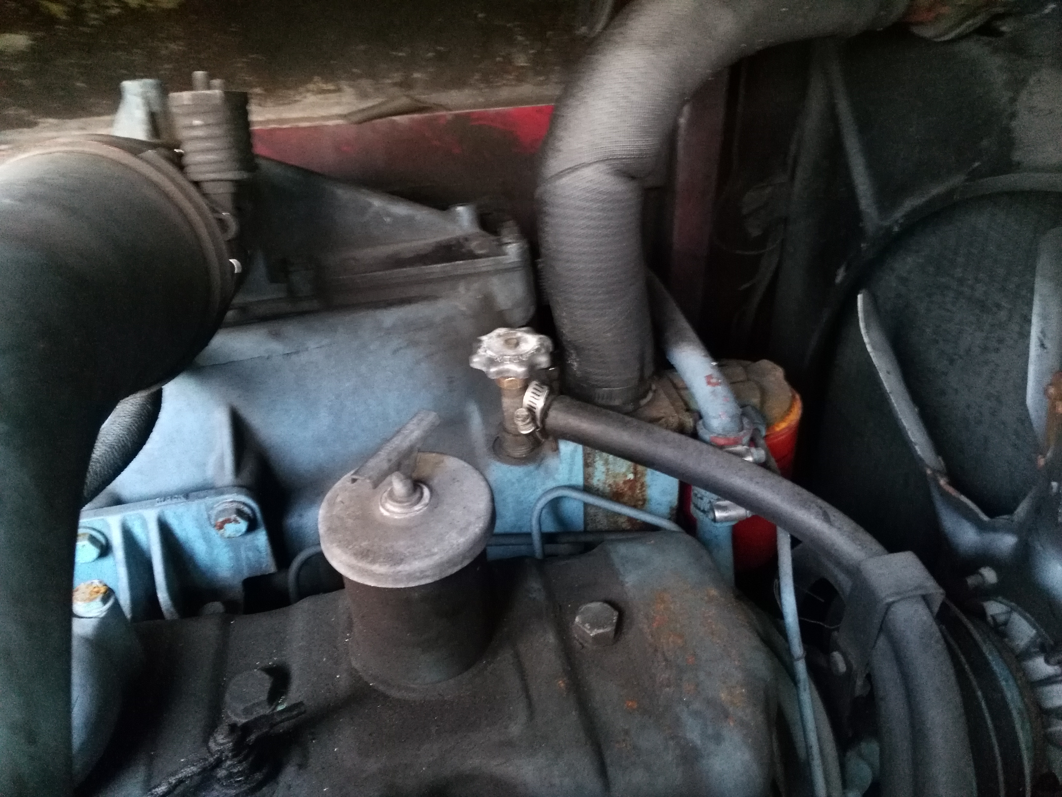

I am sitting here with a good, old-fashioned mechanical temp gauge, trying to figure out where to put it.  There is a small plugged outlet up in the "overflow reservoir" for the radiator (that is what I am calling the tank that is sitting ON TOP of my radiator, where I actually add water and coolant, etc, but it appears to be a separate "tank" atop the radiator, though it could be just the top of the radiator and this one is shaped in this way.  Either way, there is a small, plugged, outlet here, going directly into the tank, but I am wondering if that is a good place for the temperature sensor or not.  I am not sure if it would read even hotter here or even cooler here, due to location.  There also would be an easy place to place the sensor, where the hoses that appear to lead inside of the cab for the heater to operate are located.  This has a good old fashioned "hand turn" round knob to turn the water flow at this point on and off, as the truck was in FL and I am guessing they never needed the heater working.  Thus, I could remove this valve and install the sensor there, I would think, and this might be a good read.  I doubt I need the heater either for the purposes of this drive, though I certainly might if I use the truck at all during the MI winter, but for now just want to make sure I have an accurate temp read for the drive North.  It is up near the front of the engine, on the top of the head, right behind where the top radiator hose comes into the head.  That sound like a good, accurate spot?
The sending unit for the electrical gauge in the cab is beside the round knob for the heater.  If the mechanical unit in got a short end on it you could take it out and put it there.  Some of the mechanical has a long sending unit end and will hit in the water manifold before it gets tight.  If the is a sending unit at the end of the manifold , it is for high water temperature you could take it out and put it there.  I would not put it in the top of the radiator tank.  There is some plugs in the water manifold behind where the top radiator goes  but I can't  remember what size it is but if it would fit that would work.  It needs to go in the water manifold.  If you drain the water out be sure you bleed the air out at the back of the water manifold especially if it don't take all the water back they can get a air lock in them.

My mechanical does have the long sending unit/sensor.  The hand-turn valve port that I spoke of using. though on top of the engine, was below the "water line" which surprised me as high up as it was, and I had not drained any coolant, so in trying to remove it was losing some fluid, so held off on that simply because I wasn't expecting it to be wet when sitting still and turned off.  Guess that lets me know that aside from the previously mentioned pinhole, things are tight and leak free in there!  So, again, with the long sending unit, any good, existing suggested places for it to go?
When you say the electrical sending unit is beside the round knob for the heater, do you mean the round knob I mention back on the engine near the top rad hose entry?  Or do you mean the round knob in the cab on the dash near the "radiator" portion of the heater?
Where is the thermostat in this vehicle?  I was expecting in what I would call the "usual place" in cars-where that top rad hose goes in at the front of the engine on top.  But there is no "housing" that looks like it holds one.  Just a square block that the hose goes into that also has the "hand turn round knob valve (hose spigot type) that I mentioned.  Is it here?

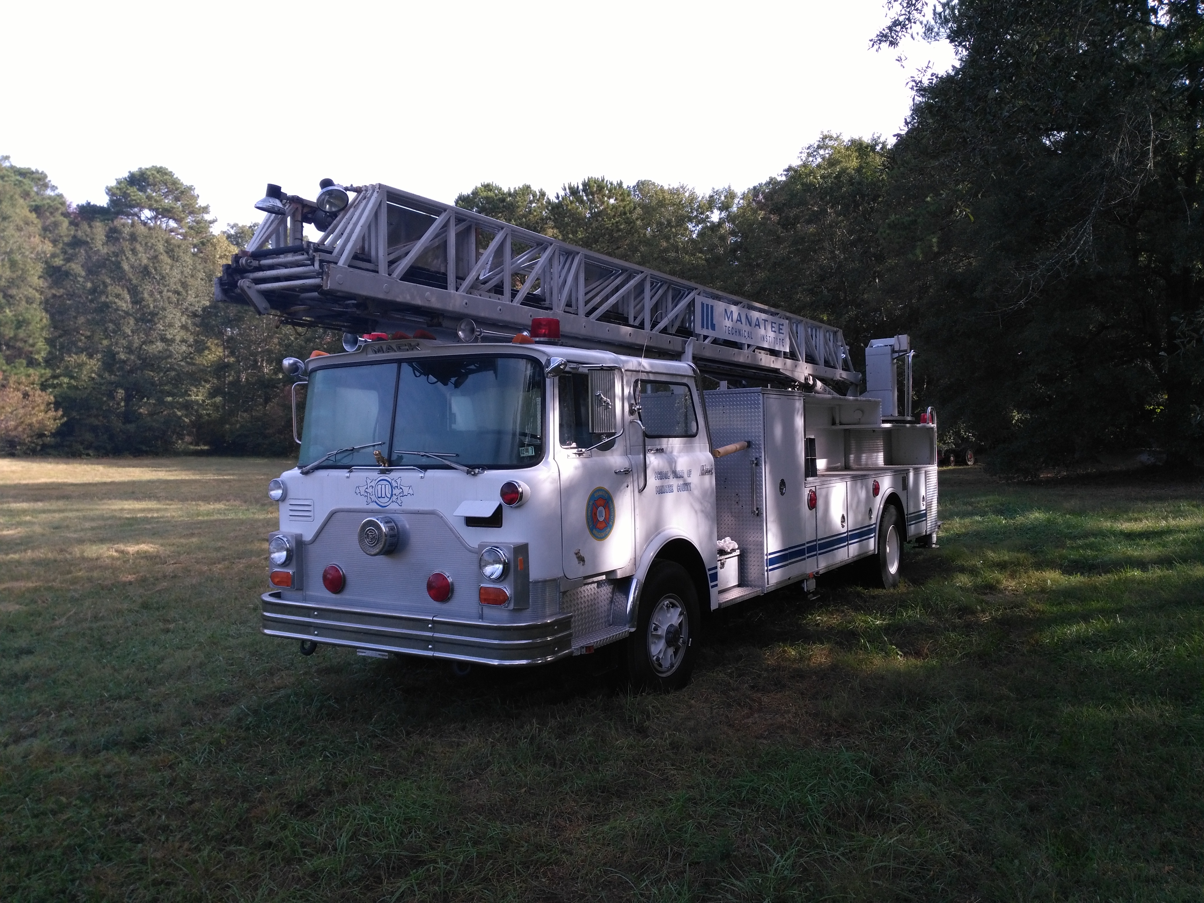

Pic to show the old Beauty we are trying to save!

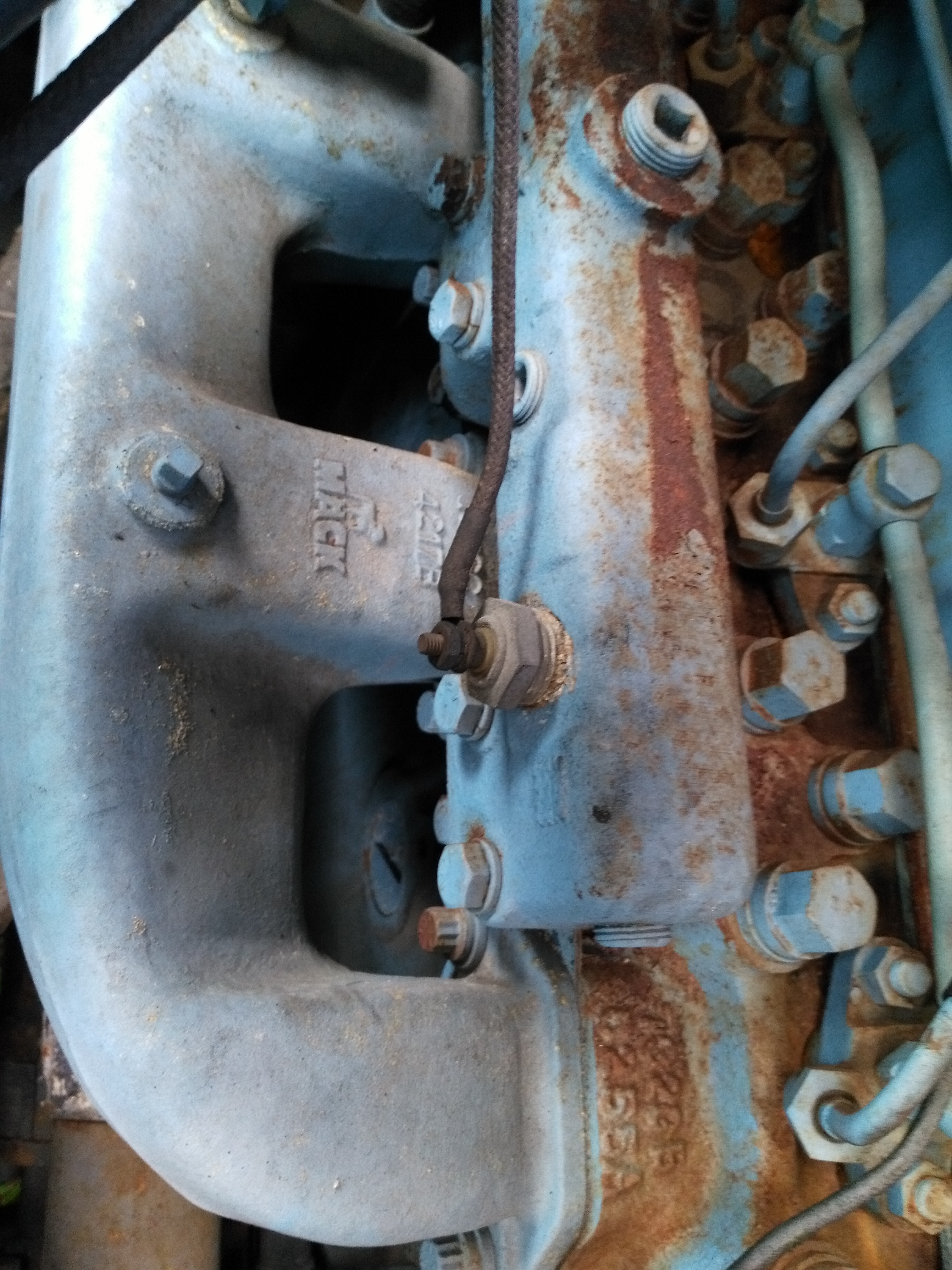

The thermostat is where the top radiator connects to the water manifold and it goes in the square housing.  That water manifold runs to the back of the engine with a hose that connects the front water manifold to the back manifold.  The factory temperature sending unit is in the back manifold at the end of #6 cylinder.  The one that you can see on the side is the temperature sending unit.  The one on the very end is for the engine alarm if it has one.  The heat gun can be bought at northern tool, harbor freight or any auto parts.  When we would put a mechanical gauge in we would put in in the back water manifold.  Maybe some body can post a picture that show's where it is.
The thermostat is located at the front end of the water manifold.  I have installed a mechanical sender into the back end of a water manifold but can't remember what I used for a bushing to compensate for the extra length of the sender.

BR and JHancock. Thanks for replies. I am guessing I found the sending unit. Also going to Lowe's/Home Depot to get thermo gun before pulling out. If it is reading 230 again when I get moving, will temp gun that manifold in the area of the sending unit. The one I found is in the rear of the water manifold it seems. Up front, only port is one with heater hoses and round knob valve I mentioned.  I read an article that said best place to put one is definitely as close as possible to the thermostat. However, that only port is heater hose one, so can't do it with what I've got with me. Maybe once home I can fab up a pipe to take in sending unit and still allow pass-through for heater hoses. Also read saying that temps can get extreme other places farther from thermostat, so maybe that adds to high reading? Manifold at that area conduct higher heat from the proximity/attachment to the head? If I have to use the thermometer gun, I think I will check near the sending unit, and again near the thermostat to see if I get considerable different readings. Going over some mountains between GA and MI, so want to make sure I know how hit I am really running! Thanks for all input, once again. Pic of suspected sensor/sending unit attached:
First picture has a square drive plug a couple of inches down from the temp. sender which is where a mechanical sender can be used.  As the picture is shown, it is at the very "bottom".
Second pic, thermostat is at the point of the heater hose valve, upper hose and the orange water filter/conditioner.
Jim
