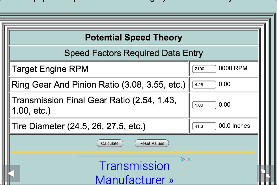

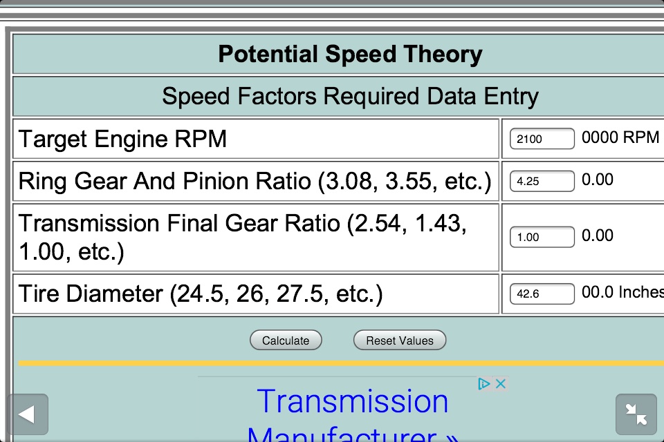

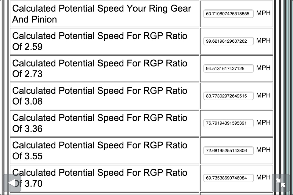

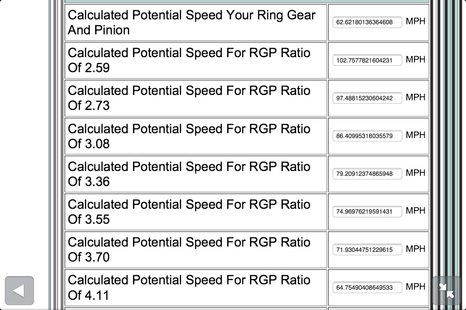

New to Mack trucks.  Tires are 11-22.5,  41 inches tall.  Transmission is 5 and 2.  Last drove with GPS, guess it was wrong.  Installed speedometer gear so now speedometer  works.  Driving this weekend to ATHS show,  will check to se if possibly not shifting out of low range.      Thanks for all replies                                          Richard
