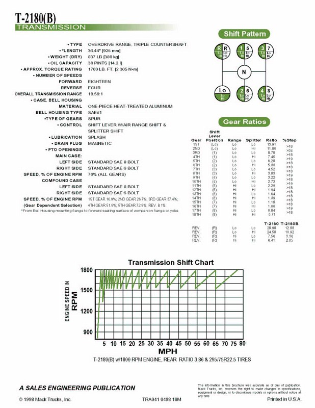

T2180B was originally rated at 1700 lb-ft torque but can be used up to 1800 lb-ft. Lo Gear/Lo Split - 13.91:1; Reverse gear is 12.88:1;
