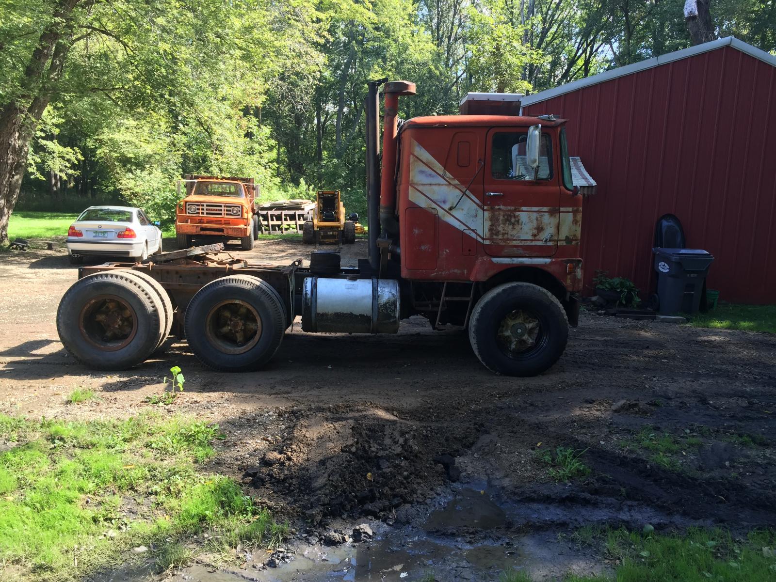

I am looking at putting 385/65r22.5 (Dayton rims) for steers on my f-model with air assist steering.
I am trying not to sink in my soft (swampy) property as bad.
Has anyone run this size tire on a mack cabover?
If so what were the results?
Any input is appreciated.

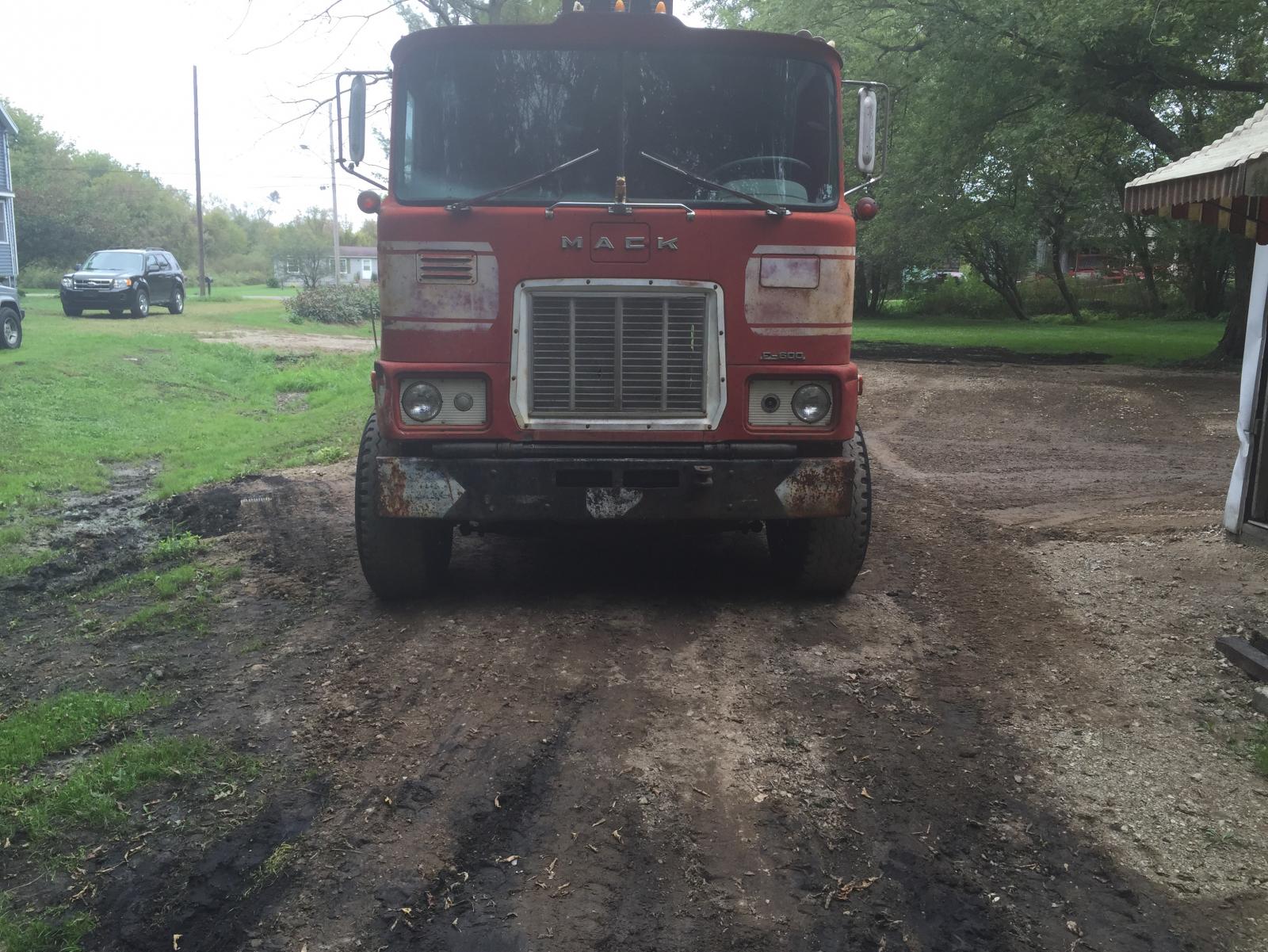

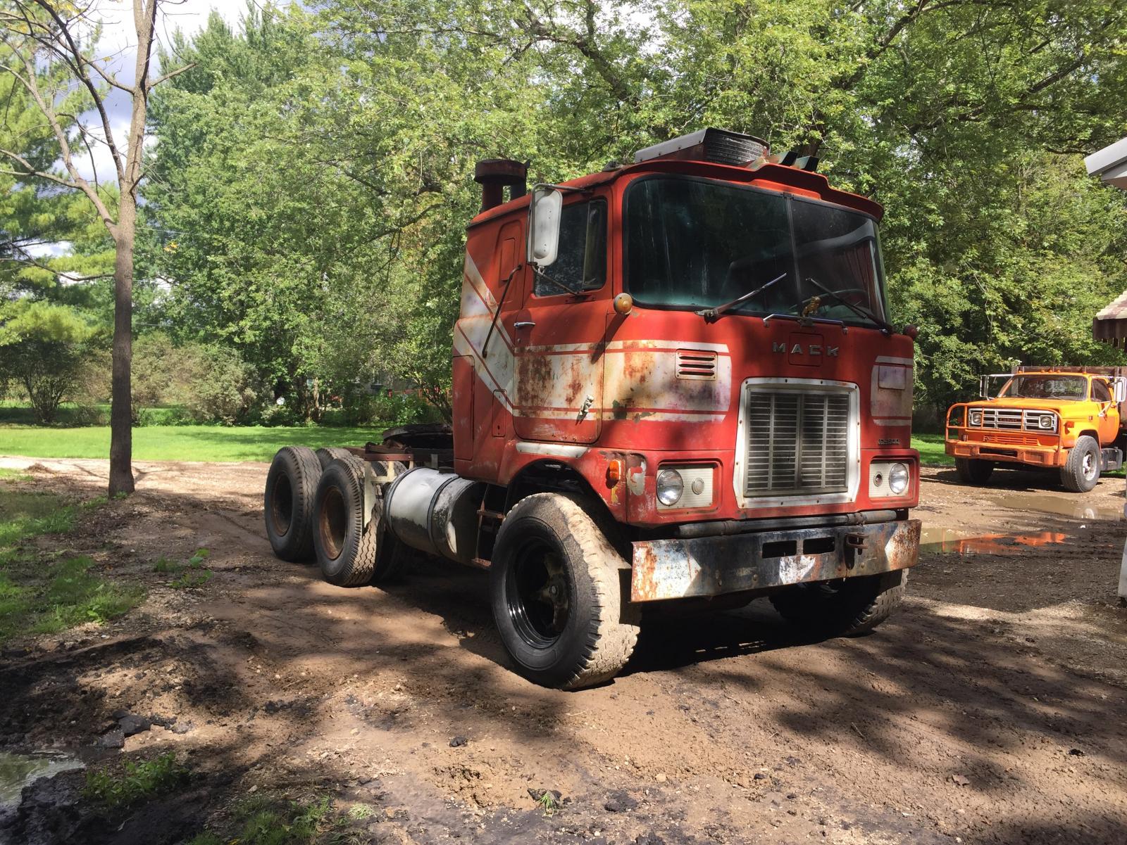

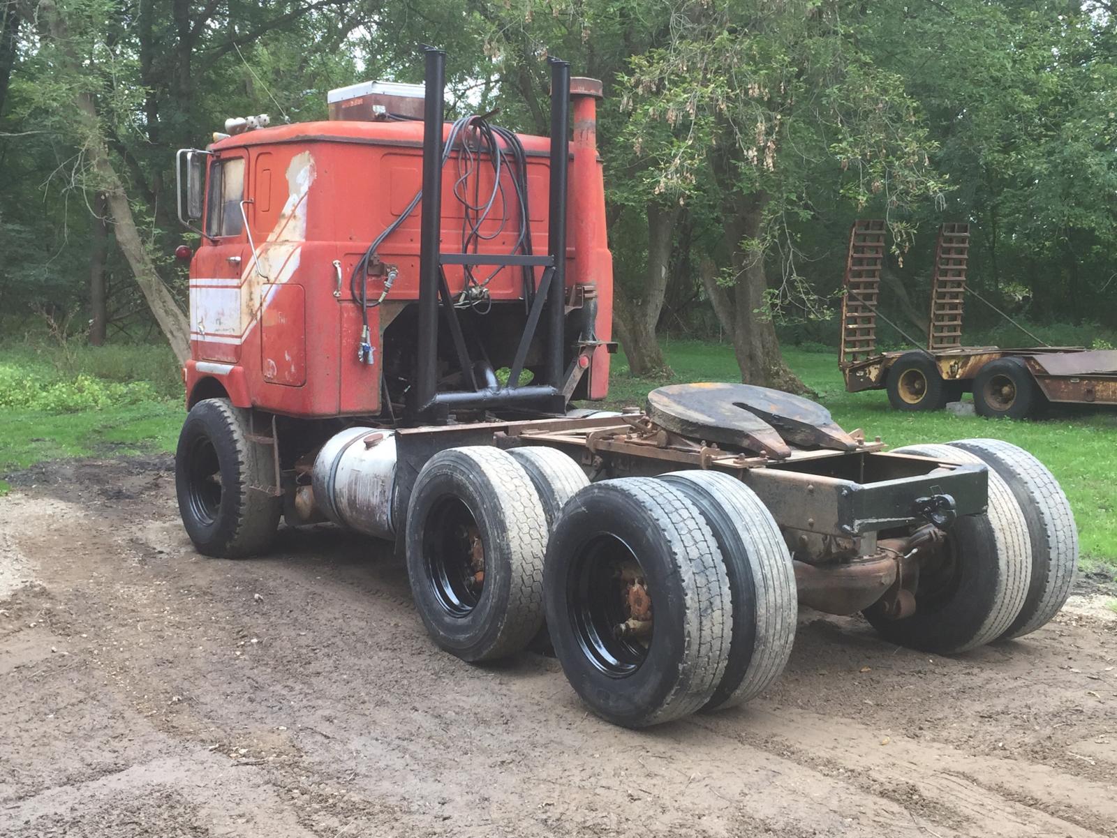

My first set of rims didn't have enough off set and hit the tie rod end. Then up popped a set of six with 385/65r22.5 tires on craigslist. It turns out it is 3 pairs each with a different offset. So now I had a choice and I chose the most offset (something like 5.5" from outside of rim to clamp ring) so I could have a "step" of sorts with the tire. Got them mounted up and clears everything by at least 2 inches. I'll have to wait to see how it drives till I get my oil lines replaced.
Anyone know of any downside/ dangers with running this set up?
