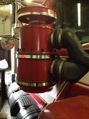

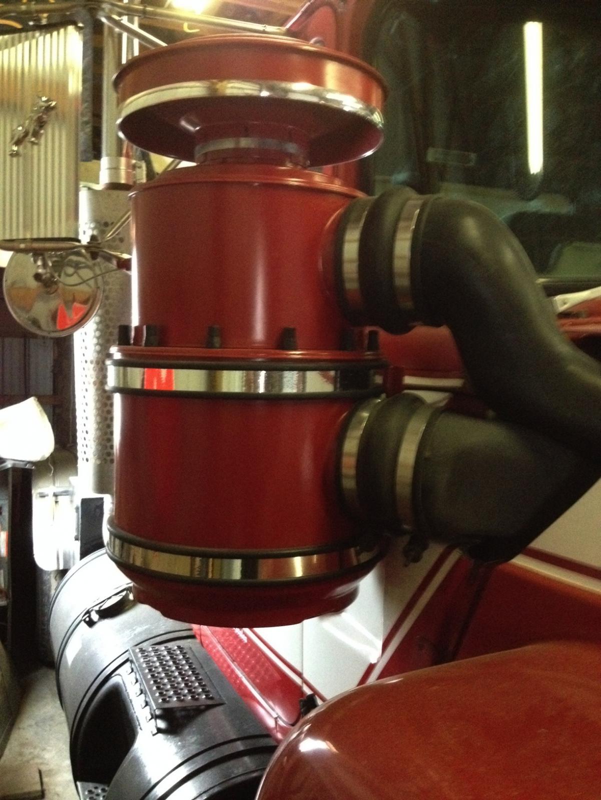

Here's a pic of my air cleaner diggn, hope it helps
Keith
