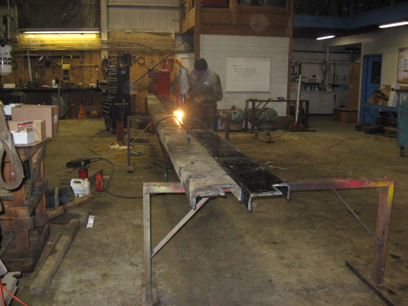

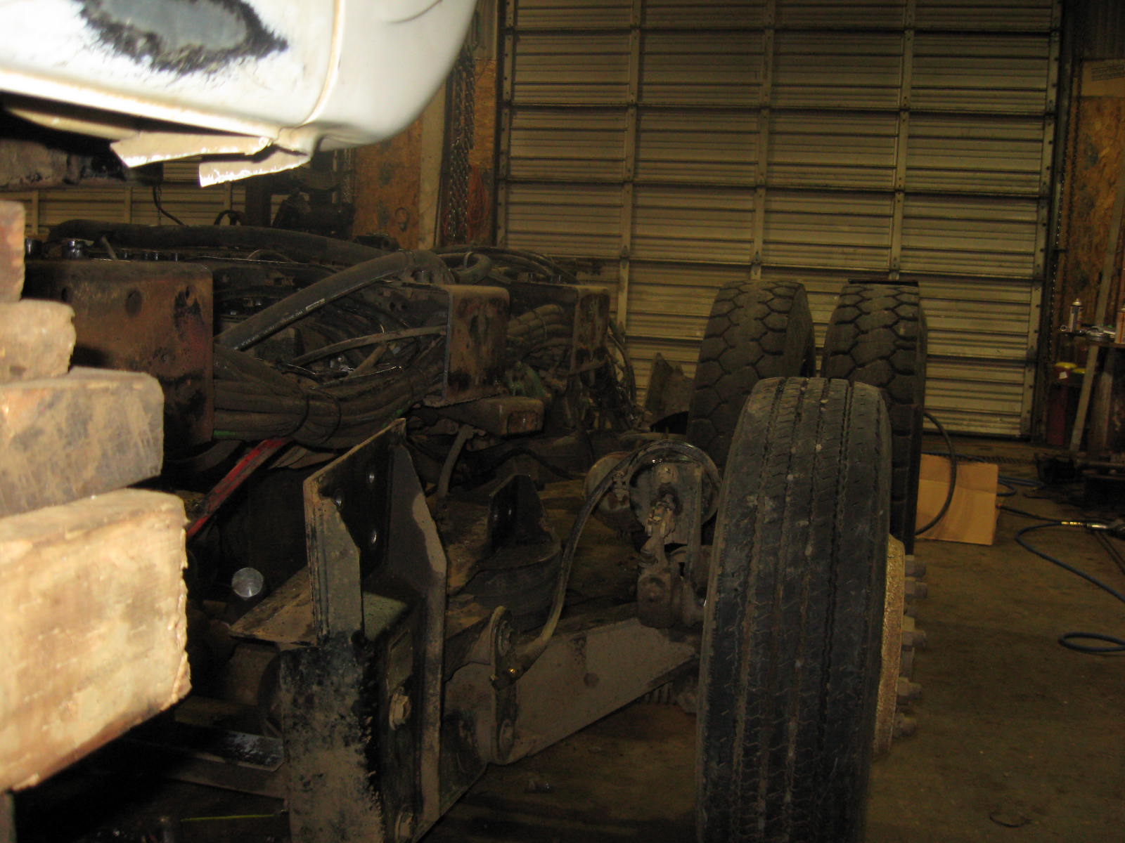

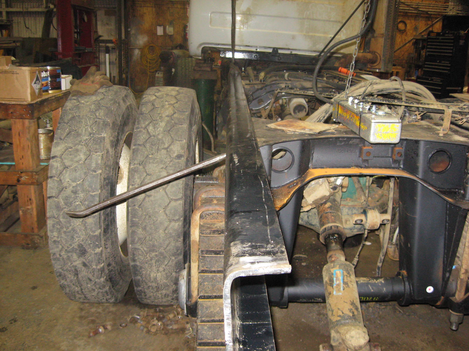

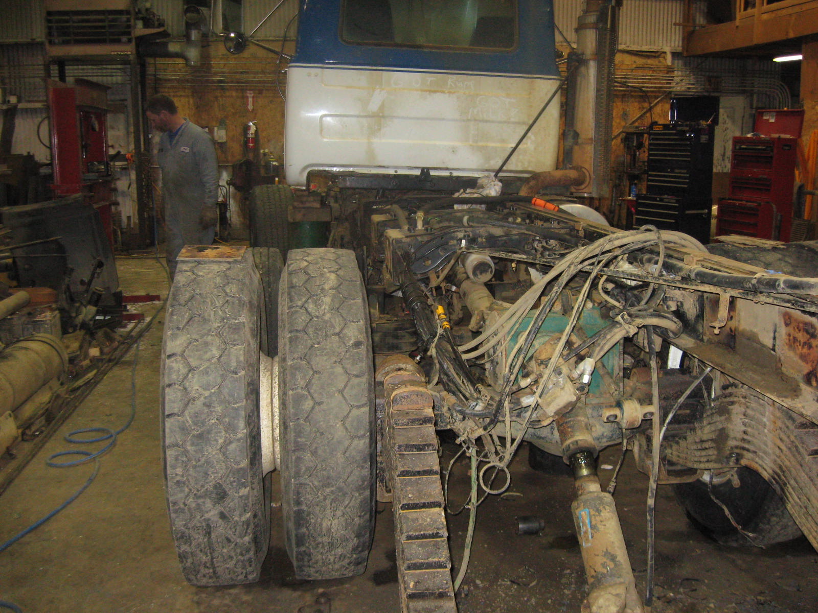

Yes it is a big job not only in weight, but also the amount of hours spent getting everything to stay in place while it's support is removed. How about the amount of time it takes to get the holes drilled to locate the crossmembers properly? A mag drill is essential for this operation.
Progress looks good at this point in pictures!
Rob
frames are single 3/8,they are set up as 4 axle dumps, used in biulding of log roads. I have not been around these paticular trucks all there life
but I believed they were overloaded on a regular basis.
replacement rails are Mack rails pre drilled to back of cab.
