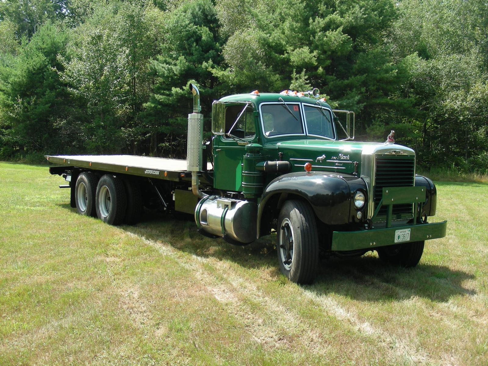

Here is my B75 which may be done someday.
That rollback is badass!
