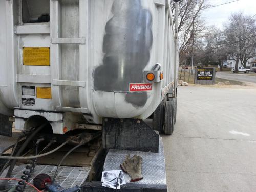

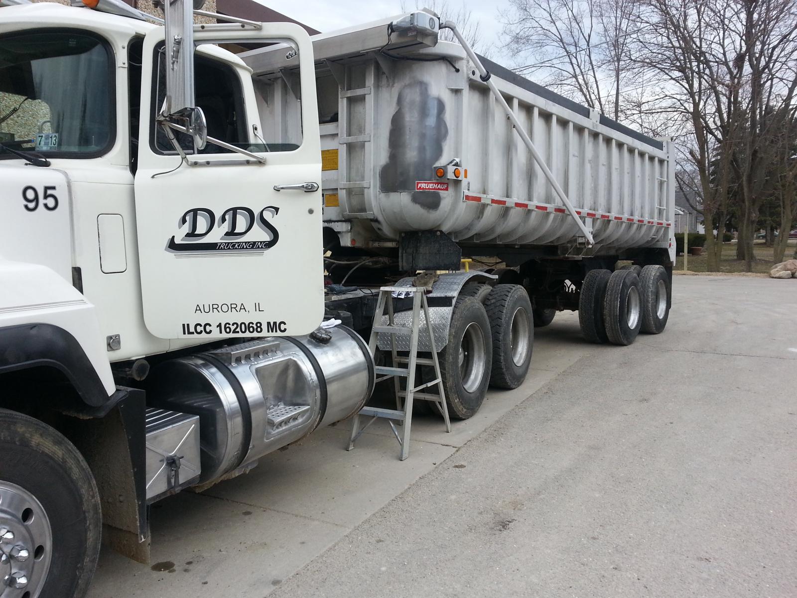

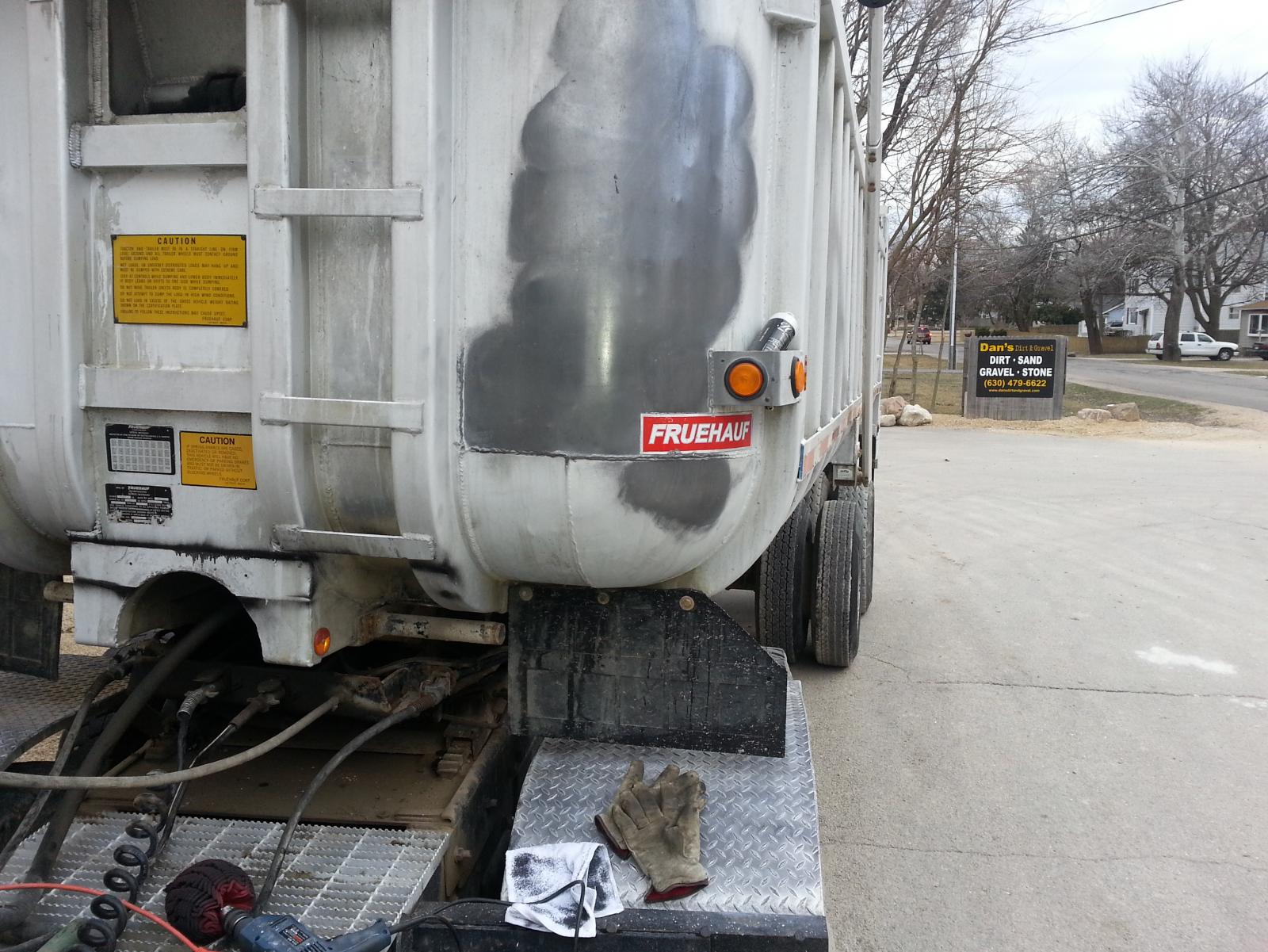

Ok so here is the thing. I had my trailer acid washed and i don't prefer the white color. I am not looking for a blinding shiny trailer going down the road but i think that a mild polish would make it look more gray and better. I need all your opinions if this is even worth my time. probably 100 hours lol. I am going to get the trailer acid washed again today for a final finish though, the first one couldnt get all the old dirt and marks off but did a decent job. I heard that if you just let it get dirty it will get gray again? Here are some pictueres of what we are dealing with here. any advice is appreciated. I am using hoosier polish, wiping it on with a cloth, rubbing it in a few circular motions, then using a buffing ball to make a decent shine, then using a clean terry cloth to remove residue, is how you do it? or for trailers am i best off just getting it painted aluminum / grey?
post-11750-0-54968300-1365256095_thumb.j This is just a section i started.
post-11750-0-31758900-1365256154_thumb.j

You need an actual buffer with a stick of jewelers rouge. Friend of mine did his hopper bottom last year. Think it took him
about two weeks to get it done at a couple hours a day. I think you could make it look pretty nice if you got the time.
Gonna be tough with all the ribs on the trailer. I wish you the best of luck.

That other one with the sloped nose is parked again, it is not mine and i was testing to see if i wanted to buy it from my dad. It is only 200 pounds lighter and isnt as reinforced as the 1980s tub one. That tub one is great!

I always wondered if there was some media you could blast aluminum it with to get a nice smooth consistent CLEAN aluminum look...walnut shells, baking soda?!?
no soda it will corrode faster, no real way to do it other than sanding, polishing with jewlers rouge and a cutting wheel , then hand polish to clean it up.
