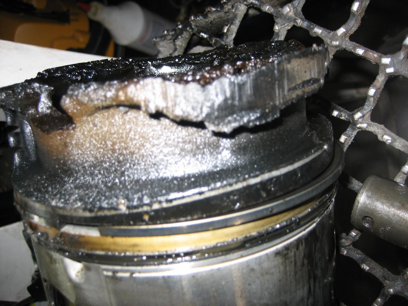

Sounds like the pump timing is off. Any time an injection pump has been removed it should be timed to the engine. The problem is, it sounds like some damage has been done. You stated the exhaust stack has turned blue., If it got hot enough to do that imagine the temps inside the cylinder. I have seen piston crowns melted within minutes on an engine with incorrect timing. Hopefully no damage has happened but I wouldn't hold my breath.
Do you mean something like this?

post-8482-0-20539600-1348405349_thumb.jp
