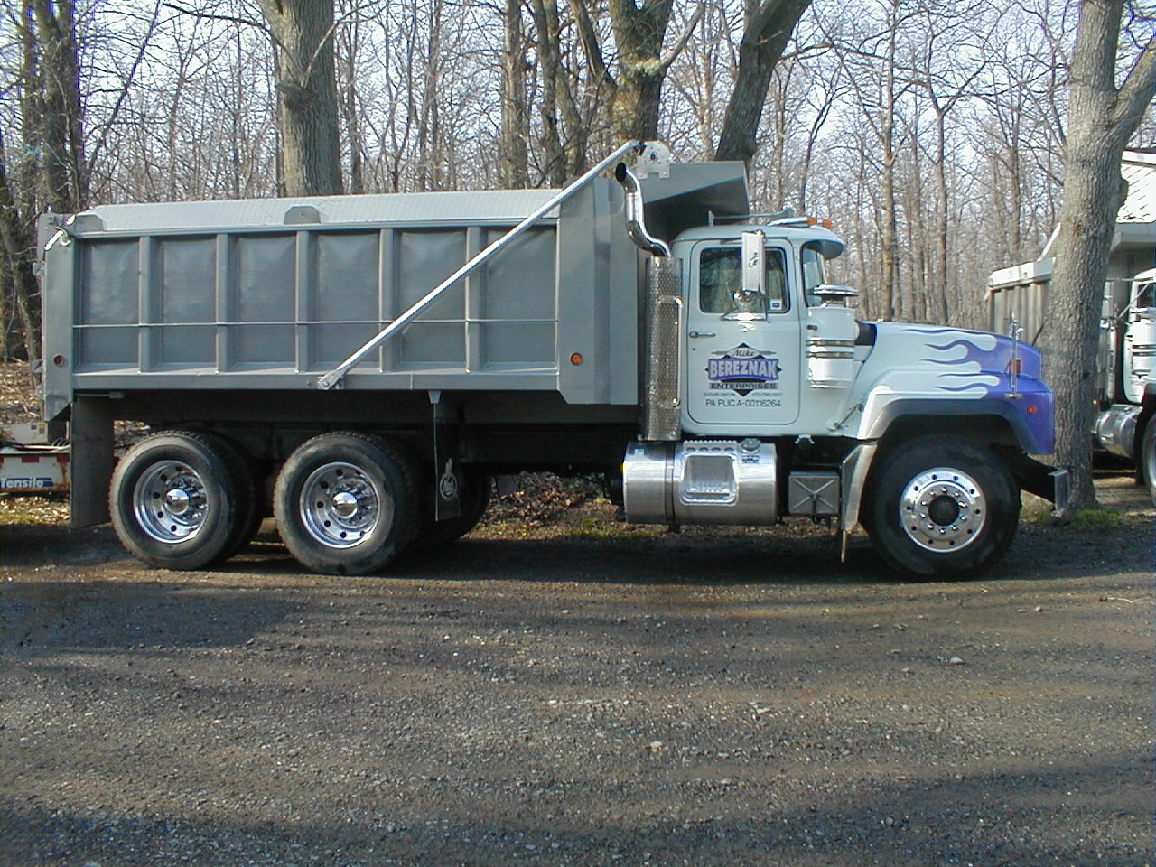

I tried jumping the plug on the radiator sensor. Thought that was it untill the end of the hill it derated and got code 7-2 do you know what this one is. I never got that code untill tonight. But as far as code 3-4 and 3-5 what are my options to solving the prothem there?

Code 34 is for timing event marker the one that srews into side of injection pump and 35 is the timing actuator or econovance the solinoid on top both are 2 wire sensors check the plugs first and then the main connection at firewall for corrosion have seen this alot ...good luck

I feel your pain on this-I have a 95 e7 400 that I was getting the same codes & engine derate. I was able to make the 3-4 go away by changing the sensor in the side of the pump, the 3-5 ended up being the ECM. If I had it to do all over again I would just bite the bullet and take it to Mack. I blew $500 on a new econovance solonoid trying to fix it myself, then the shop I took it to charged me their labor rate to throw parts at it themselves, they changed the timing sensor in the flywheel housing, rebuilt the actual econovance unit, and ultimately the ECM was the problem. Runs great now, but it was a complete nightmare! I wish you luck whatever you decide to do. ---Also I made the same mistake of thinking the 3-5 code was Jake Brake Solonoid instead of Timing Acutator, guess you cant believe everything you read on the internet.
I did the change over on my 94 RD. Changed the pump, got rid of the econovance, changed the fuel lines because the pump is in a different location now. Told the pump shop what I was doing. I wanted big power so they turned up the pump, put super flow injectors in it and replaced the turbo with a rebuilt 427 one. They told my they where getting 490HP from this set-up. I did a cab change on my truck because of a fire and replaced it with a cab that was mechanical. I changed the wire harness under the hood along with all the sensors for the motor, which are not many but including the tach sensor in the bellhousing. The timing get set by the book for a mechanical motors.

Code 35 on my 94 ch600 was the econovance solenoid. Took it to Mack that night and was back to work the very next day. Yeah it cost $1,000 but it saves me ALOT of headaches by just bringing it to the dealer and having a guy work on it who knows these trucks inside and out. Mine has 970,000mi and 32,000hrs and is still a very reliable truck.

FYI the timing event sensor the one on the side of injection pump does not get adjusted you srew it in till in stops then tighten jam nut if you have a multimeter from one pin to the other should be 100-500 ohms also check from pin a to ground in sensor is grounding replace, Have you had any water leaking into cab above module somtimes the windshield gasket let water in and dip onto module.

, we;ve thrown parts at it according to the codes. since i switched out the fic and ecm i'm only down to one code which is 3-5, which i can only think the injection pump is worn inside, thats could be screwing up the timing, as the truck has 475k on it and i don't think the pump has ever been off.

is that sensor supposed to be bottomed out or will the threads make it stop where its supposed to be? cab is as dry as a bone.. havent had much rain ether. Edited by 24vman

I highly doubt you need a new pump. You said yourself the truck runs fine until it goes into de-rate mode. I would almost bet it needs a new Econovance solenoid. We have had two mid-nineties CH's this past year have the EXACT same symptoms as your truck, same code 35 (timing actuator), and both were fixed by replacing the Econovance. It is that box at the front/top of the pump with the round solenoid and two wires sticking out the side of it.
