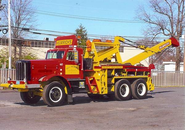

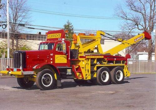

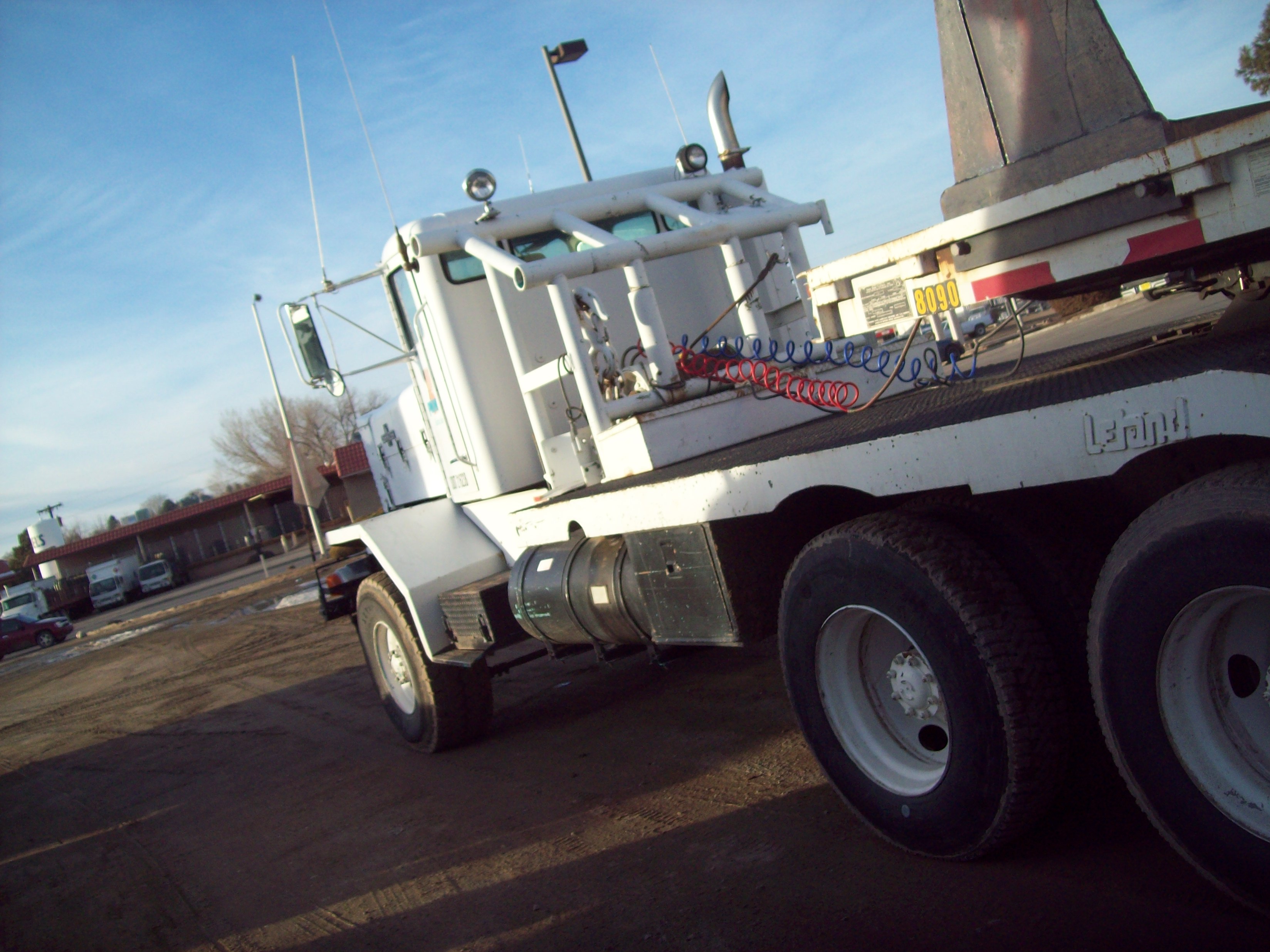

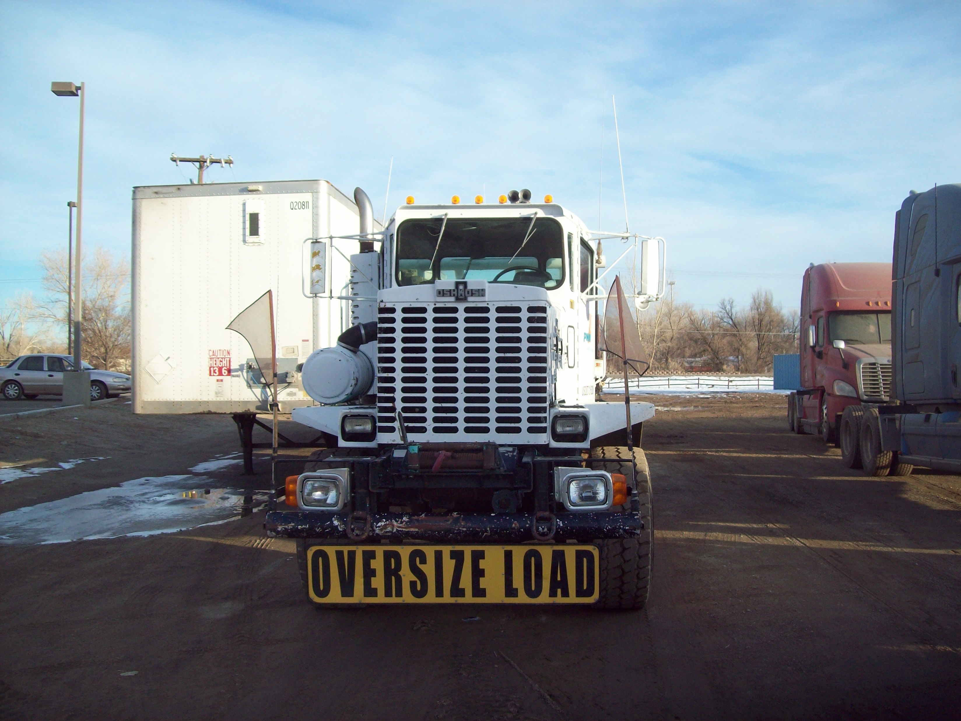

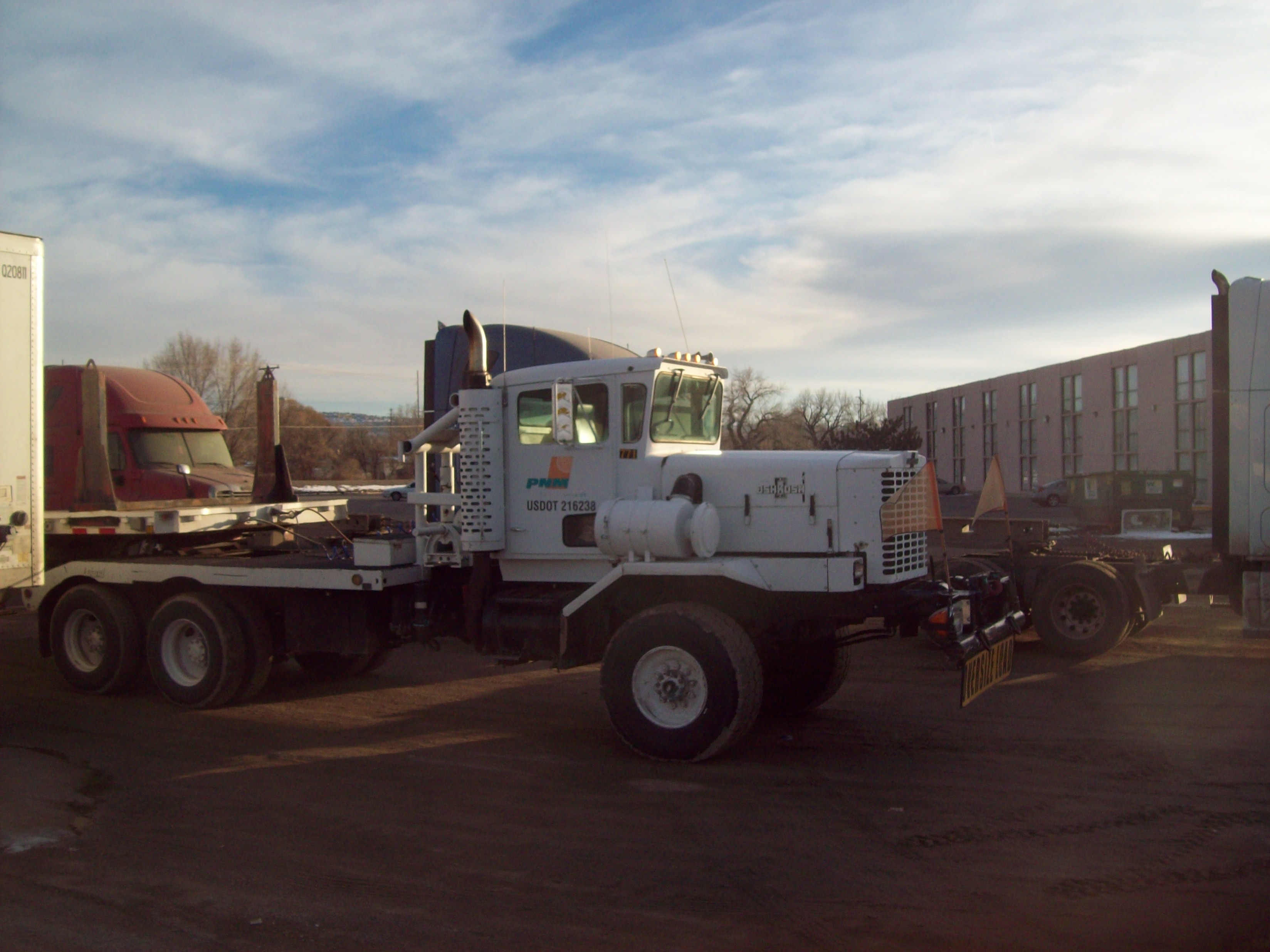

Saw this Oshkosh this afternoon. Monstrous looking truck, not sure what engine it had in it.

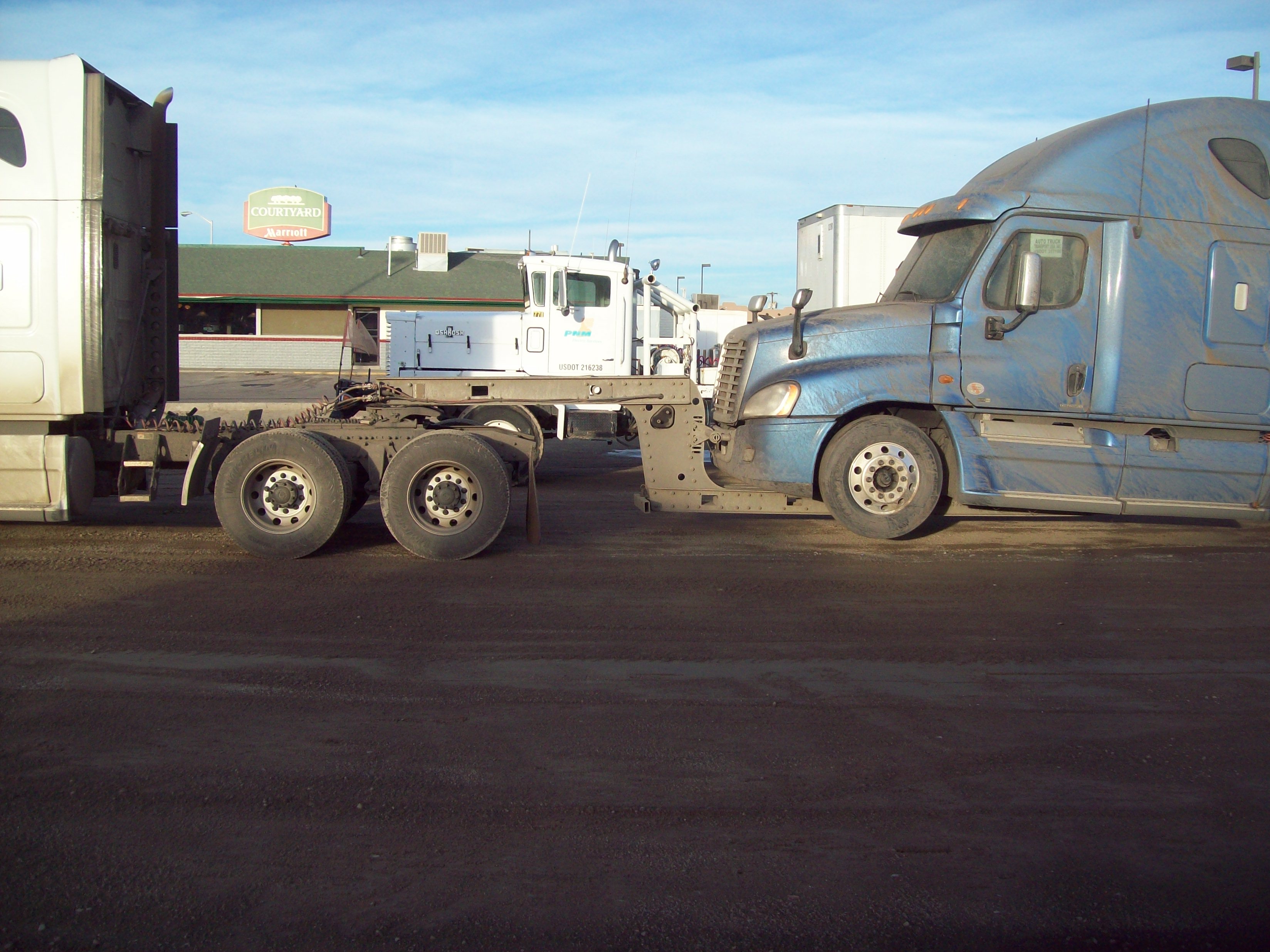

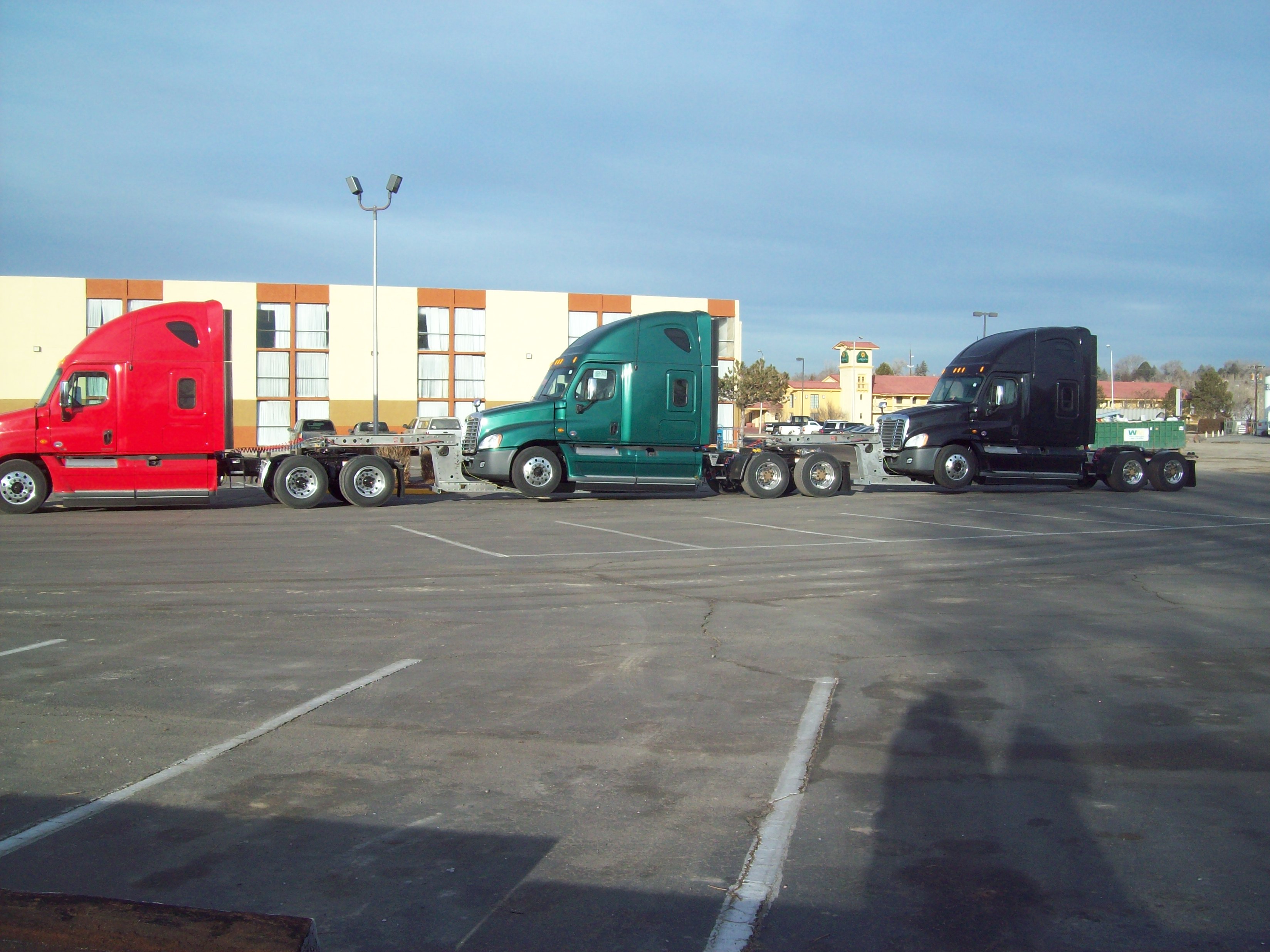

Also saw these new Freightliners in transit. I don't remember ever seeing trucks delivered in this way. Mack, and even the volvos I've seen are decked on top of each other.
post-6084-0-64306400-1295138436_thumb.jp
If they decked those condos they would probably be over height. I would guess they follow up with a flatbed and collect the goosenecks and use them again. Then again they might keep them at the dealers so they can go pick up their dead Freightshakers and drag them back in.
Or redistribute temporarily repaired Peterbilts.........
Rob
My first guess was along the lines that they were trying to avoid body damage caused during undecking, but aftter thinking about it I realized that the trucks should be able to lower the air bags, disengage the gooseneck, and drive the truck off. The advantage to this is that there wouldn't be any special equipment needed to load and unload trucks. Usually when we get trucks in they have to be undecked with a wrecker or crane truck, and in a lot of cases the truck that is staying is the middle truck, which means more loading and unloading. Even with the procedure that Mack uses the equipment used to couple the trucks together has to be picked up later on or is shipped back.
I've never seen trucks towed like this,most of the ones i see now are still decked,but i also see a lot of those truck/trailer thingamabobs where 2 trucks are connected with a small single axle trailer with kingpins at both ends,so both fifthwheels are used to attach the tractors,and there is usually a pickup riding on the trailer which i assume can later be used to tow the trailer after delivery of the trucks. Always thought it was a pretty ingenious idea,but does limit the transport to 2 trucks at a time.......Mark
never seen that kind of hitch but if you can remove the towed trucks without the need of a machine that would be faster and you could drop it anywhere.
that Oshkosh looks like the fleet of Cement trucks that Meyer ran in the 90s. I think they still have a few left. Strong runners and put their DMM macks on a level playing field. I always thought they would be a PITA to see out of with the big hood and sitting that high up? I can rember seeing them all day long near my house.

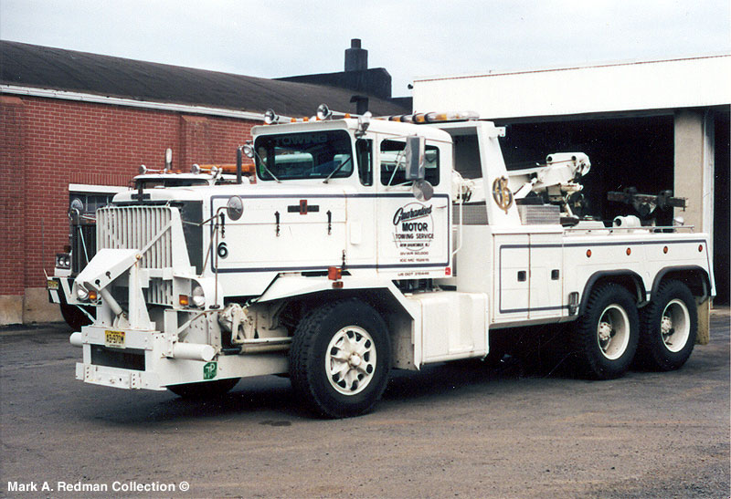

I remember a few towing outfits in jersey that had trucks like this,my cousin (Helmrich towing) had an older one (1960) ex-navy heavy recovery and Guaranteed up in north jersey had one similar,which i believe was sold to High point garage up in union,NJ................

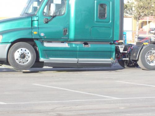

Here's another of the Freightliners in transit.

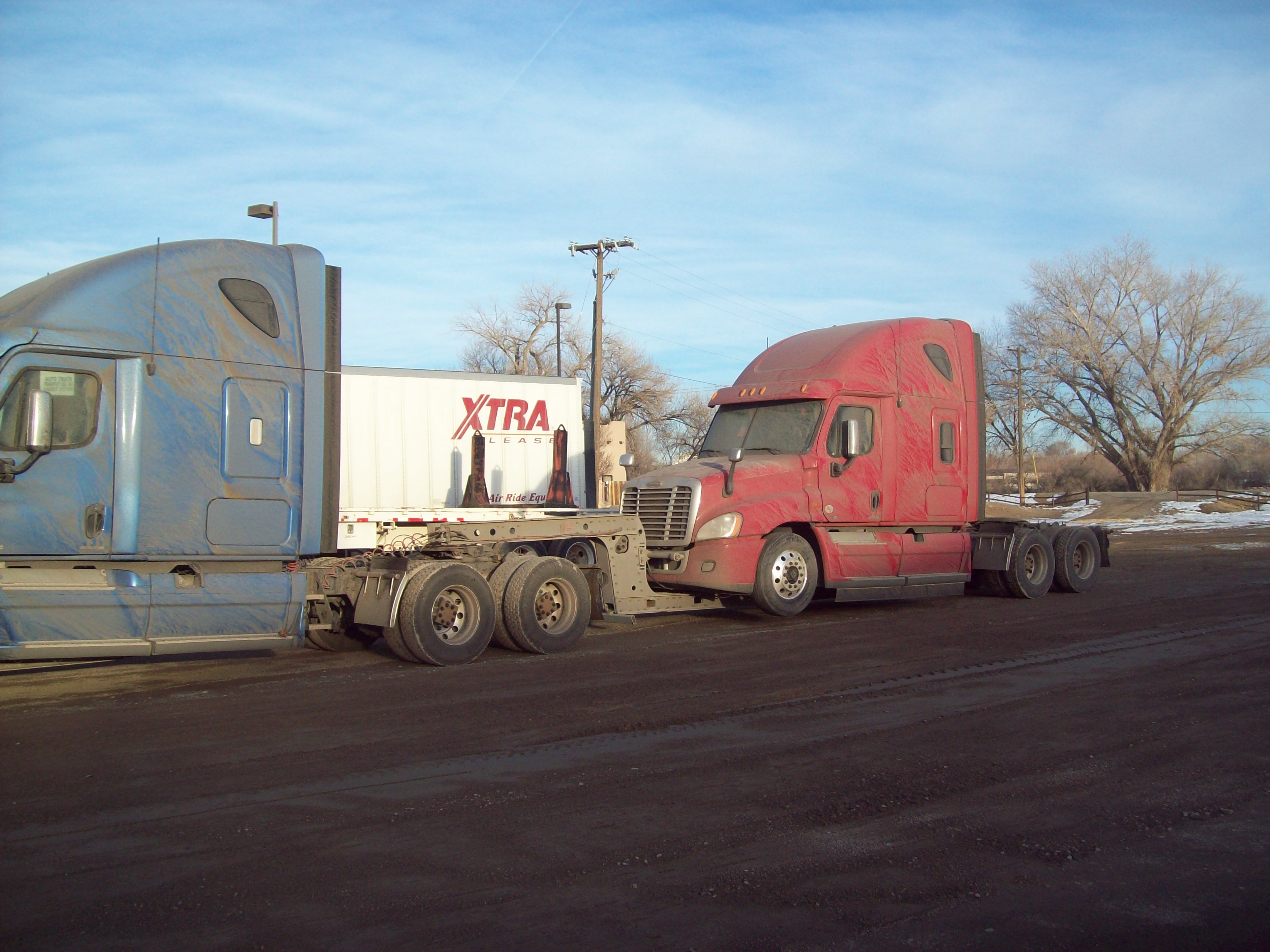

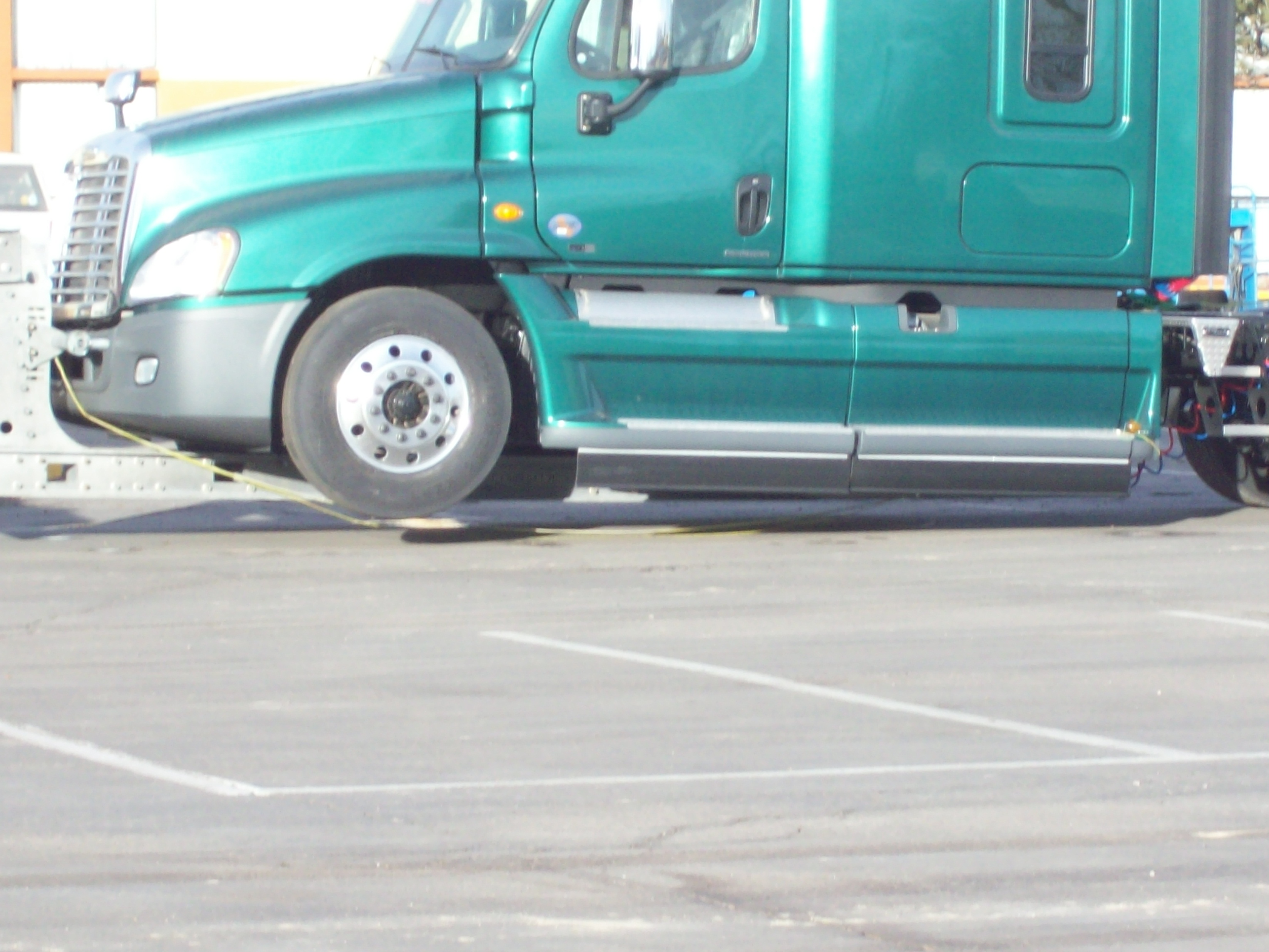

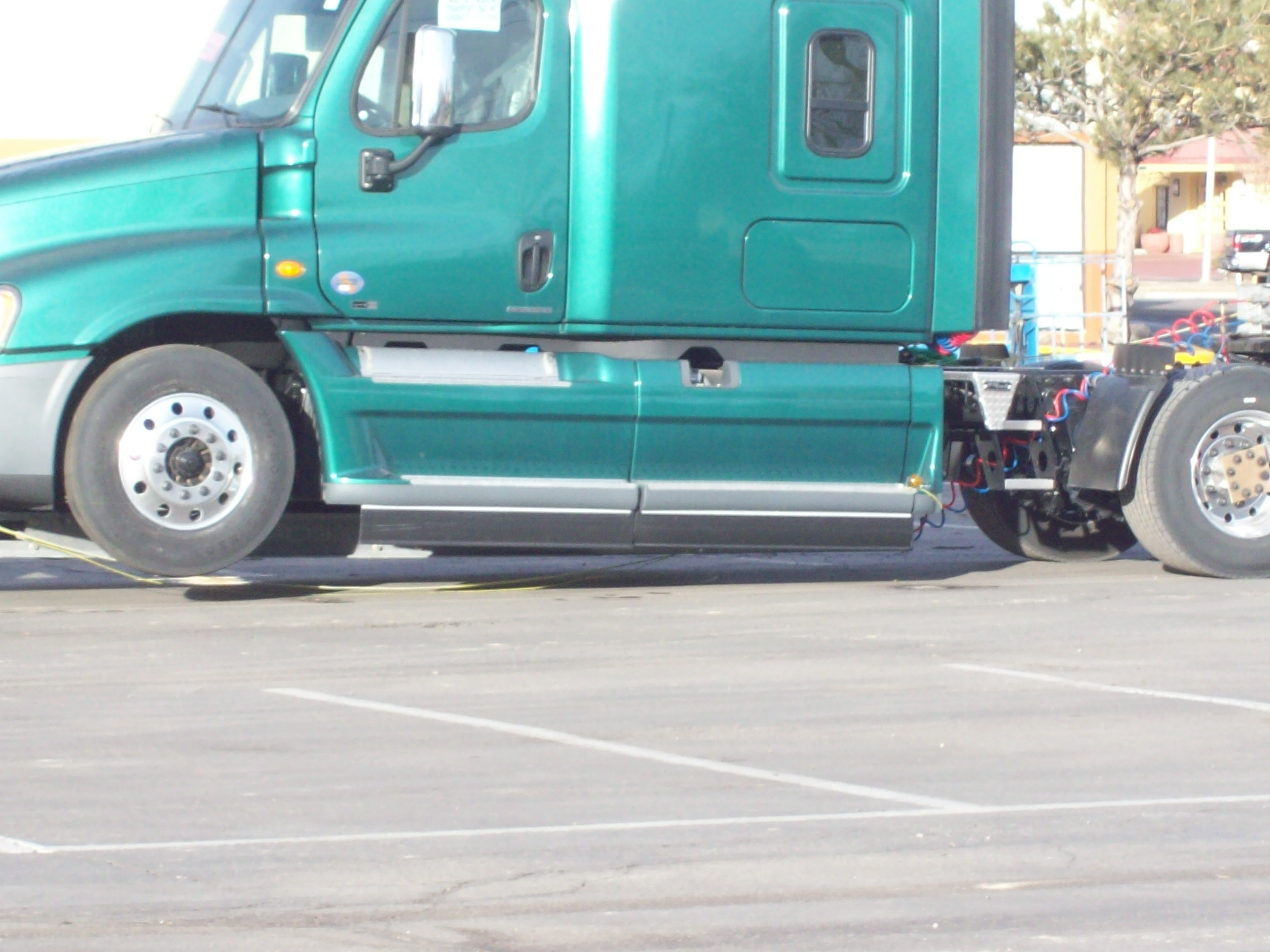

Saw some more of these today. One truck pulling, two behind it on these little gooseneck trailers. The pull truck had the engine running at an idle and consequently shutdown (I imagine due to the clean idle system) when I walked by. The driver strolled up and restarted the engine and set the idle speed up, sounded like crap, almost like a miss in the engine. I suppose it had a DD15 in it, do they normally sound like that? I know the '07 MP engines rattle and make a bunch of weird noise. Anyway, I started to ask the driver what the deal was with the trailers but he had an air of aloofness about him. Guess I would too if I had one a them snazzy hands free cell phone headsets, a pair of Bufford T Justice sunglasses, and a load of Freightliners to deliver! I left him alone figuring that if his lead truck broke down it probably wouldn't be much work for him to unload the rearmost truck and use it to pull the other two.
post-6084-0-49573000-1296410681_thumb.jp
post-6084-0-85691700-1296410716_thumb.jp
post-6084-0-00236800-1296410763_thumb.jp
By the way, it looked like the trailers were unpainted. It also looked like the platform section of the trailers ran all the way back behind the cab but I still couldn't see what they were attached to.
These "tow bars" have a box beam construction under the truck that extends. A vertical chain then runs up and around the frame on a saddle and back down to the bar which is then bound up tight. If you look at the front of the tractor you see a lifting bar that attaches to the front tow hooks of the tractor. This is a cantilever type operation and does not slip. Once hooked up, the pulling unit is backed under the affair and everthing lifts clear of the ground. These work great if there is no way to either load or unload "piggyback" style. I've also seen this setup using saddles that lift by the steer axle beam. These do require a removable axel for the rear to tow the unit if not attached to a truck.
That looks like a piece called a Tru-Hitch. It is a nice unit because it puts the towed unit weight on the 5th wheel where it belongs, not a pivot point behind the truck. I've seen pics in towing magazines of twin screw tractors picking up cement mixers and trash trucks without being overweight or too light in the front end.

I talked to one of the Mack delivery drivers (works for Iron Tiger I think) and he said that setup is kind of a pain in the ass. I would imagine that it's cheaper in the long run once the initial outlay of funds is recovered. He said there's some kind of a saddle up in the frame rail but I haven't seen any of these lately so I haven't got any new/better pictures of them.
Yup I was going to say the same thing too, tru-hitch. Basically it works like an underlift, the front wheels/steer axle rests on the front of the boom close to the goose neck. Then at the rear of the boom there are clevises that you chain to the frame rails. So when you lift the goose neck, the boom lifts the front wheels but the rear of the boom wants to stay put on the ground since the 5th wheel is a hinge. So the chains tied around the frame rails start to lift the rear of the boom and now you have converted the truck/tractor into a trailer. The weight actually goes on the pin instead of creating a see-saw effect like that of a regular wrecker.
