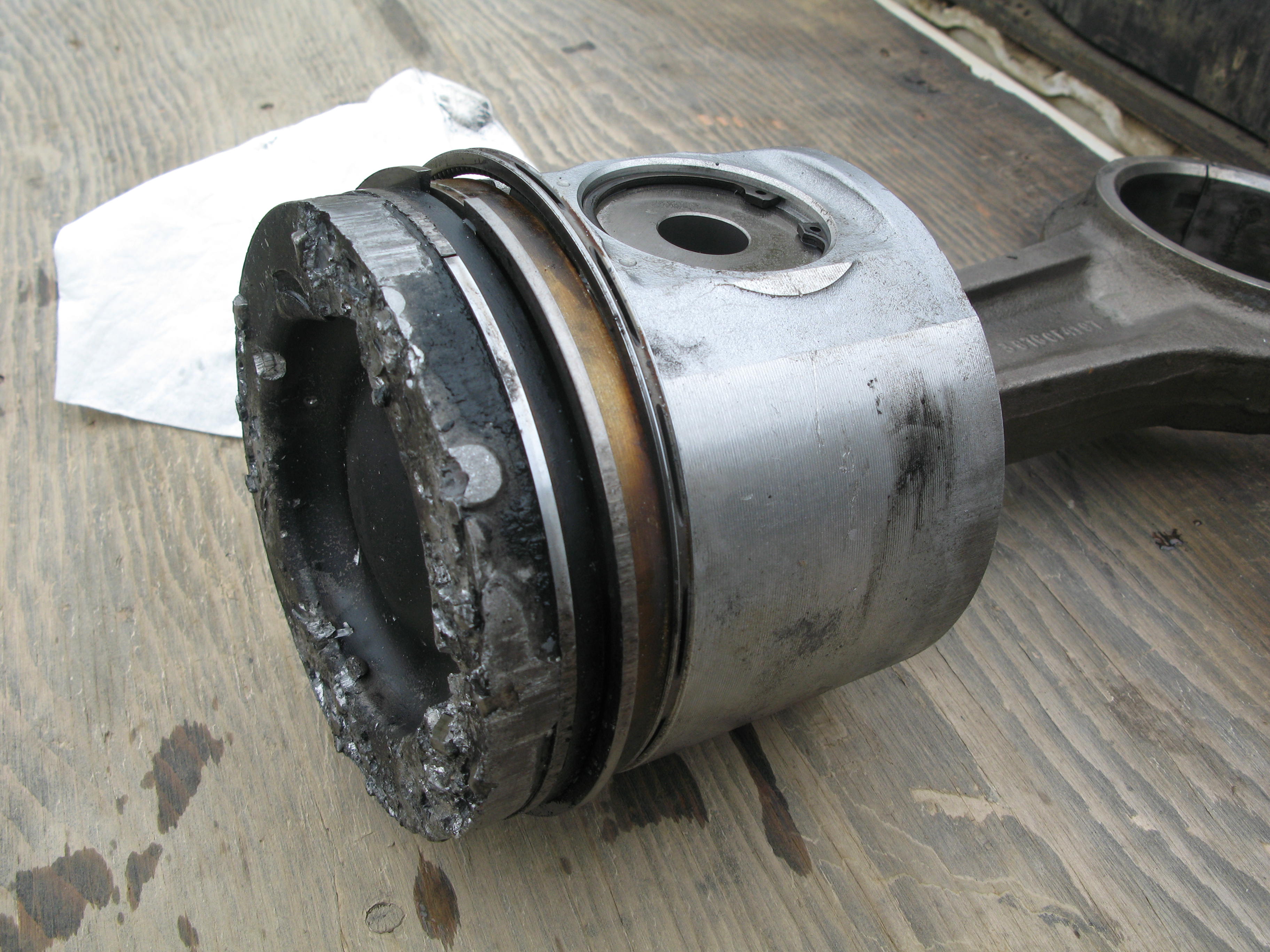

Hello.
We have a 1980 superliner mack with a e9 v-8 engine. It developed a knock in the engine, with oil or diesel fuel running out the exhaust manifold. We took the injector line of to number 8 cylinder and it smoothened right out. Thinking it was a bad injector, we numbered and took them all out and down to the injection shop. They say their is nothing wrong with it and it appears to be a new one.
Does anyone have any suggestions. We are going to put the injectors back in, after they get cleaned up and see. The valve springs don't appear to be broken.
Should we take the pan off or take the head off.
Any suggestions would be appreciated.
Thanks
Byron

You likly have a droped valve seat!This usually happens when the engine is shut down ,next time the engine is started it begins to knock! more of a hammering sound! Pull the head off and look!you will likly need to replace the piston, liner Maybe , and head .
and turbo if ths is what you find!

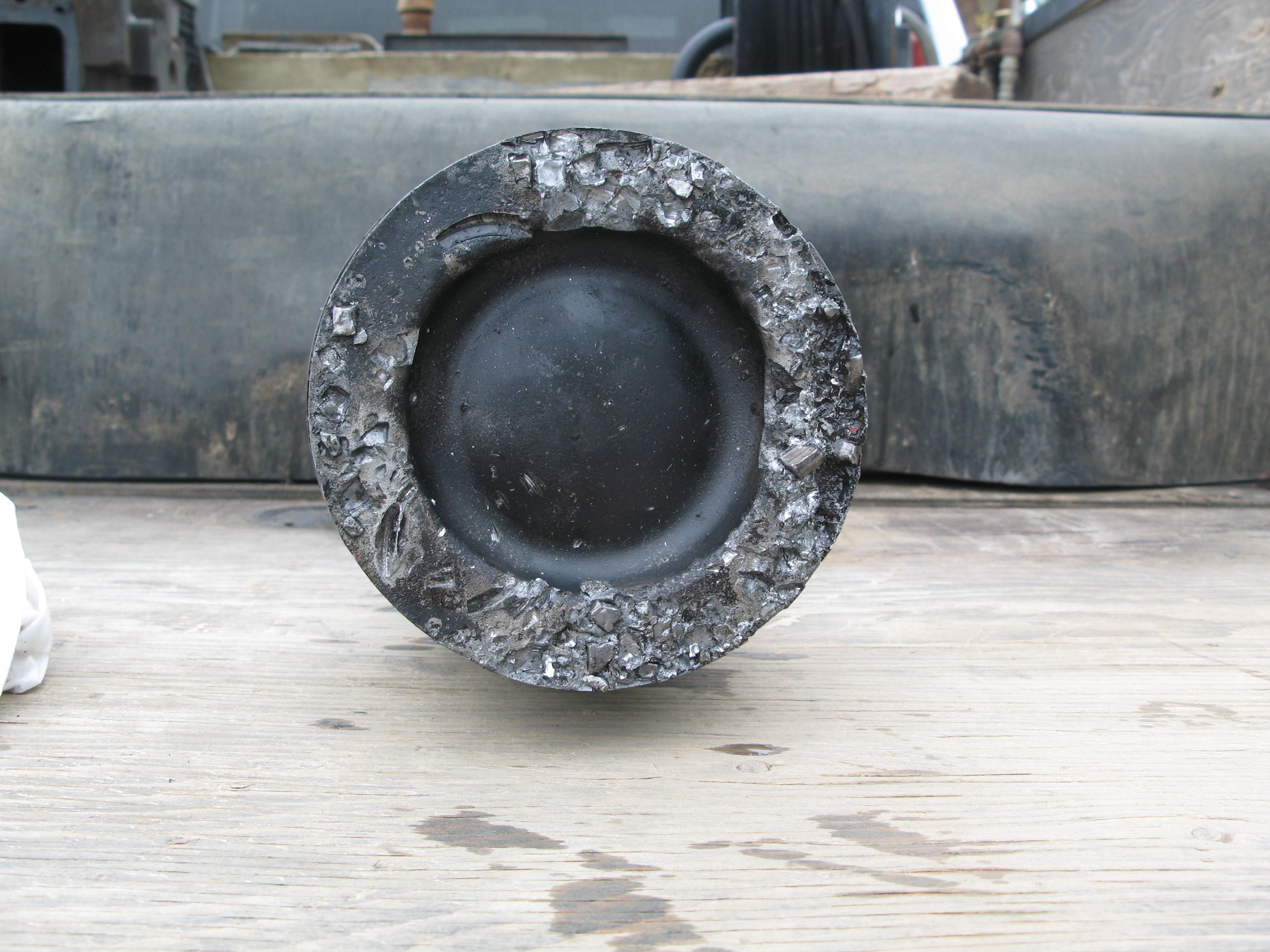

Ya the liner is also scored. Hopefully we can find some good used parts.
That engine ran awhile like that !!!! Be sure to look at the turbo and back blow the exhast tube.The turbo wheel likly has hunks out of it as well.B sure to take the engine serial #no with you when buying orings for the liners three up dates happened a white dot oring was the most common The parts guys Should be able to direct you on that BUT Some arent to bright, If you buy a liner kit It usually comes with the TSB!If your going used post the ser #no here and we will be able to dig up the info.Serial no is stamped RH front of the block near the pan.If it has ac its under the ac bracket!
It looks like there was plenty of valve/piston contact. You might want to check the rod and make sure it isn't bent.

The combine had just filled the semi trailer. I started the truck and it sounded different. We idled the truck home,which was about 1/2 mile to get it unloaded. I never reved it over 700 rpm. In hind sight I should have just shut it down, but the damage may have already been done. The thought of docking a fully loaded grain trailer in a soft field isn't great either.
The turbo turns over good with no signs of damage. I did empty the shop vac out and then sucked on the exhaust side of the turbo. I did recover a small chunk of valve seat, about a 1/4 of a inch.

Usually this dosent bend the rod !But a good check, Also Post a picture of the liner when ya get time!Don't pull it yet! If its just a farm truck to haul from the feild to the barn you might want to just fuss up the liner with a hone and slam a used piston and head on.

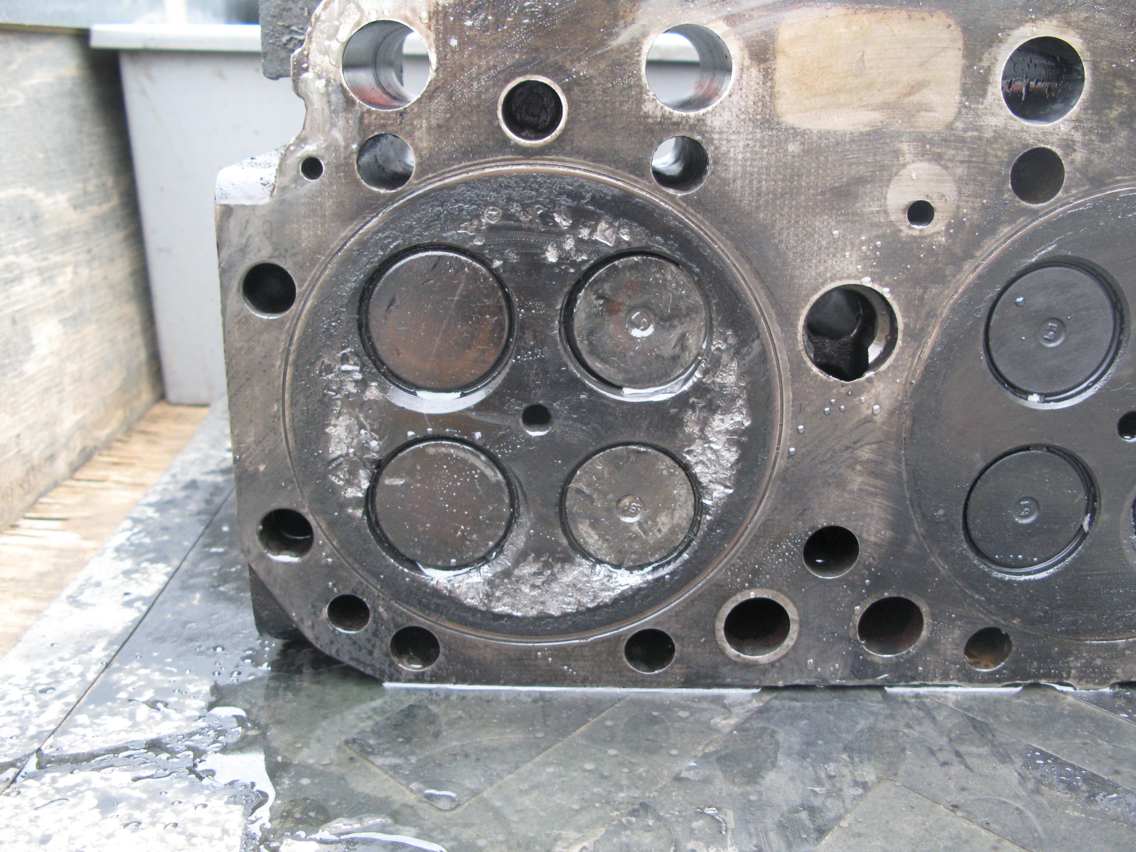

I went to the valve repair shop. They figured they could repair the head. After looking at it and magna fluxing it he found a crack between the two valves. The enginge must have got hot(not on us)and cracked the valve seat. Or the injection tube leaked and caused it.
Does anyone have a used head out there ?

Hi Byron, I think it may be prudent to pull the other three heads from the engine for evaluation before expending the funds to acquire another used one, and possibly finding out later underlying problems. Head gaskets are cheap and if the other heads are good, a valve job is cheap insurance at this point. I don't have an E9 series of V8 Mack engine but several of the ENDT865, and 866 series so I'm a bit partial to the layout.

The engine must have got hot(not on us)and cracked the valve seat. (NOPE its was a fairly comon thing ) Just happens!
and usually the same way every time shut the engine off everything is fine ,Start the engine up Bang Bang Bang!
anyway .As Glenn pointed out ,you do have 3 more heads to possibly do, But if you need a good runner we have a few!
