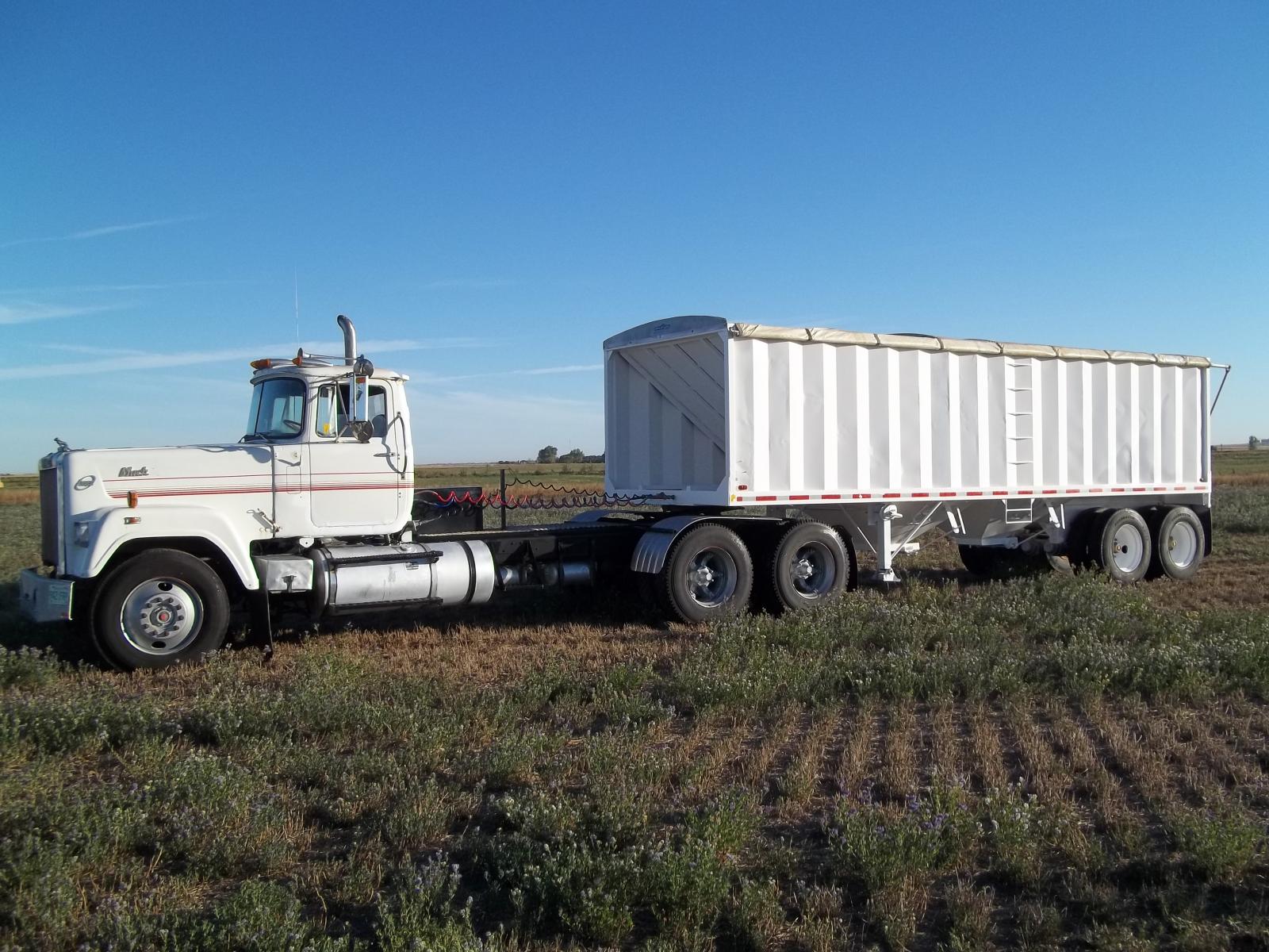

  6. Hello all I went to the valve repair shop. They figured they could repair the head. After looking at it and magna fluxing it he found a crack between the two valves. The enginge must have got hot(not on us)and cracked the valve seat. Or the injection tube leaked and caused it. Does anyone have a used head out there ? The truck model number is: RWS721LST serial number is: 1M1V121Y8BH054234 engine number is: EM9-400 It is a 1980 SuperLiner. Can't seem to find any in Saskatchewan. We live north of where Montana and North Dakota meet. Its too good of a old truck just to park. Cheers Byron Skjerdal
  7. Hello. The combine had just filled the semi trailer. I started the truck and it sounded different. We idled the truck home,which was about 1/2 mile to get it unloaded. I never reved it over 700 rpm. In hind sight I should have just shut it down, but the damage may have already been done. The thought of docking a fully loaded grain trailer in a soft field isn't great either. The turbo turns over good with no signs of damage. I did empty the shop vac out and then sucked on the exhaust side of the turbo. I did recover a small chunk of valve seat, about a 1/4 of a inch. Thanks for all the advice. Will keep u guys posted as we go forward. Cheers Byron
