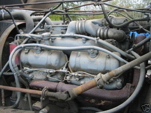

Superdog; Yes that is the motor!! I GOOGLED Cat 1676 and got some good feed back even one guy calling it ( THE GHOST IN CATS CLOSET) another guy confirming what i remembered Cat doing and that was replacing them with 1693 and 1674's even had a picture of one!!
Ernie
