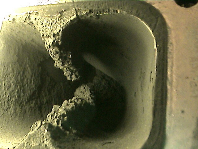

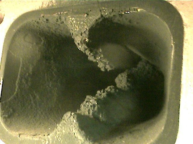

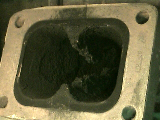

I pulled the turbo off the manafold and found the intire center separtor wall of the exhaust snail was deteriorated and missing!!. I could clearly see the back of the turbine blades LOL. i think that would explain the issue with low boost .
I put the "new used" turbo on and I can now get 15 psi at 1100RPM and a full 25 psi at 1900RPM :thumb: She pulls like never before and EGT temps are very low at cruise.
