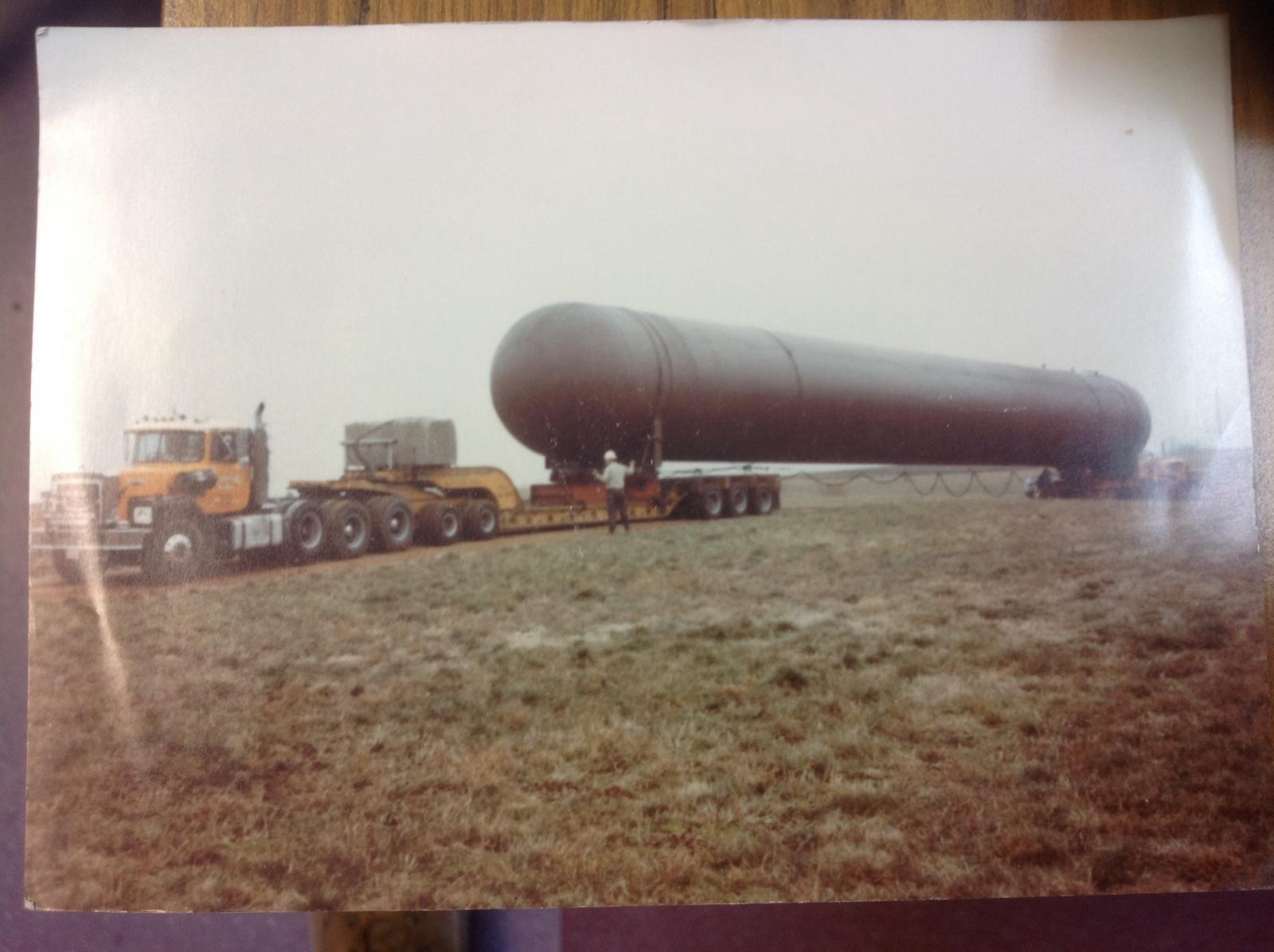

Here is a pic of the McCord 761 that Tackaberrys now own. This was taken before the red paint was applied. It spent most of its' life yellow and black.
