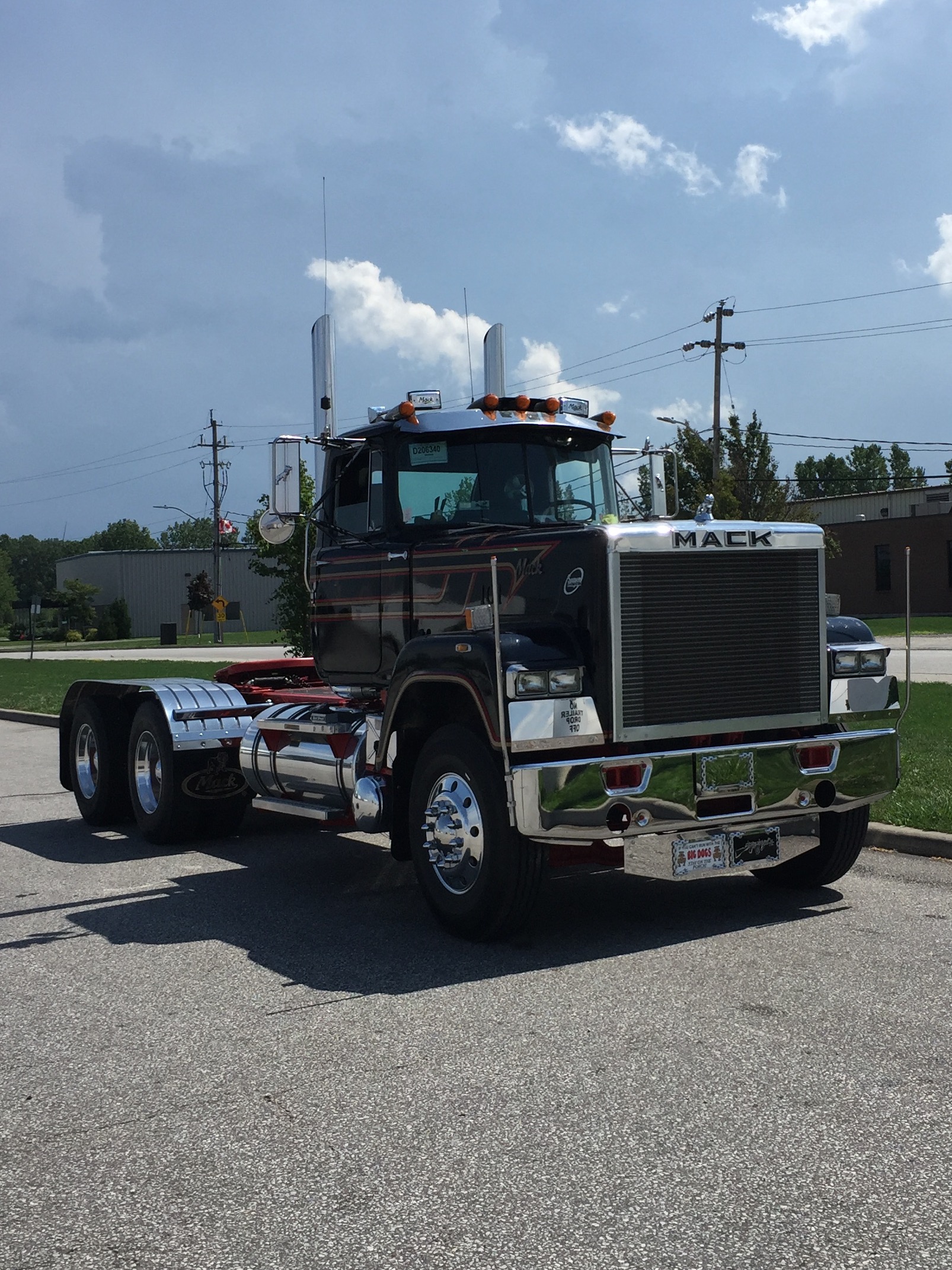

  16. Looking for you guys opinion on this. My Superliner is a glider originally it had an 866 V-8 with a 12-spd and 4:17 rears on 11R24.5 rubber. When I rebuilt it after the accident, I put my E9 in it with a 15-spd Fuller and newer Eaton rears on hub piloted wheels 3:90 on 11R 22.5 rubber. Used to run 68 MPH at 2100rpm before. Now with this drive line, I do 68 MPH at 1700 rpm. I'm thinking this 15-spd is an overdrive. I know the 12-spd was a direct. The 15-spd is giving me grief. I think it might have got done in when it was towed with the driveshaft still hooked up? It's extremely sluggish going from lo to hi range and worse from hi to lo and has something not right with 4th gear. It doesn't slide in like it should I have a line on a couple of newer 12-spd overs. I'm thinking of switching. What do you guys think before I go trying one and cutting down a perfectly fine driveshaft? If not I was thinking of a 13-spd Fuller since I have the bell housing for the Fuller already. I'm kinda looking for something with a shorter space between top gears and I know the 12-spd will be similar to the 15-spd. Plus it's only a hobby truck so I'm not going to spend a fortune. I doubt the 15-spd I have would be a cheap fix. What do you guys think?
