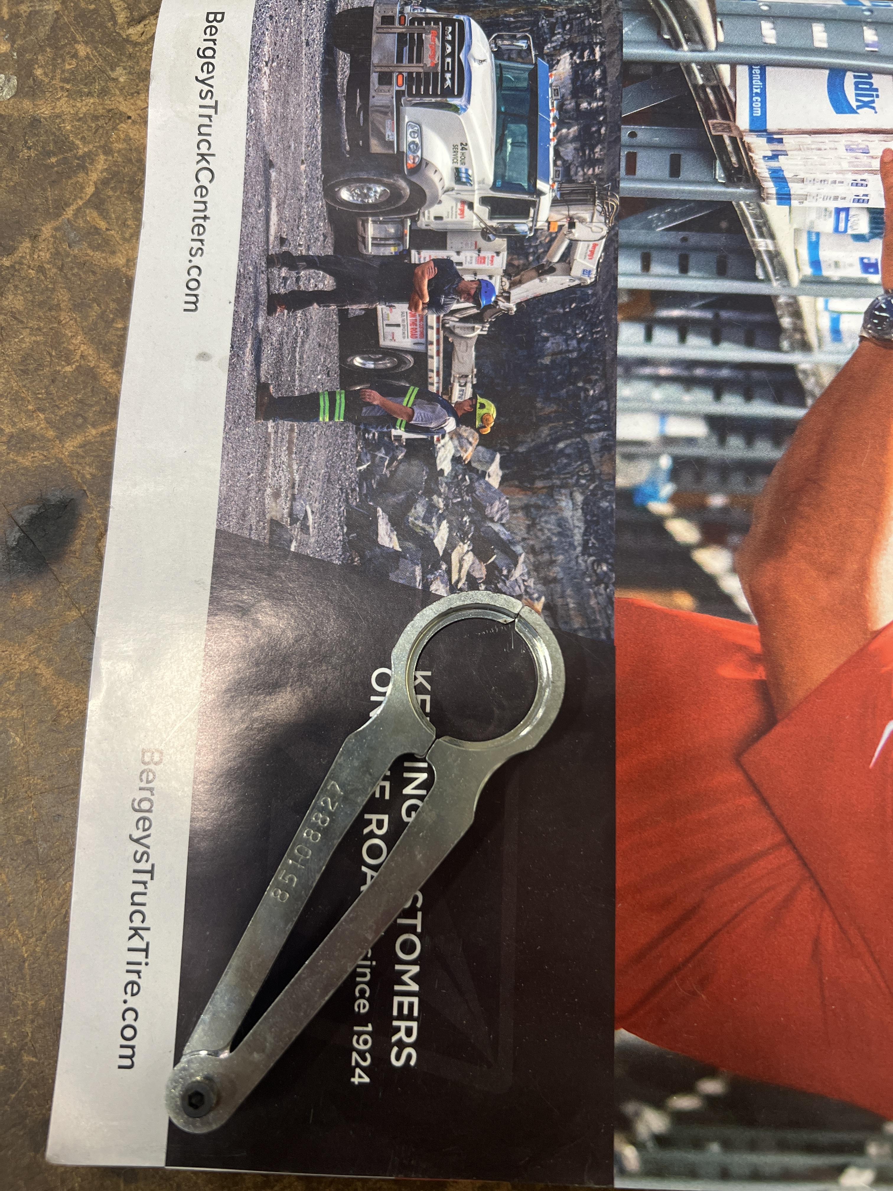

  12. 85108827 transmission cooler line release tool for 18mm europower fitting. Mack/Volvo
