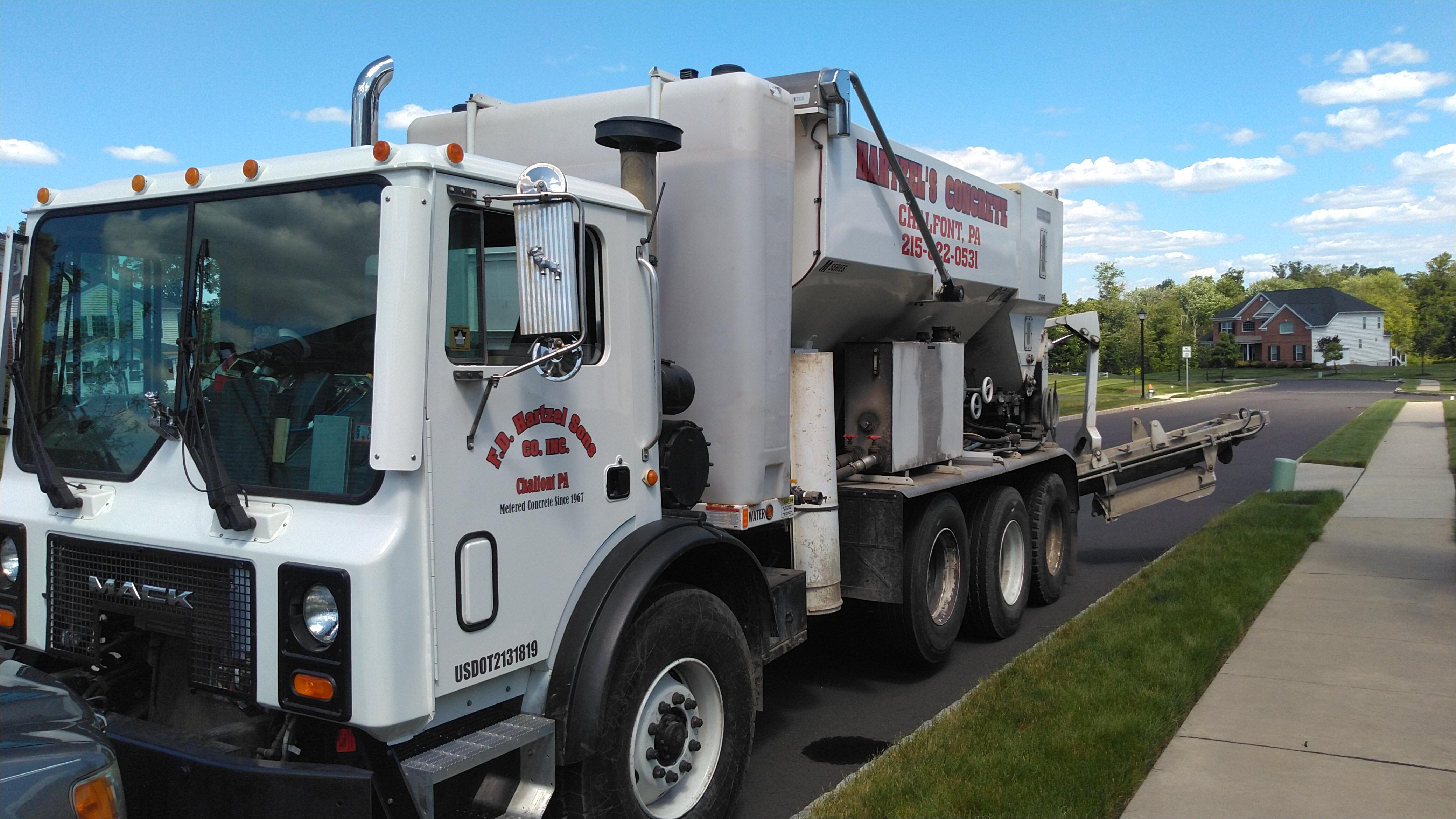

Welcome to the MR688 club! I bought a 2003 MR688S with the AI350 almost 3 years ago and I love it! Except for the ride. It is rough on your back on highways. Tires likely aren't rated for more than 60mph, I had one come apart when I was doing 68 mph on my way back to PA from Iowa after getting a new volumetric concrete mixer body put on it. Personally I'd get the truck towed home, I wouldn't drive it. Fuses are all in the center console, there *should* be a decal in there telling which fuse is where, but I'm sure it's missing. Worth it's weight in gold is a flashdrive, Mack part number 23-021. It's available through the Mack eMedia website. I got it through my local Mack Dealer but I had to talk him into the EMedia site so he could see what I was talking about about. Listed as a DVD, it's a program with wiring diagram for every Mack chassis model from like 2001 to 2021. You can use Killem, but that doesn't dissolve the algae. You have some work to do to get clean fuel. You could also have a piece of trash floating around in the tank, getting sucked into the pickup tube occasionally. Active engine codes can be pulled out on the fly by holding the set/decel cruise control switch down for a second while the main on/off cruise rocker is off. It'll blink out a 2 digit code telling you what the fault is. I hope you got the truck for a steal, trash trucks of this vintage are mostly falling apart. We got lucky finding ours with good frame rails at 24,000+ hours and 414,000 miles. We pulled the frame out of ours and separated/sand blasted/painted them to clear up the rust jacking.

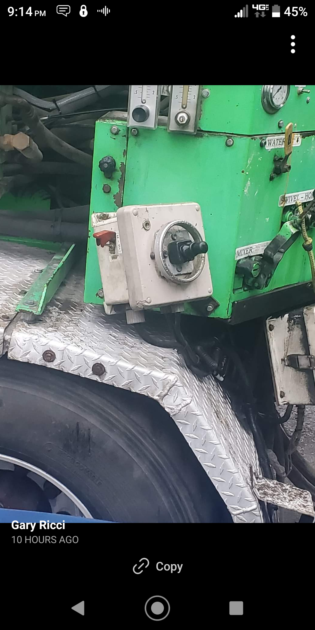

I've recently heard of the setups you mentioned being operated by leaving the truck off in reverse and using a remote starter button to back the truck up to the draw bar. But this system I'm asking about the truck is running so you can operate the mixer while moving the truck around the jobsite just from that joystick on the back.
What's it cost, how's it integrate? How does it hook up to the drive line to move the truck? How's it hook up to the steering?
