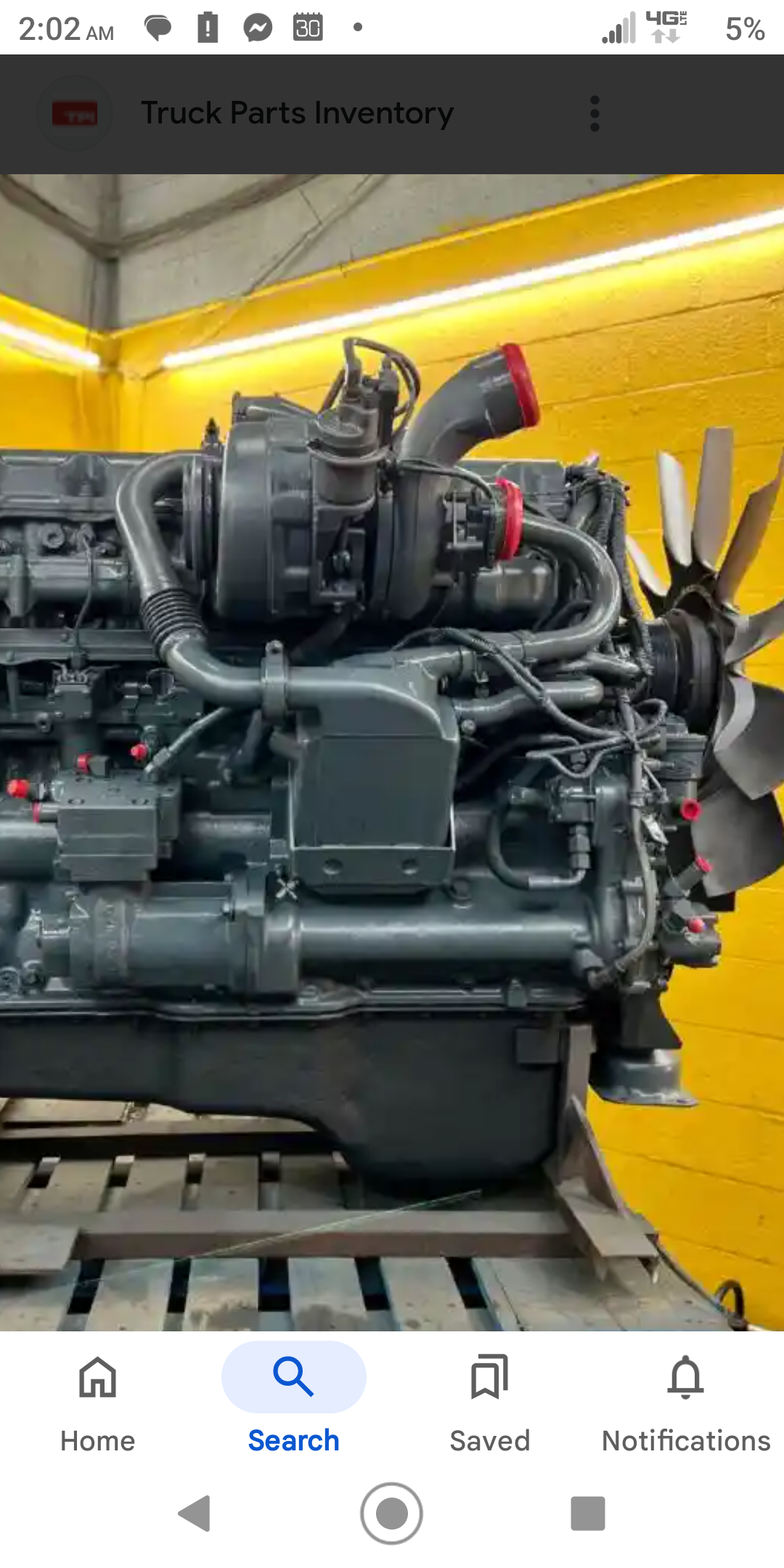

  1. My experience with E7 engines is fantastic longevity, poor torque. My experience with E6 engines (ENDT676 more specifically) is fantastic torque and power. I had a 2001 ETECH 400 in 2015 and it was a dog, but it got where it was going. 1995 E7-350 we currently have is pretty good, but it doesn't have the torque to pull through hills. Same as my 2003 AI-350. They get up hills, but they don't get to the top very fast. Reality is modern trucks have 20+ years of tech advancements and 2-3 extra liters of displacement. This engine won't match that.
  2. Is anyone other than you driving the truck? If so don't do it. If it's just you, just go easy on the truck, and let us know. Watch your EGT's 1025 is max measured about 6" after the turbo. Joey is right though, this is only a 12 liter engine. 460 is the highest the factory tuned them. I know with the 11 liter E6 engines Mack tuned them right to the sweet spot of full power potential and still retain longevity. And those were 300-350hp. No reason to think Mack left their E7 engines with that much untapped power potential.
