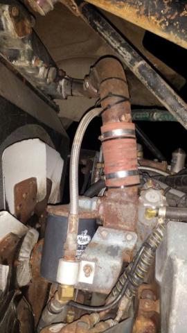

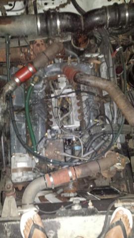

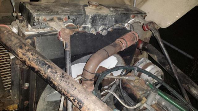

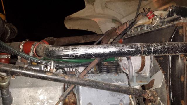

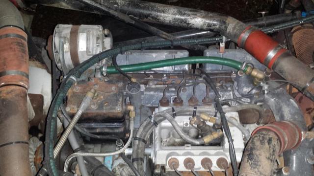

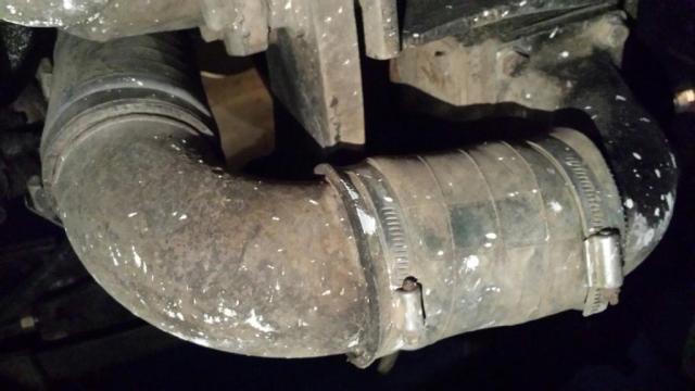

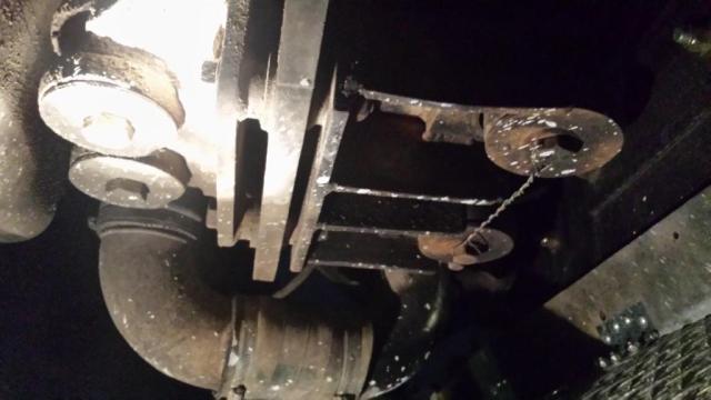

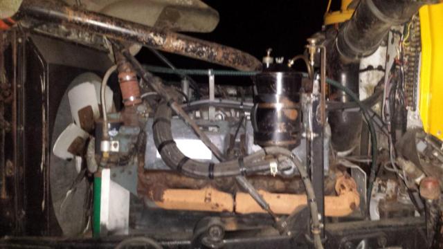

the front mount will have to be made ,you will have to fit 1/2 in spacers on the g/box mounts to raise the engine ,the e9 is the same physical size as the 866/865 just 866 exhaust manifolds sweep up and e9 drop down ,they will touch on chassis rails. I use the same radiator [1100 sq in] you will have to make a new outlet in the bottom tank , the bonnet will have to be moved forward to fit the intercooler. the photos are of one done before. the second lot of photos are the 700 I'm building now
