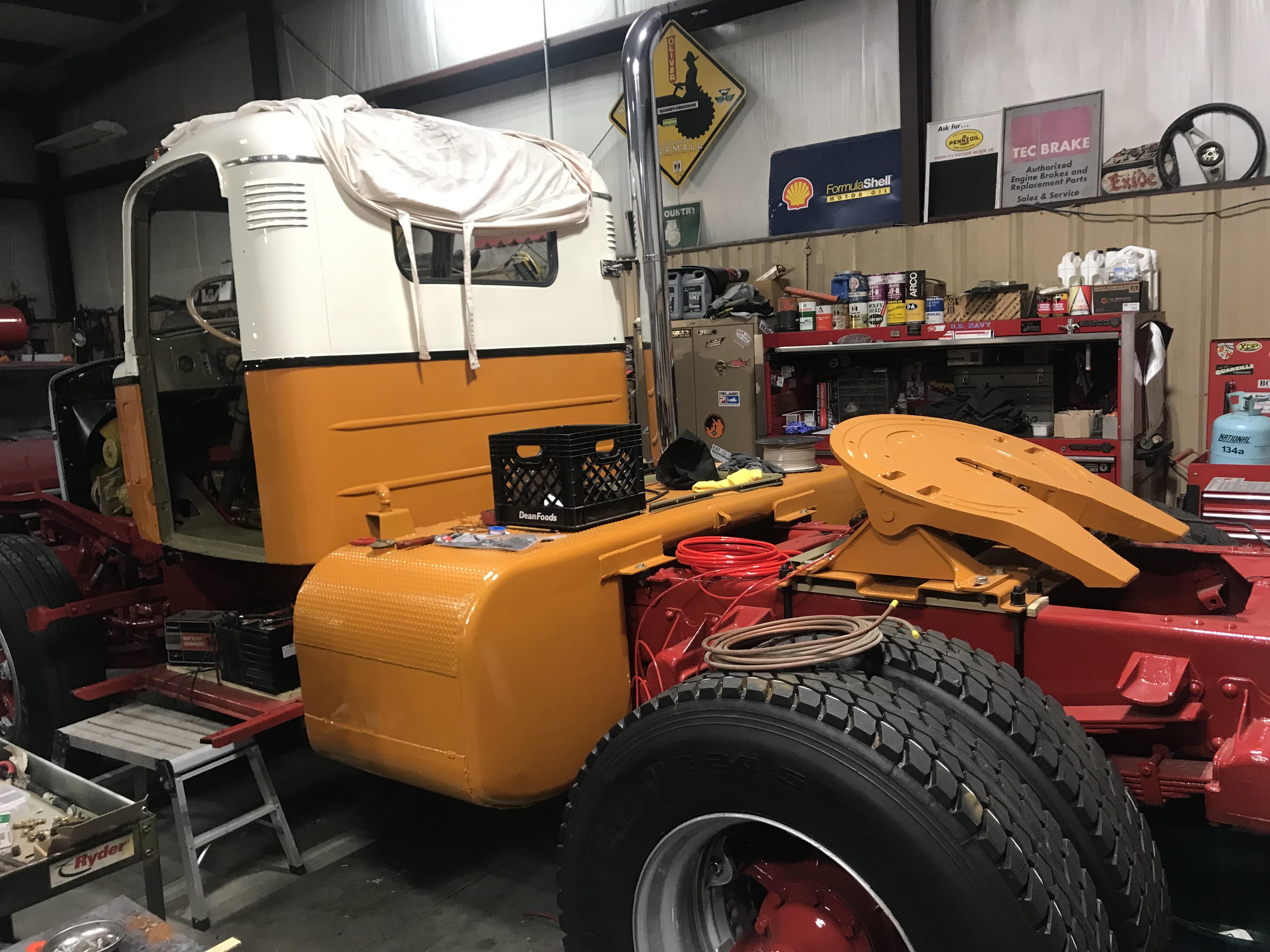

I would like to thank everyone for the support and comments during the restoration of my Coca Cola LJ , it’s pretty much done except for maybe some rear fenders,, My goal at 66; years old was to relax for a bit, finish repairs on my shop from the flood damage and enjoy some truck and car shows. But with the encouragement of my 10 year old Grandson ( And some friends that know what a Freedom Mack is) I’m going to try to restore Our 87 Freedom. Probably not to the extent that I did the LJ , but hopefully it will make a nice truck to pull a lowboy if I want to haul the LJ ,LTH or C Model to a show. I actually bought this truck about 10 years ago to use, not really knowing what a Freedom was. And I have used it, I’ve had it to every Dam in Western North Carolina on the TVA system, I bought it because I needed a day cab for the rough places. I have talked to a couple people who have Freedoms , I have read some old posts on here about them, If anyone has any information I would appreciate it, I would love to know how many are left. This truck has had the hood replaced with a aftermarket hood and repainted a lighter grey ,my goal is to get it back to the original color and decals. thanks again for all the support.
