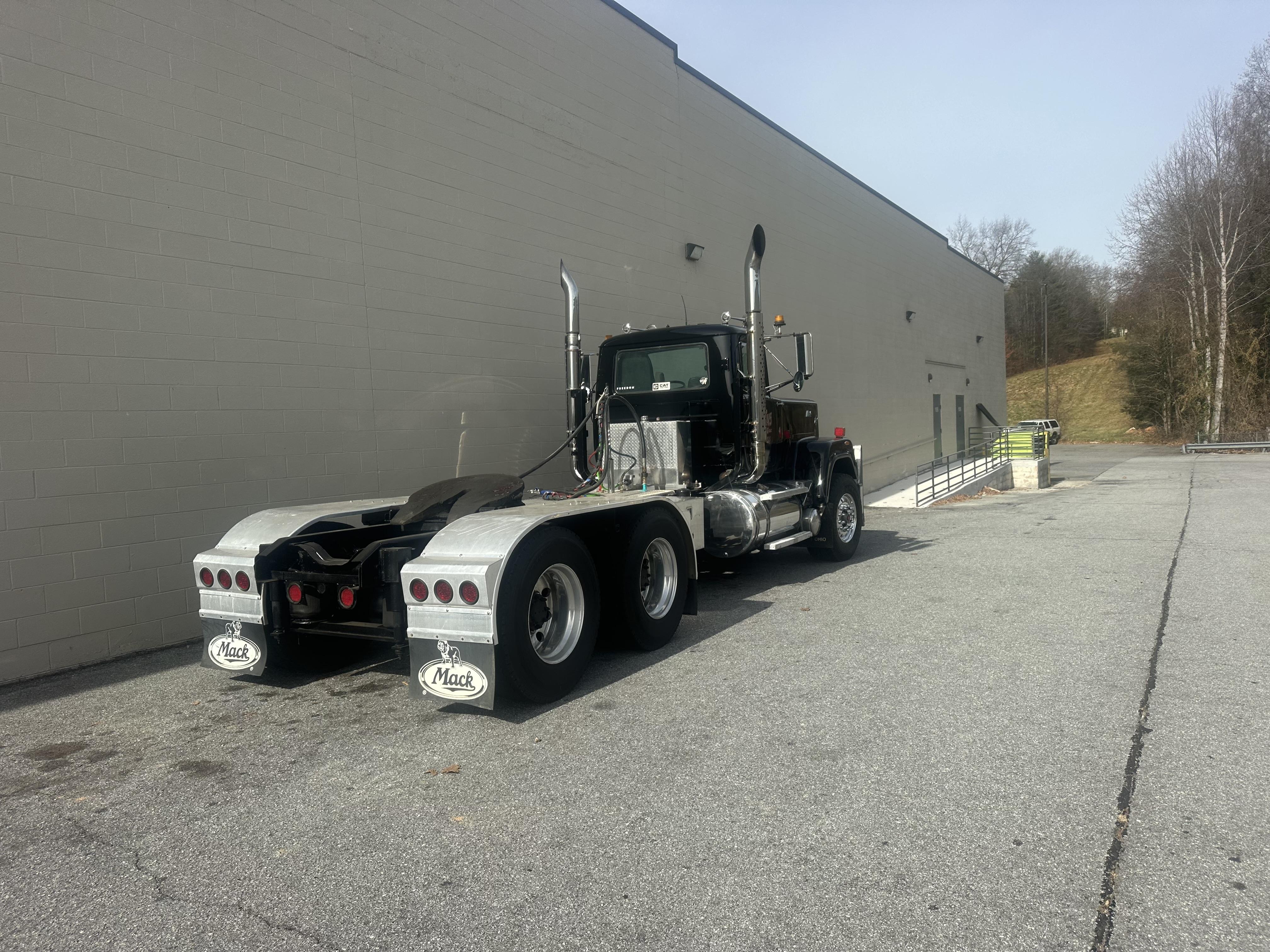

The small yellow button is to keep the PTO from accidentally being engaged, the lever towards the back of the cab is to let the fluid flow to the trailer,, the Landoll has a 2 line system, Engage the PTO , Move rear lever like you would raise a dump,, but leave it in that position, then work the controls on the outside of the trailer. It has a big “ Dump Pump “ on it , I could use a small box pump for the Landoll, but it’s already all hooked up. -

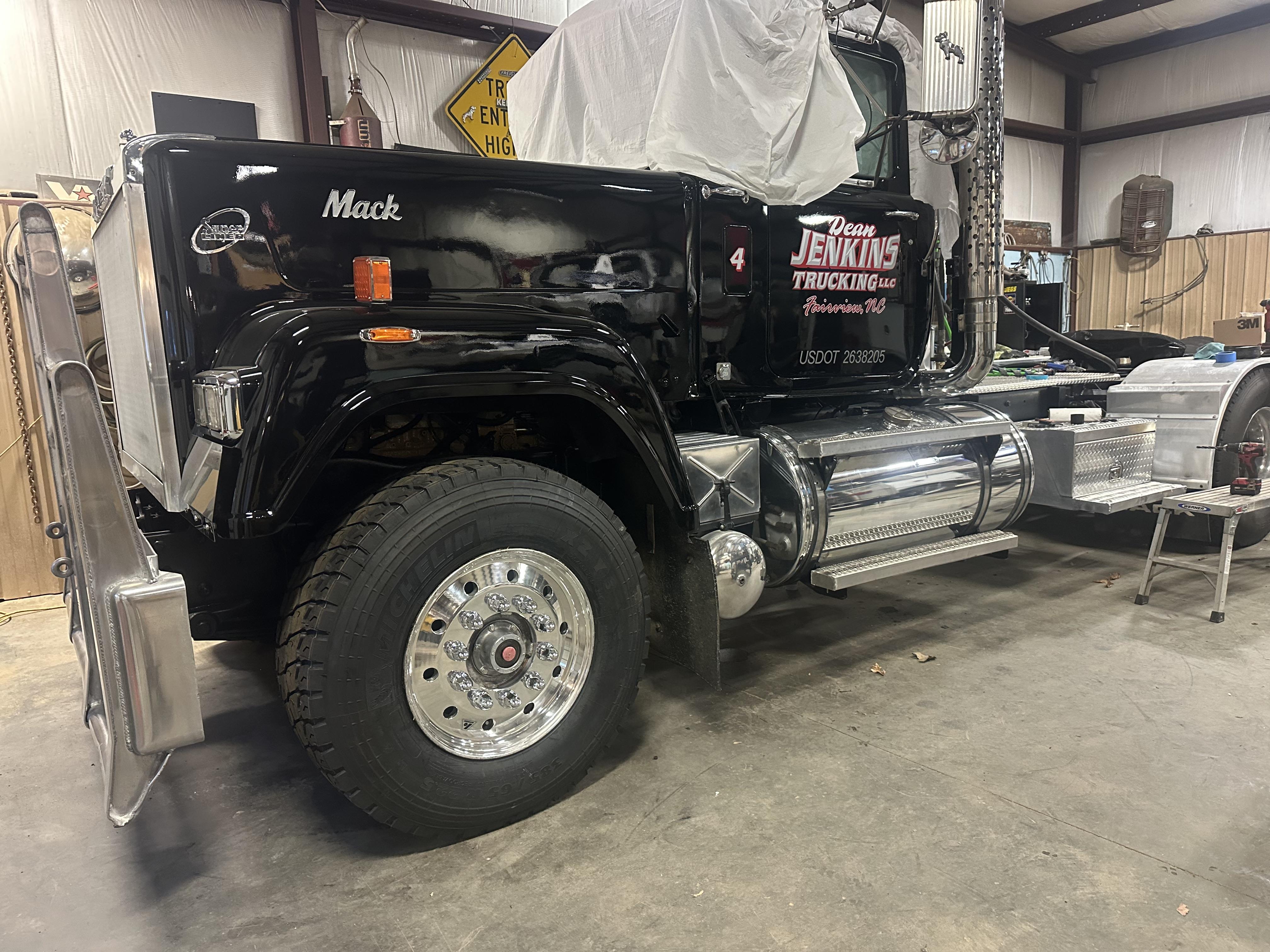

Your exactly right, if I had it to do over I would have taken more time prepping the hood and cab before I painted it,, it started as a axle replacement just to get it back to where I could use it, trying to get it done quicker so I could work on the Freedom Superliner. I probably would have stripped the paint completely off and started with a good epoxy primer,, as it is I just hit the bad spots with primer,, washed it with Ajax , taped and painted. At least it won’t hurt so much if it gets some tree limb scratches . -

This truck was set up for a dump trailer when we got it , the little lever with the push button is to engage the pto ( it locks in position, push the small button to release) the other is to raise and lower the trailer.) Went down today and watched some friends of ours run the Big Rigs on a dirt track. -

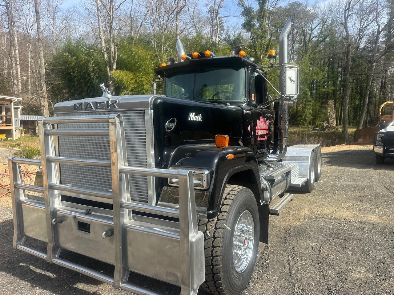

Raining,cold day here in WNC . Got the shop warm and spent most of the day tying up some loose ends on the Superliner, it had a 15 speed Eaton from the factory when we got it , it started making a noise so we replaced it with a 18 speed Eaton a few years back, I changed the Decal just to look complete, installed and wired up a “ Easy Jake “ ( I have these on a few of my trucks) changed the shift knob , added some fog lights that I had laying around for years,, Just basically playing around with it. -
