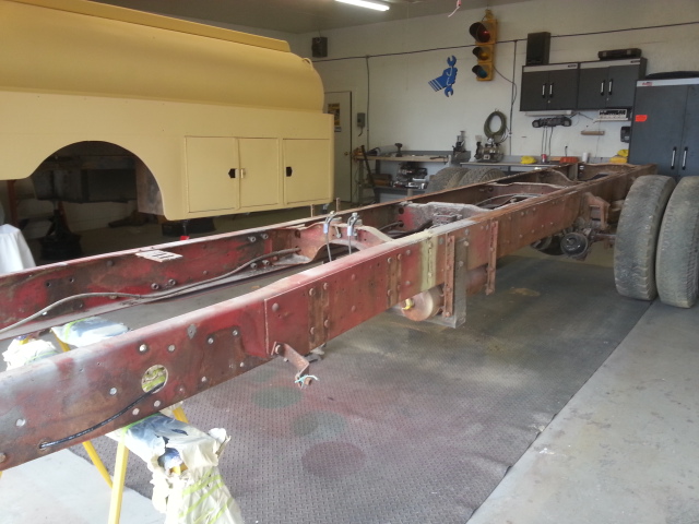

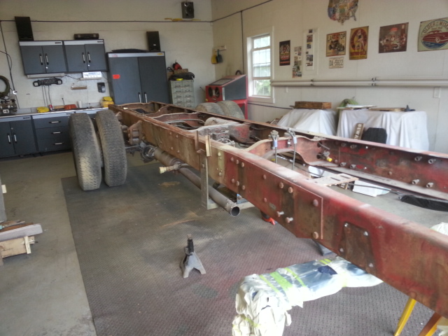

  3. The frame is actually pretty clean. Surpringly though considering it came from Pennsylvania. The tops of the fish plates are pushed out about 1/8 inch at the very top though. It seems to have been well maintained in it's lifetime judging by the 25 pounds of dried grease all over the back half of the frame. And the many newer replacement parts on it.

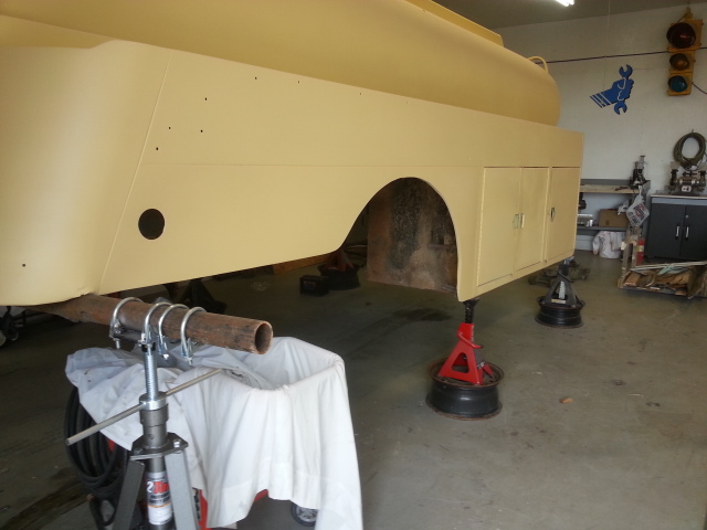

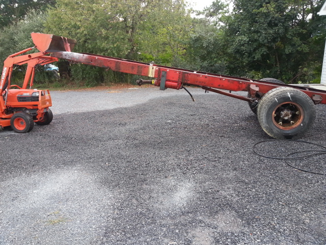

  4. Finally got the tank separated from the frame. It's resting on four 6 ton jack stands and two 2 ton screw jacks. Now the frame is stripped down and ready to start the cleaning process to remove nearly 60 years of crud and grease. I took the tractor and raised the front as high as I could get it to pressure wash the underside as well as the top and everything else I could reach. Next will be preping for paint after all the parts are gone through, cleaned and rebuilt as needed.

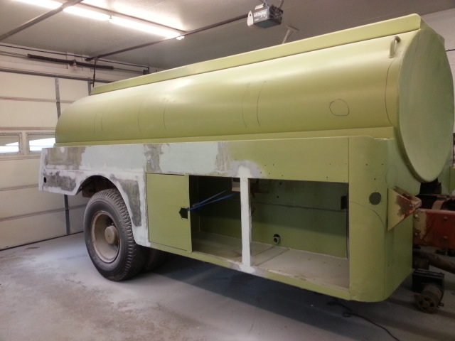

  10. This round of priming took a gallon and a half. Once I finish block sanding it with 180 paper I'll put another few coats after that in prep for blocking with 400 paper. So after all is said and done I will have used 3 gallons or so. That doesn't include any of the rest of the body. I haven't touched those parts yet.
  11. Finally got all the filler work done and several coats of urethane primer. There are still some areas that need a little more work. I see a WHOLE LOT of block sanding in my future. 😲 Next major undertaking is to get the tank off and start on the frame. 😨

  21. Got all the paint stripped off and sanded to clean bare metal. Applied two coats of a lovely colored etching primer and now the fun begins.....BODYWORK! Every evening when I'm done it looks likea ccocaine factory blew up. White dust everywhere.
