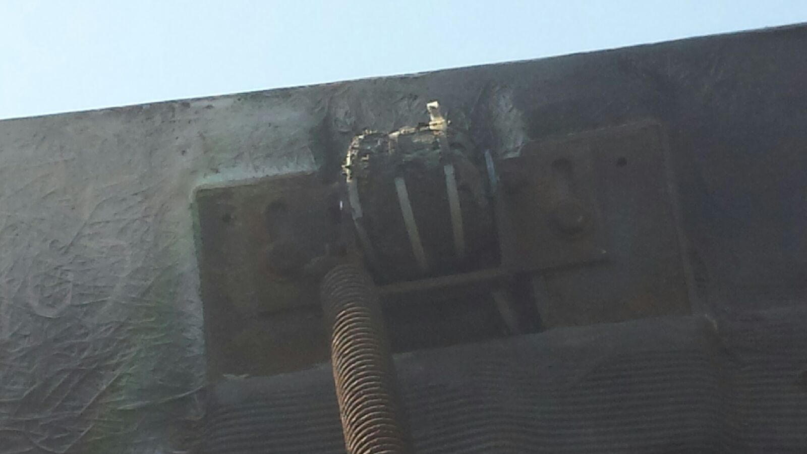

  10. Looks the same as what's on my superliner I rebuild both back in February because the driver's side decided to rip because the bottom was gone and being hidden by part of a mudflap. Think I spent 30 bucks in steel and paint and a day welding

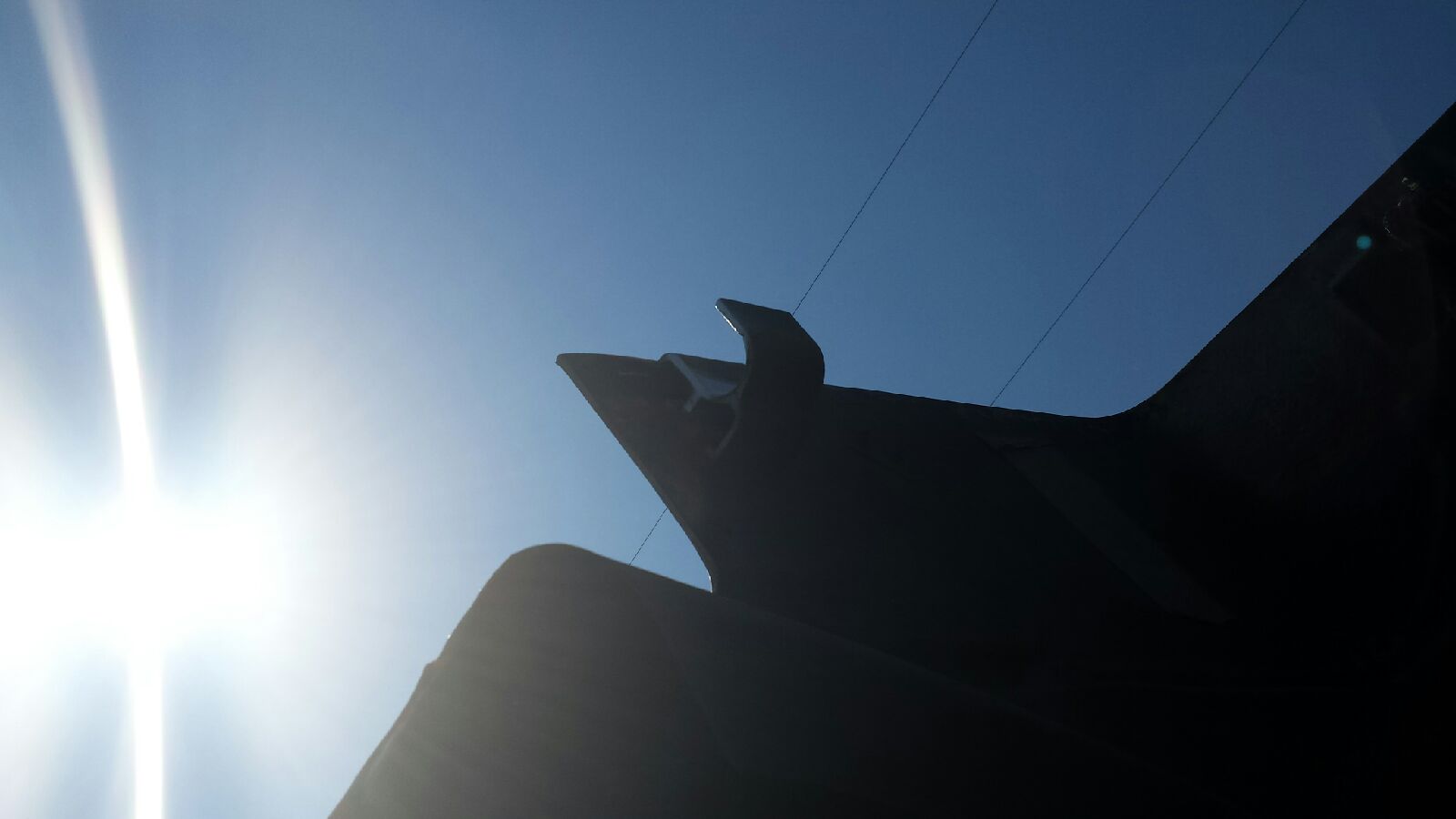

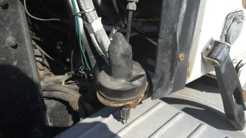

  15. The 1st one is what I really need the round one I would like alone with the aluminum part the goes with the 1st picture. I'm missing one and what I made cut into the rubber before I adjusted them after I installed new hinges Sorry about the pictures the sun is out today which is a 1st this week for the most part

  17. Wondering if anyone has the part numbers handy for the guides and other rubber parts for a superliner hood thanks
