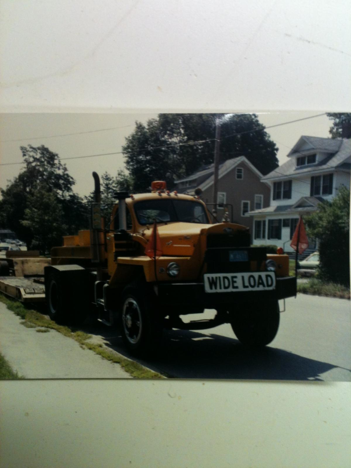

  6. Here is a picture I took in the mid 80's of the City of Worcesters B 80X and Schertzer lo bed , there was a time from the late 70's to the early 80's that it never moved from where it was parked at the DPW yard. FW
