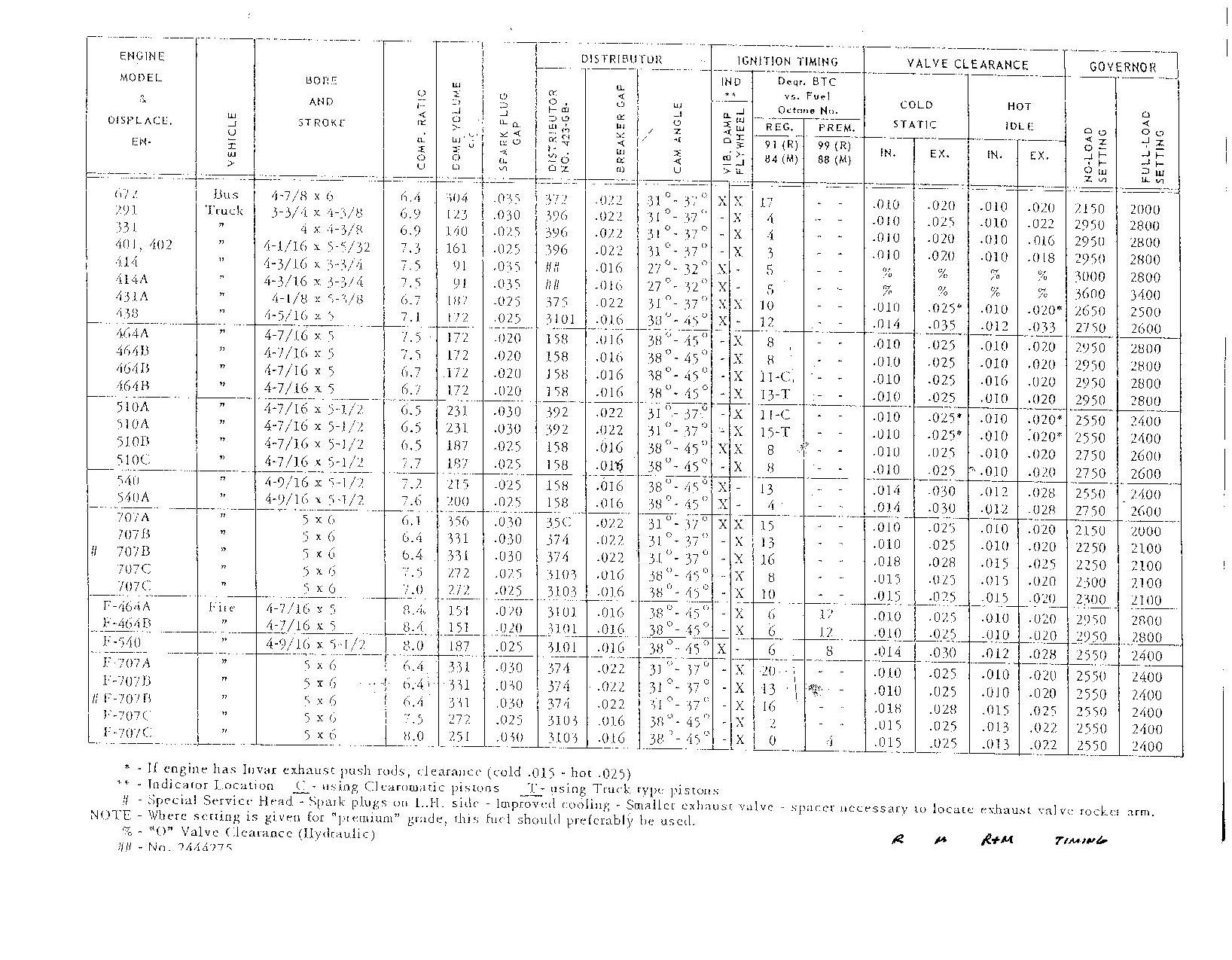

  3. Roscoe, Here is the tuneup spec sheet, once you get the parts it has all of your tune up info. Firemack

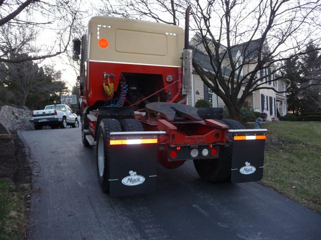

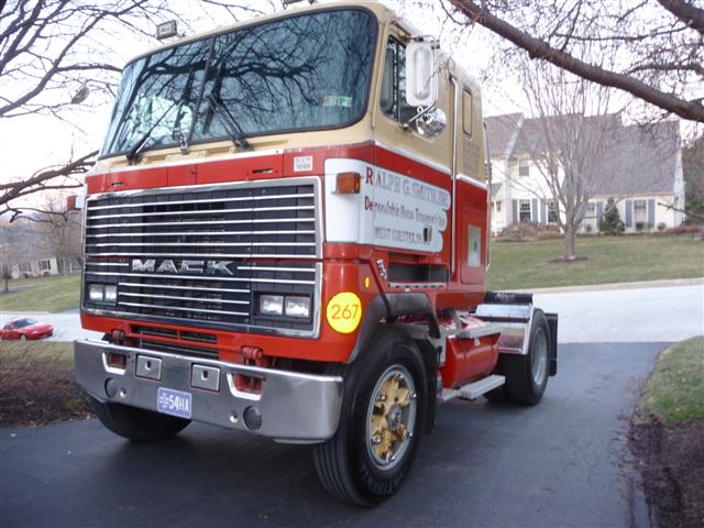

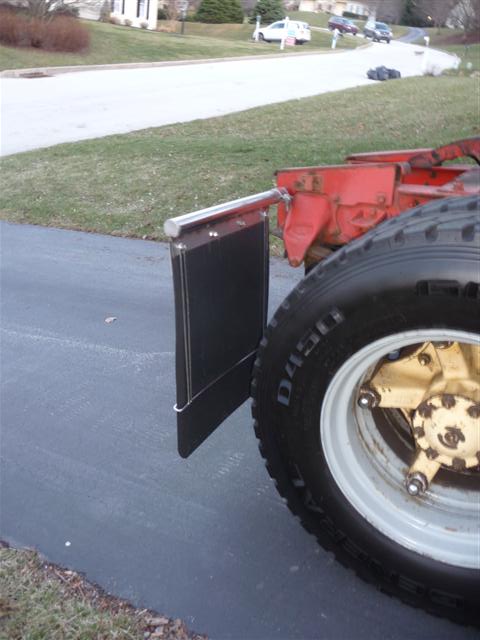

  17. I decided the first thing to get fixed was to add real mudflaps to the MH 612- time to get rid of the wired on 2X2 board and nailed on old mudflaps. I never liked the stock-cheap square iron mud flap hangers. Since this is a single axle tractor there isn't really any room on the frame after the spring hangers to add the typical spring loaded mudflap hangers, so I looked at the quarter fenders and used that mounting idea. Bought a Mack stub mount, and bought a SS tube for the quarter fenders, then welded a 2" ss tab to the bottom of the tube and had a 3" ss tab made for the front to sandwich the mudflap between the ss tab on the tube and the 3" tab. I then added the reflective tape and anti sail hangers. The only thing left is- should I add SS weights at the bottom? It looks good and matched the quarter fender mount nicely, and looks clean. I also added the ss lug nut covers makes it looks a little brighter. Still working on adding the hub cap to the rear hubs- got to adjust the axle nuts and point them in the right direction. These were on the truck when it was hauling horses, and should dress up the Dayton wheels. I need to get the trailer set up next and test it out with the B75 on the lowboy.
  18. Working on this MH 612 to get it in shape to haul the B75 Firetruck.
