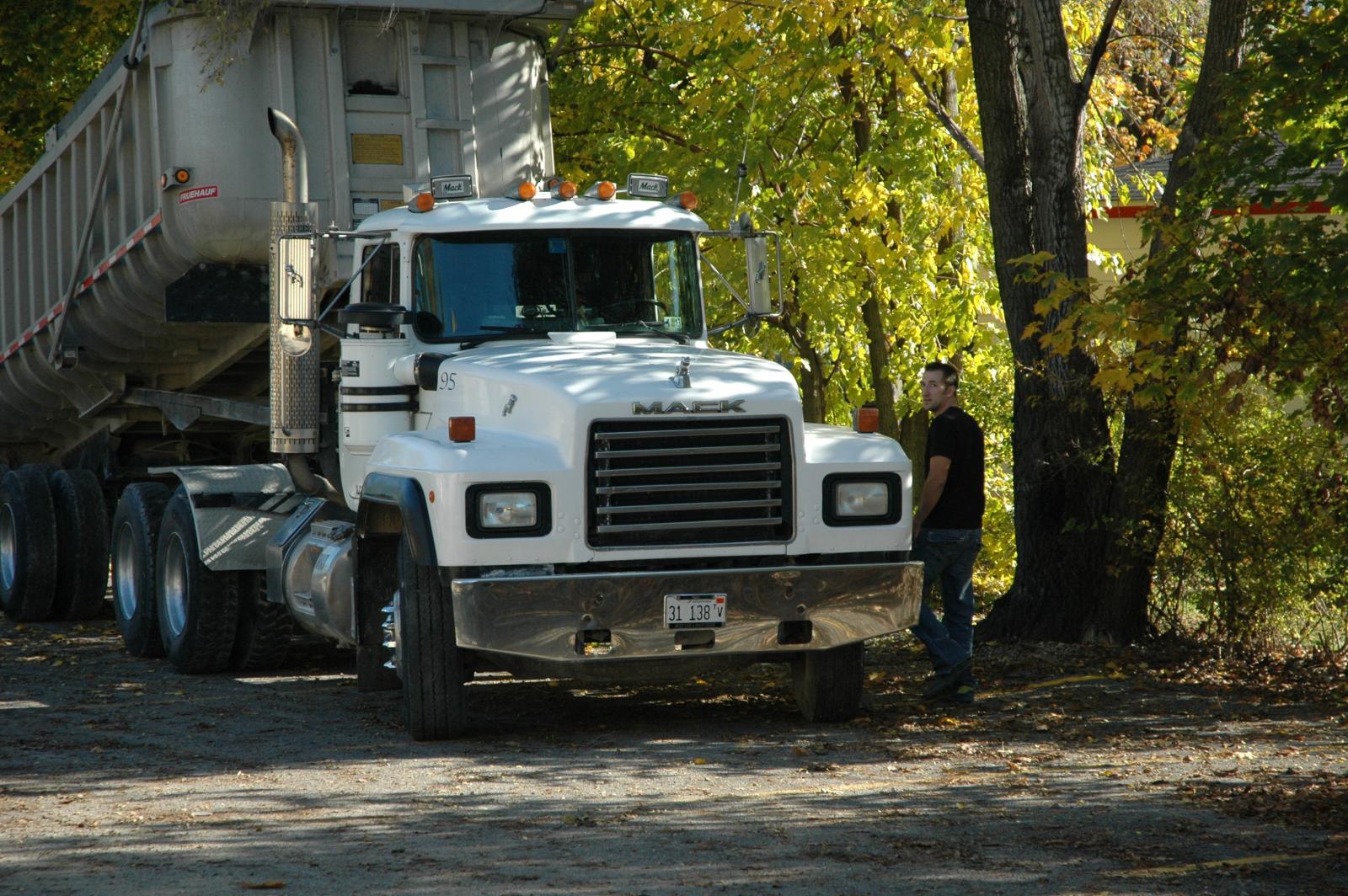

But are there any pictures of it online? I want mine to look more like a western R and tougher but i guess it looks fine already -
Has anyone actually ever replaced the six horizontal looking original grill and put in the grill for the RD from Combs? I will try to post a link http://combscustommf...9183248_std.JPG
I know the superliner hood is not a direct fit to the R model cab and requires a ton of work to make it fit. However, if i have a 95 RD mack with the square headlights and turn signals, can i get a Western style R model hood with the bubble headlights and turn signals to fit? How much work is involved? i like the look of the western style but im determined to have the nicest looking RD style around my area. I know they make a nice style grill for the RD to make it stand out. But could someone answer my original question and let me know if its a waste of time or possibly post a nice picture of an RD for me? im about to put pictures of mine up.
