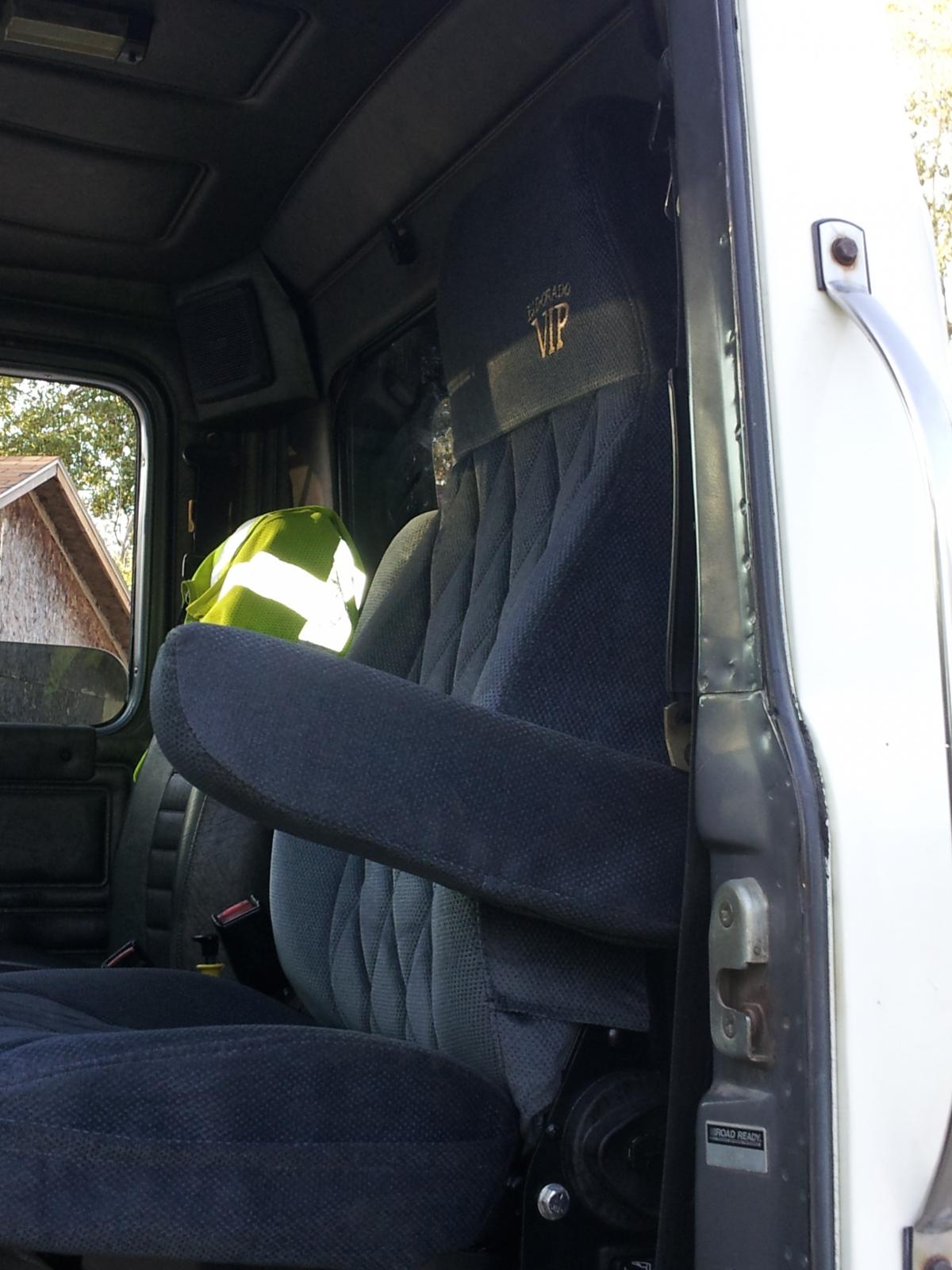

we had both seats, look at my post on the eldorado vip seat and youll see all the headaches i went through to get one. They havent changed much it, just the air switches are on the left (3 of them) the height adjust yellow knob on front and the anti slider knob, just adjust the height all the way to the top then let all the air out of it, then the raise it just enough (prob 1-2 inches so you are still slanted then adjust lumber support and you got a solid R model with air ride cab and best seat in my opinion. Only way i could drive my truck is with this seat -

You have the eldorado seat too? Good seat isnt it? -
