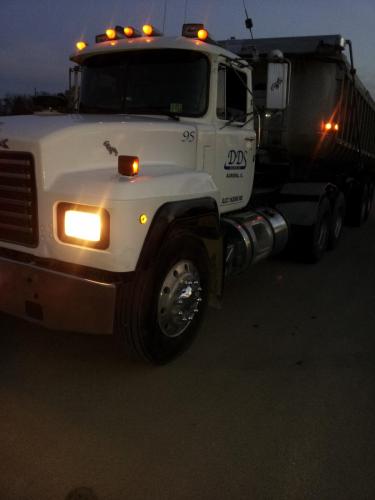

  2. That looks awesome! How much does it cost to do all that? My truck is white and i always that white color that has some cream look to it, you see it mostly at car shows. Is it cheaper to just enhance a white color or do you have to basicallyl start from scratch like it is any new color. I hope i'm not taking away from your post though (jealous)

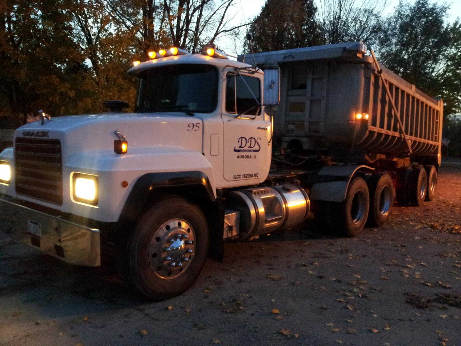

  16. Mike the truck pictured with the western hood was my old truck. Nothing wrong with it. Just decided to try another business and when i got back in, knew i wanted an R and not a CH. Not sure why i didnt want air ride but thats what i chose. The older one had a smaller engine and blew black if i hammered it. I had it perfected to whenever i shifted i would ease into the throttle and then after 3 seconds floor it, and it would get no smoke. It was a 300 horse E6 4V. Redlined at 2300 Current one goes to 1800 and makes 31 psi
  17. Yeah i want that challenge. I like to make mine clean looking with a few touches. Brad i saw yours and I'm not at that caliber yet but i welcome any opinions for help. Heck i still need to swap out the daytons for some aluminums

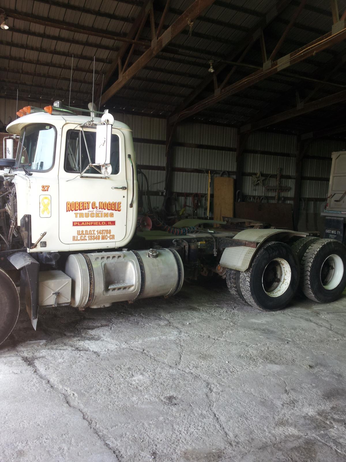

  19. No it was a farmers truck and it sat in his barn for 3 years, which is why i had to do a ton of repairs and maintenance this year but its all good. Here is a pic of when i first got it this july
