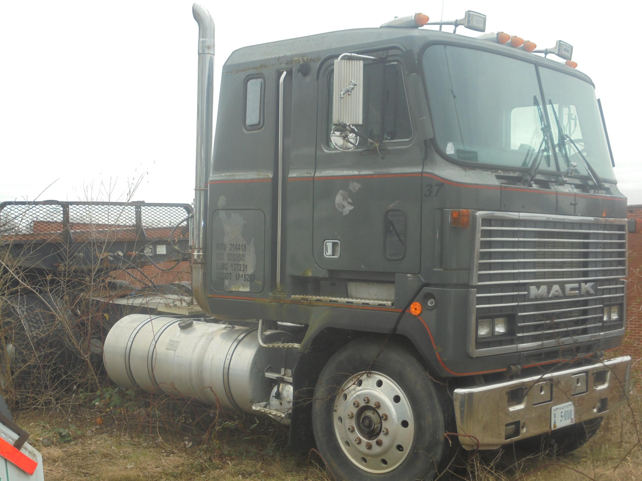

ya id like to have it -

Wow that MH is fantastic.Please tell me someone saved it.... Paul -
