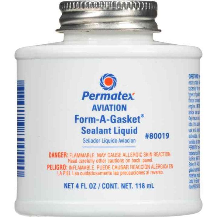

Yep, as the others have said, lift the lid and have a look Hopefully it will be something simple Don't use silicone sealant type of deal when putting it back together Just use gasket goo and some gaskets if needed Silicone types of deal ooze out and break off and end up blocking oil galleries and getting caught in the sliding dogs, then the whole box ends up apart to clean the mess up Good luck Paul
