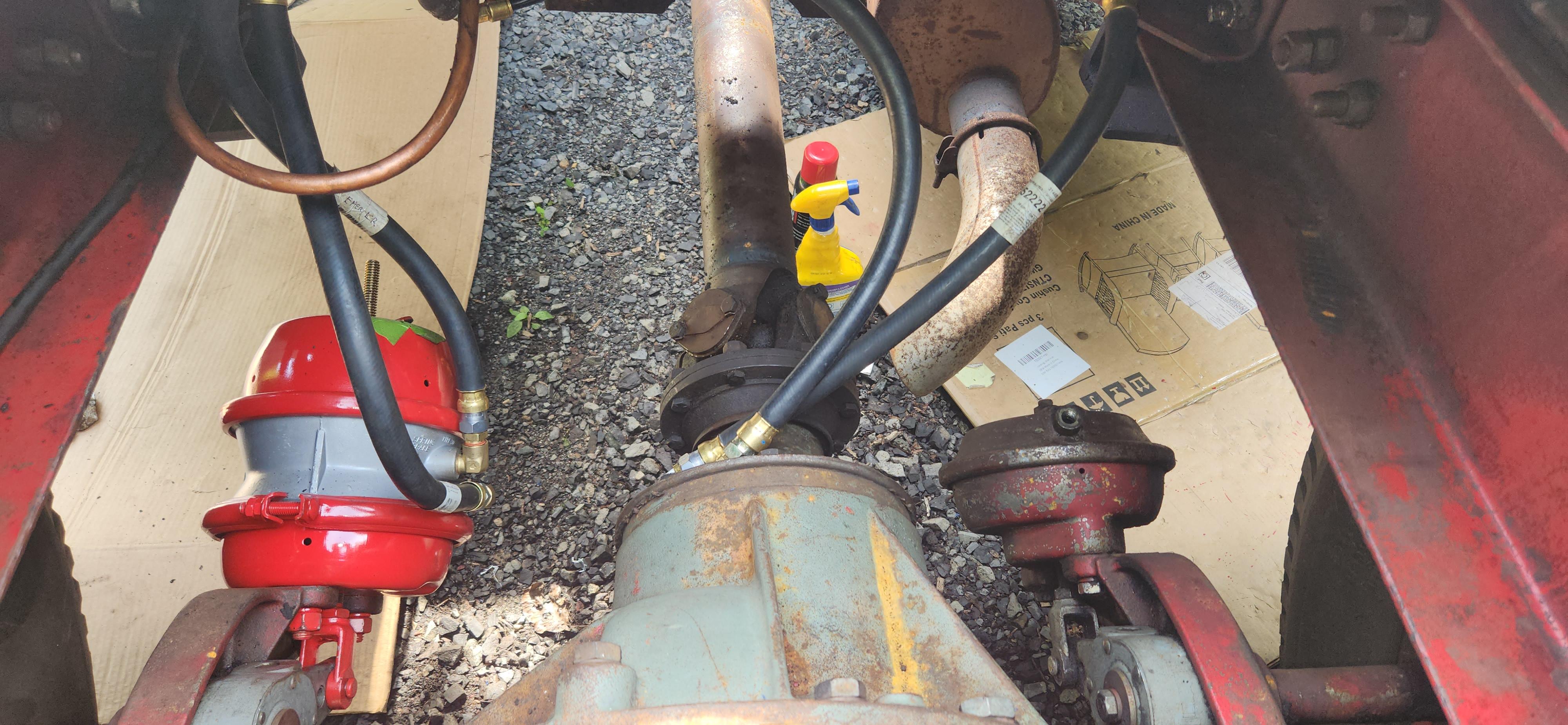

On 3/3/2026 at 2:11 PM, T-Mack1 said:
Attached picture is when we converted to Spring brakes.  Left side is new dual chamber spring brakes,  right side has the single chamber "service only" chamber.    Conversion requires a quick release valve (QRV) and a park brake valve (& knob on dash), plus plumbing work. We used plastic pipe (synflex).
Next,  the way the forum is setup,  you only get so many bytes of upload for free.   I spend the $75 to get unlimited upload.   Makes showing/helping others easier.  It also helps if you are asking for help and want to show a picture.
That does honestly looks good, Mine looks like the one on the right for sure.

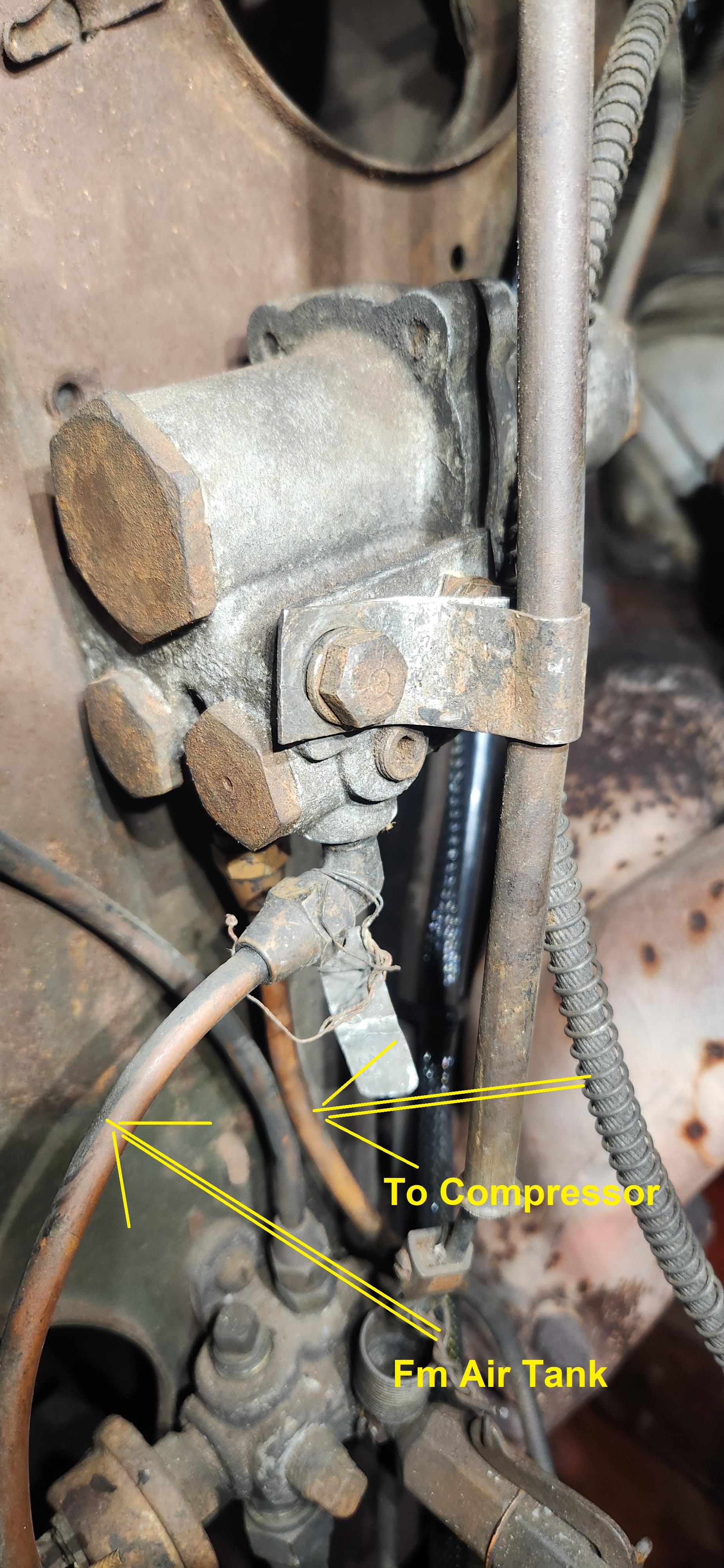

1 hour ago, T-Mack1 said:
Here's a Picture of our compressor "Unloader" (AKA the governor).   It is working and has a range, where it turns off the compressor at 120 psig, and restarts it around 85 psig.  Note: before starting the truck we sprayed some PB-Blaster in all the ports.
Thank you for the picture
https://www.bigmacktrucks.com/topic/76436-55-mack-b61/page/2/#findComment-593067
On 3/15/2026 at 5:18 PM, wayne86 said:
Is there a way you can take a wider picture, as well thank you.
I will when I get back down to the truck. It's at my brother house.    But,  I'm not so sure it would be much help as it's a Firetruck which means a Gasser engine ENF707C  (in 1957 they took less time to warm up and get moving).  Yes, it's a Thermodyne but that just means it sort of shares some features that a diesel has. Similar block.  The Compressor is in the same spot, but in place of the diesel fuel pump, we have ignition distributors (two since it's a firetruck).
https://www.bigmacktrucks.com/topic/76436-55-mack-b61/page/2/#findComment-593132
