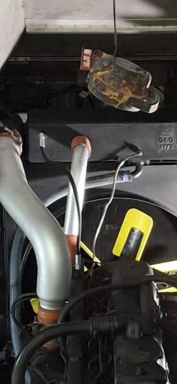

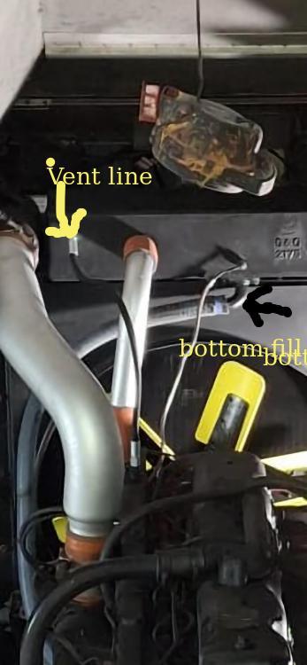

11 minutes ago, mrsmackpaul said:
 if air really got trapped that easily in coolant system then there would be bleeders all over the block and head
Paul
No need for "bleeders" all over the block, because there aren't cavities that can trap air all over the block. Block has opening on top to the heads, heads have opening on top to the upper water rail, upper water rail has a vent to the degassing tank on top of the radiator.
 Yes, we could agree but then we both be wrong, as you say.
https://www.bigmacktrucks.com/topic/75768-300-rebuild/page/30/#findComment-592108
